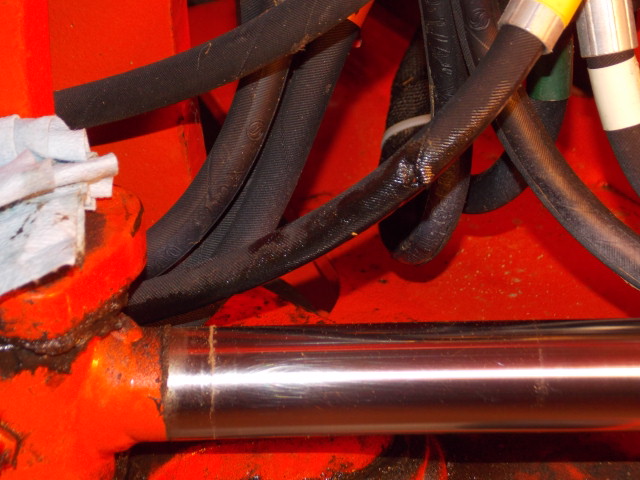

Good luck with the new hoe. When you pick your tractor up after the install, have someone cycle all the controls while you watch the hoses. Make sure none of them rub.
   / Finally, it is at the dealership
Thanks for the tip. Is that at the pivot point of the boom?
   / Finally, it is at the dealership #4
Yes, you can see the black mark to the right of the blue shop rag. That's where it was rubbing.
