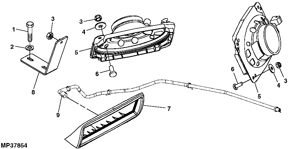

I reinstalled the headliner without any mods sofar as I think I am gonna need the JD kit, but I will compare speakes and see if I keep the Pioneer 4x6 speakers I bought or the JDs - both will fit. One thing though, i looked for the antenna cable that should be installed on the tractor and so far it is not there? The speaker wires and the radio cable and connector are all there, but that antenna cable was not visible. However, next time I look i will remove the top again and then look some more.

The antenna is simply a wire (red) in wire loom. It should come off the back of the radio from a wire that comes out of the radio to what looks like an old style headphone jack. That ussually has a black rubber piece around it. Don't look for anything more than that, there is no metal piece, and it all sits up in the upper plenum by the AC. Its supposed to be routed from the raio up the front center of the cab.

Just realized you were saying that it comes in the kit. I was looking for a factory installed antenna wire, like in cars:(. The antenna wire is Part #MIA10780, I looked it up in the parts catalog. On the pic it is part number 9
