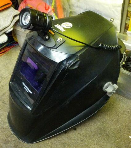

Nothing like a laying a nice bead to make your day.
My "aha" TIG moment was figuring out my depth perception was going to heck by not moving my helmet/head parallel with the work. Something about my eyeglass lens/eye that just don't work well when looking off center. Luckily my near vision is still good enough so simply removing my glasses when TIGing works the best. Tried cheaters/magnifiers with not so good results.
A helmet with a setting that allows the use of some intense work lights was also helpful.
   / Finally got it figured out #5
Found almost same issues with MIG.... Cheater lenses in hood and tilt head over to side to actually see what arc/puddle was doing... So may try to weld with MIG gun or arc rod holder blocking vision...
And AMBIENT lighting...
