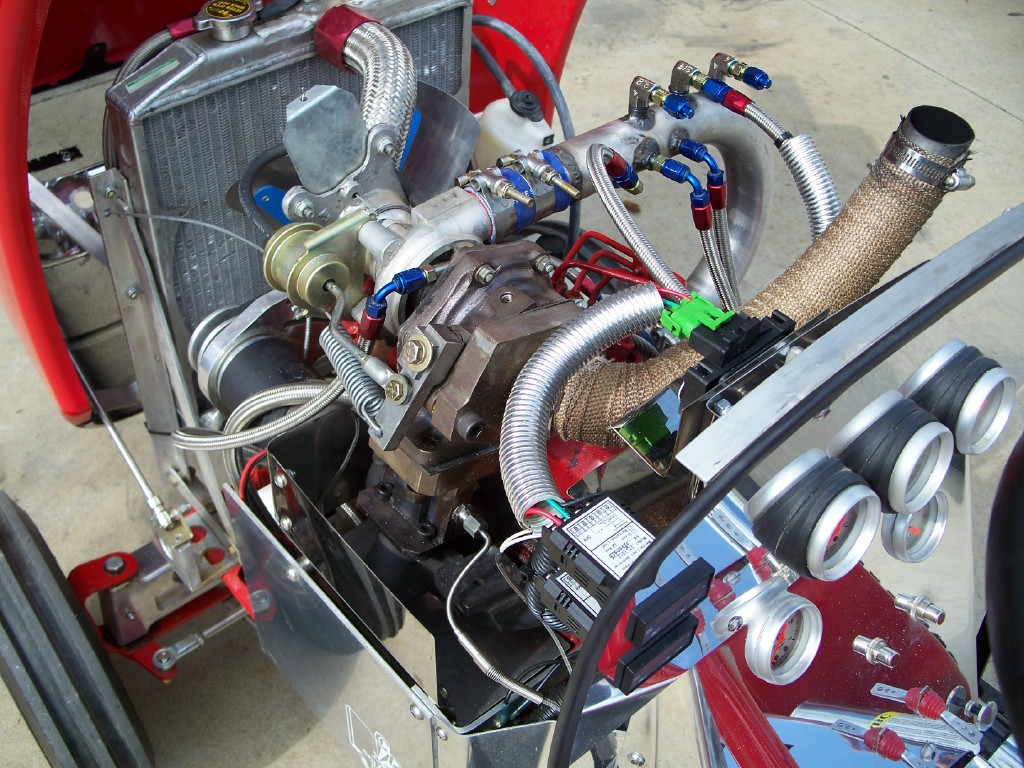

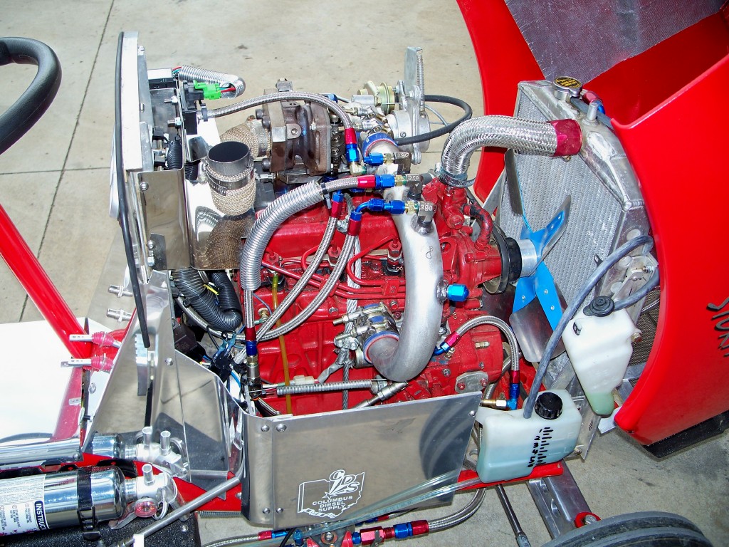

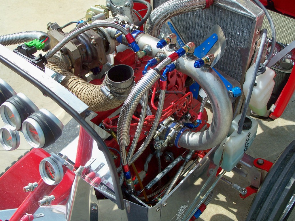

40 hp and having it live isn't too much of an issue. Common sense is the rule. We get over 100 hp out of a 1.12L but that's a different story.

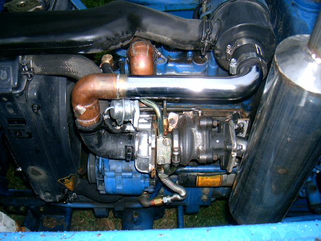

Here is a link to a person that has put together a kit to turbocharge a Rhino small diesel he is using a similar IHI RHB3 turbo that I used on my Ford 1210.
Kubota Rhino Small Turbo RTV1100 Pieces Turbocharger - eBay (item 230379904336 end time Sep-25-09 20:18:14 PDT)
I nearly got 30hp when you do the math converting from PTO hp out of a factory rated 16hp tractor with this size turbo and small fuel pump adjustment. So the 40hp will be easy to get out of the 24hp Yanmar . A similar displacement turbocharged diesel engine from Briggs & Stratton/Daihatsu. Makes 34hp all day long in the surface prep equipment that I build.
Good luck with your project.
Jay
