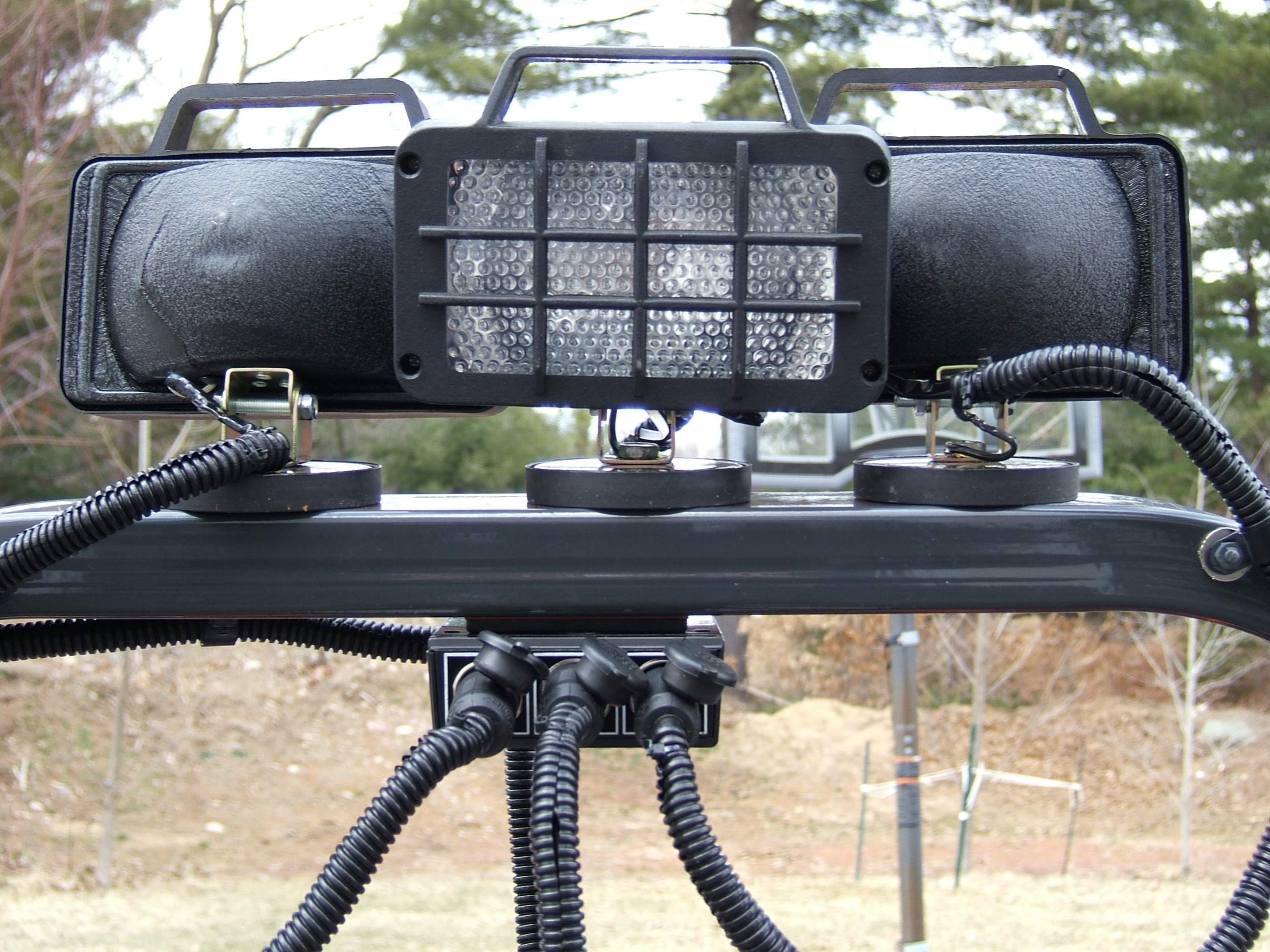

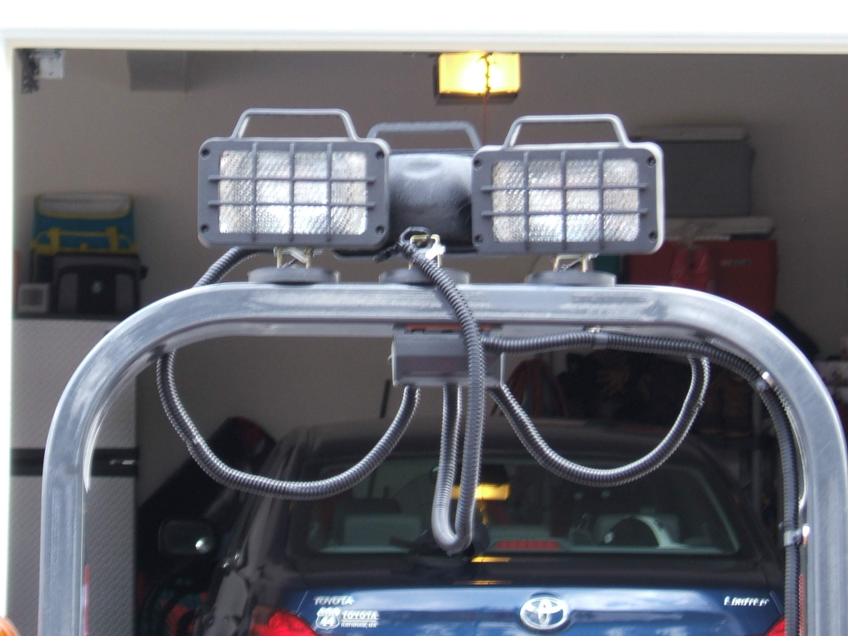

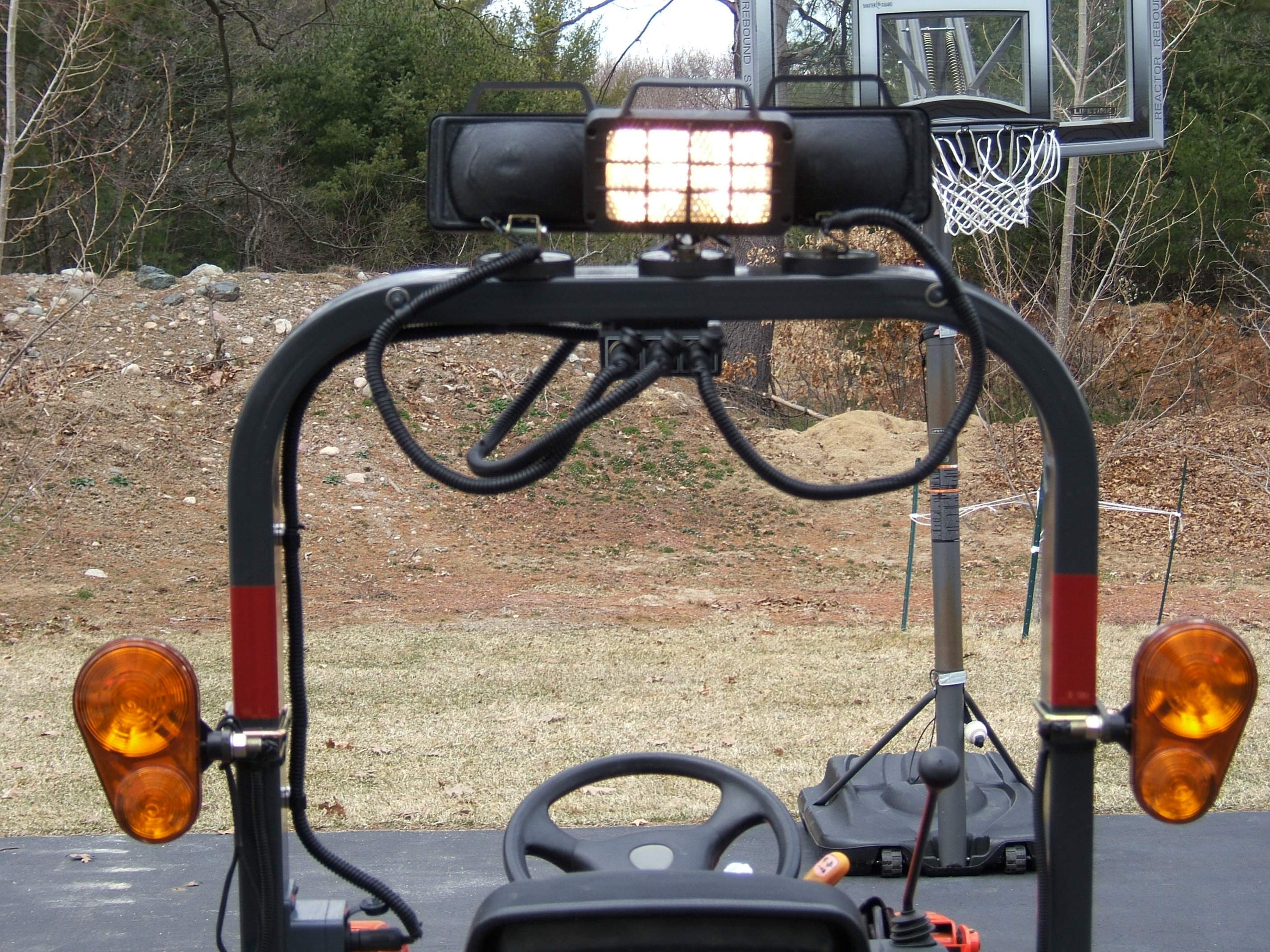

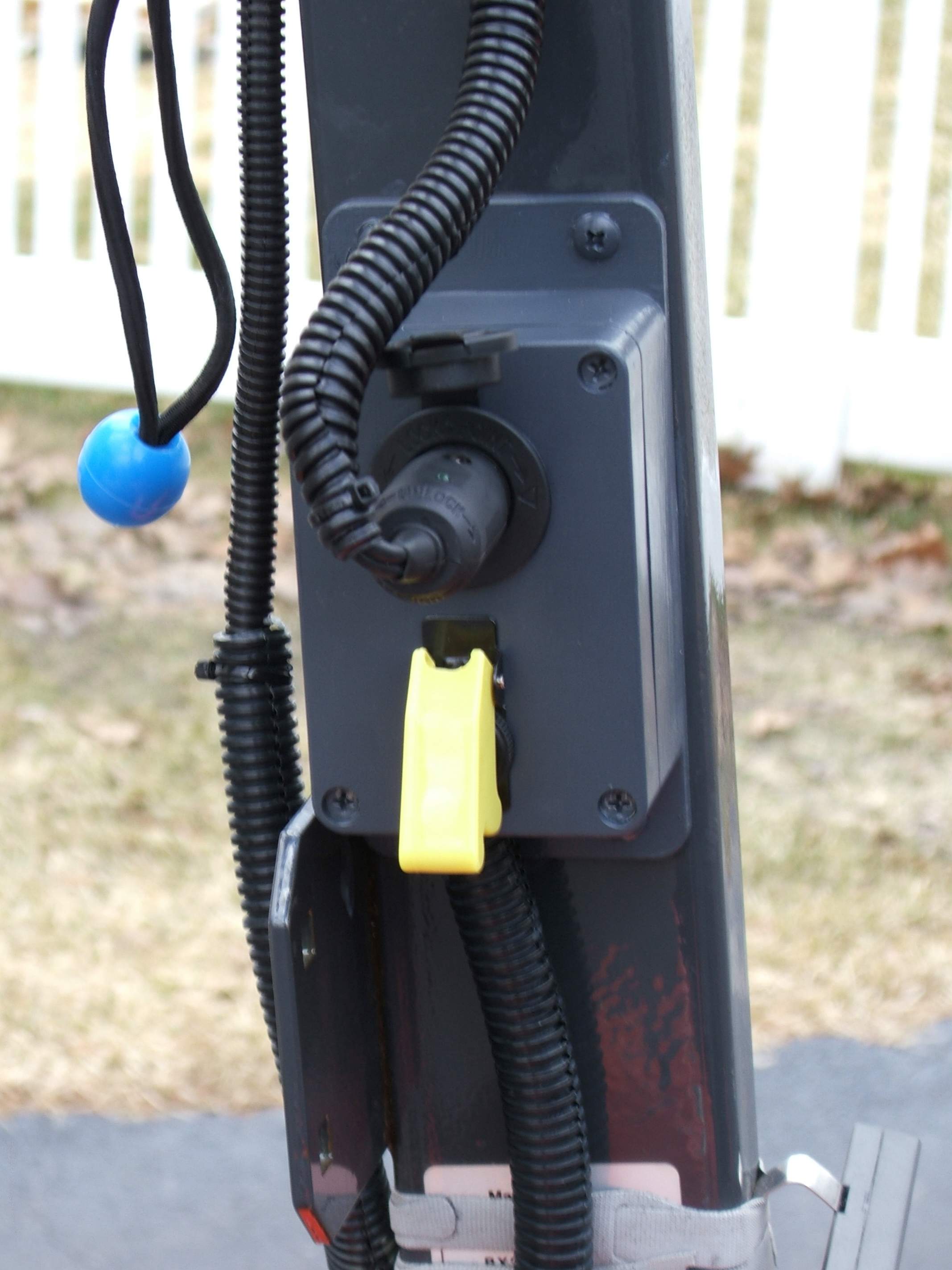

Here is the final result - I wanted front/rear light on separate circuit and to have the lights and ROPS wiring removable.
Magnetic lights, switch, waterproof PVC box, marine 12/2 wire bought from eBay
Replaced lighter plugs and receptacle with PartsExpress version (great quality)
Marine grade, 3-plug receptacle has mounting plate so if can be removed
20amp inline fused circuit direct to battery - sorry, no relay (I'll take the risk)
All ROPS wiring secured with magnets and vinyl bolts/nuts and clamps
Took the ROPS paint mix from another post to Lowes - color match is close enough for me
The only thing I did not consider, and was very surprised about - the amount of vibration in the ROPS at low RPM...need to spread lights out or they rattle together. Yes, I was crusing the property after dark last night :)

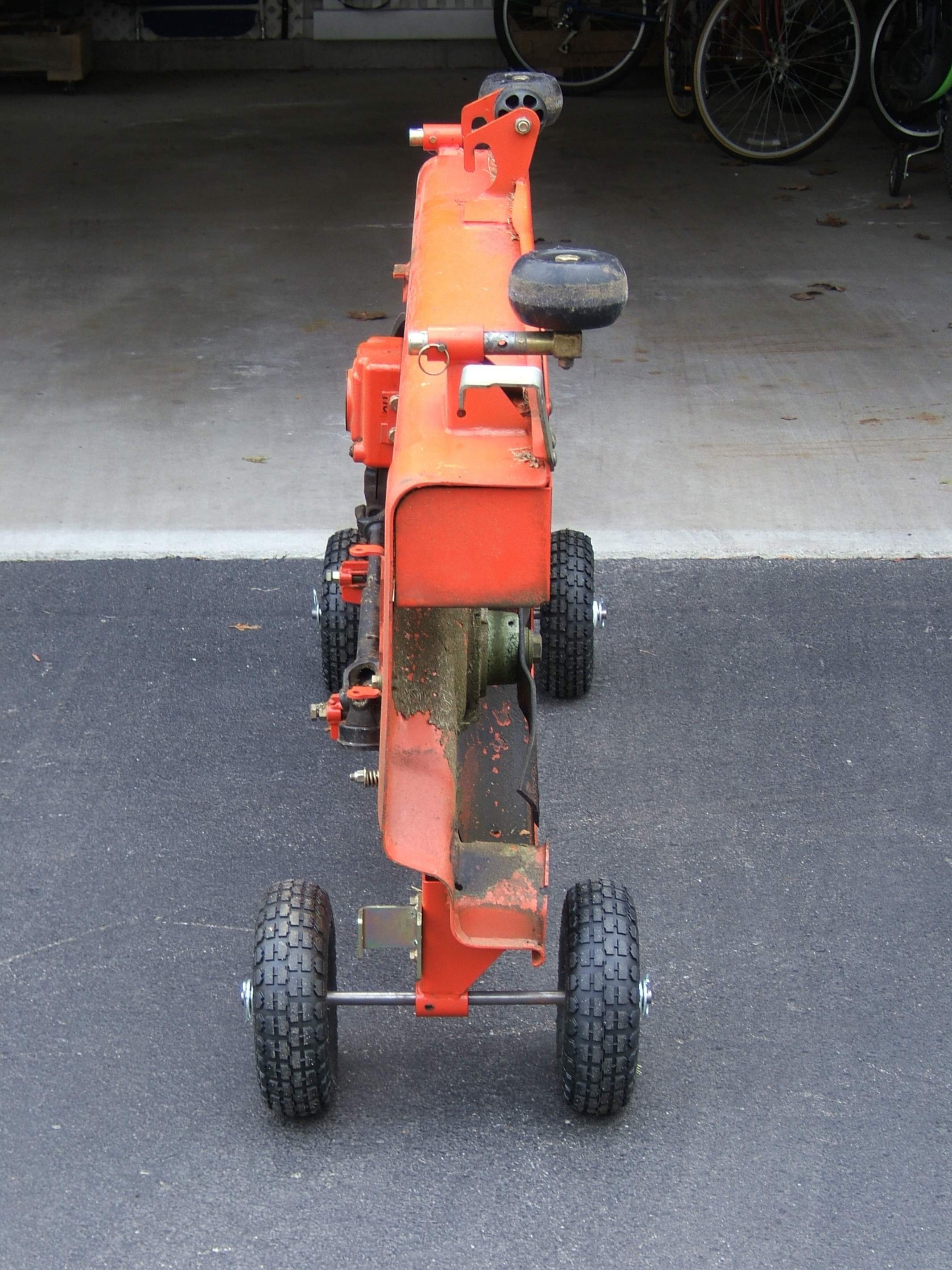

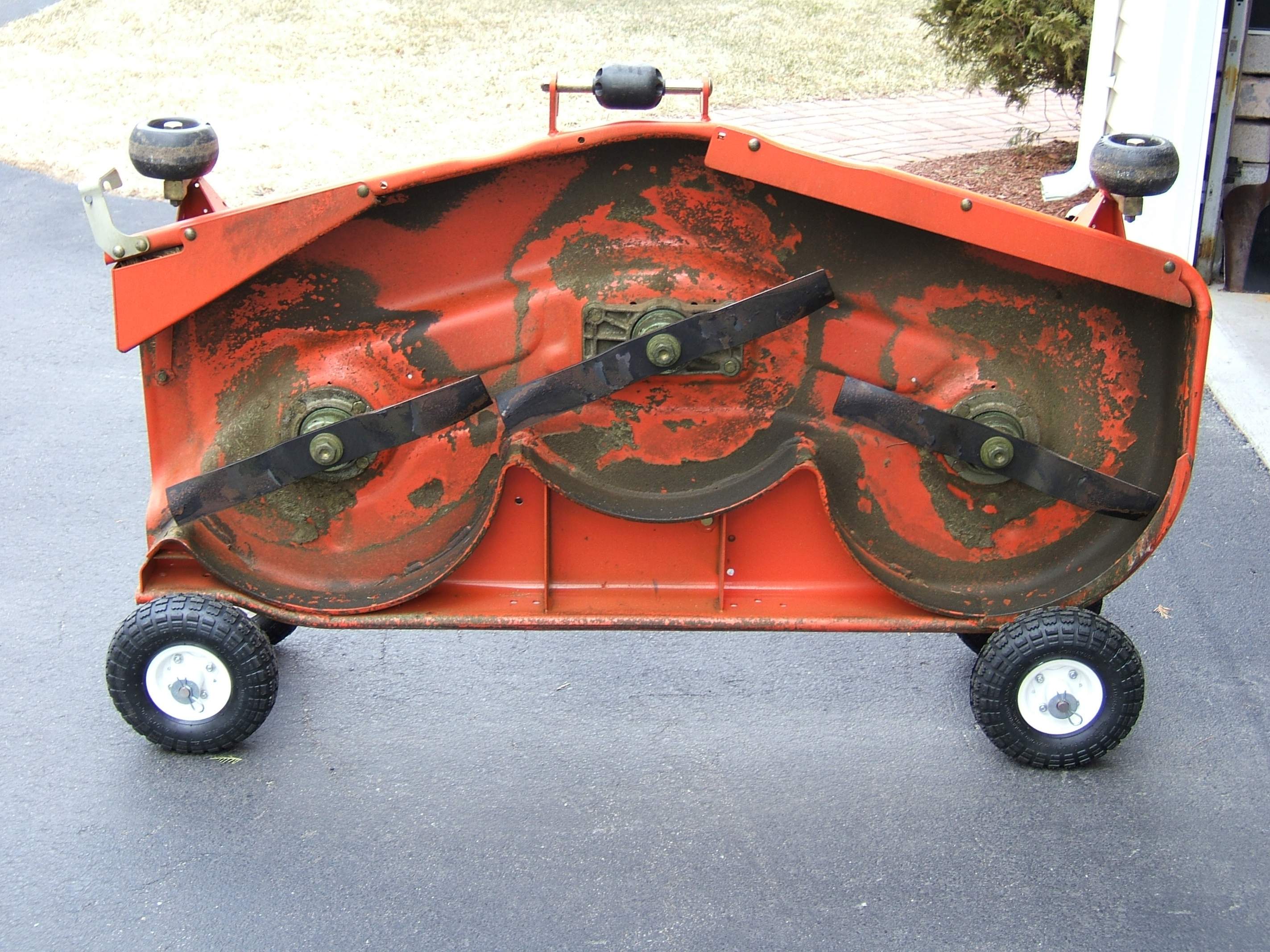

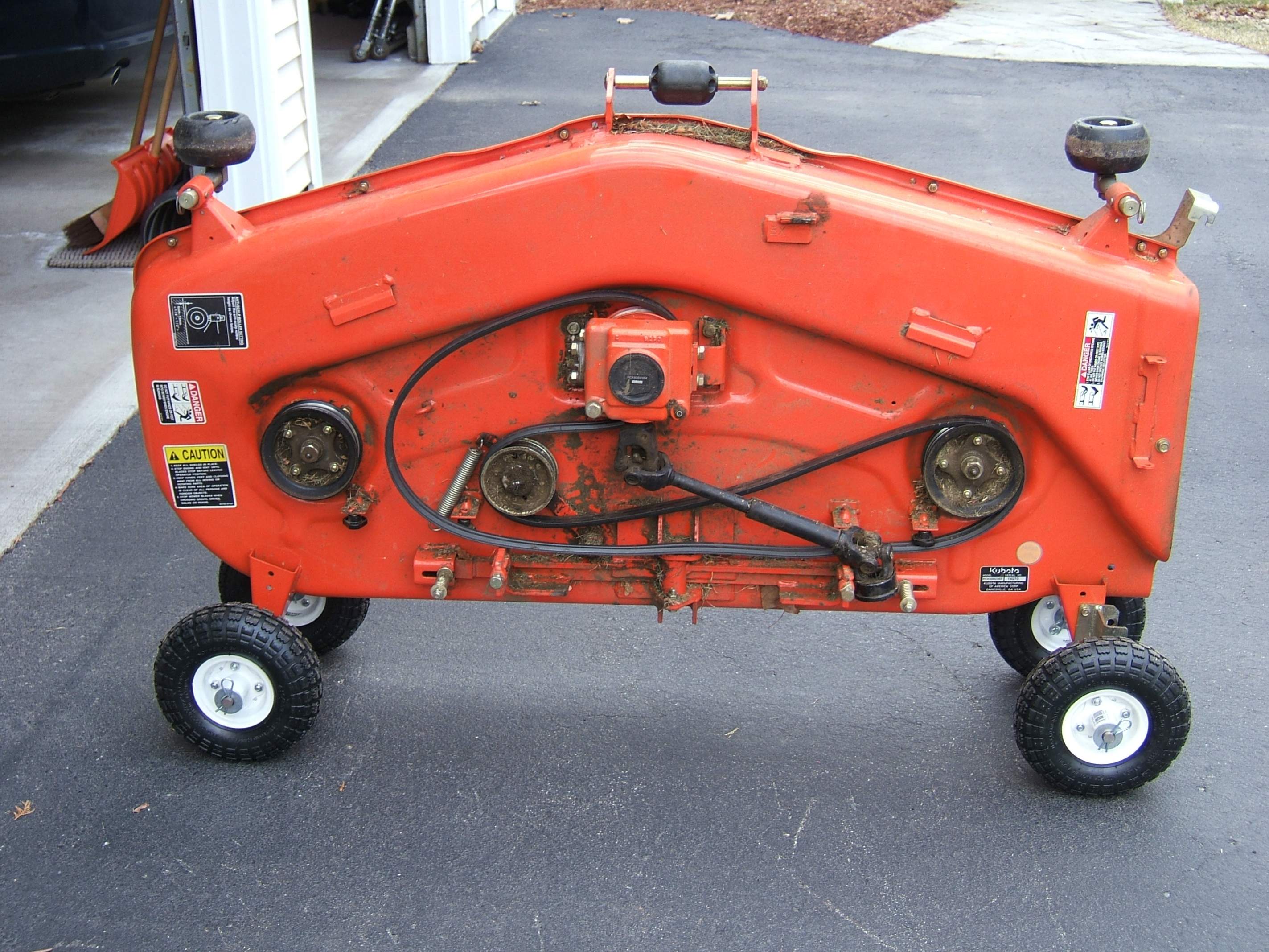

Finished the mowing deck stand too.
Both projects are the result of the many posts I have read - no real creativity on my part.
Enjoy,
Curt

How much did the mower stand project cost ya? They are similar to Larry's but with larger (inflatable) tires and smaller diameter axles.
   / Finally finished the ROPS light project
The wheels were $3.99 at Harbor freight...a few bucks for the washers and cotter pins, I have left over bushings from another project but they were pretty cheap.
Ordered the axles from "All Metals Inc" off the web - if I recall, they were about $20 including shipping - you can get a quote online, I have used them before and had great luck with orders/pricing/product..
So ~$45 gets you close...
Hope that helps...
