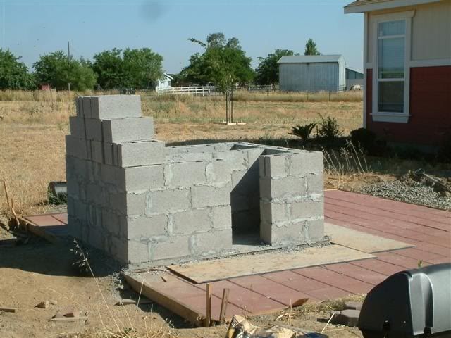

Started the patio last summer
http://i198.photobucket.com/albums/aa85/pma361/Patio-1.jpg
The concrete pad supports the masonry barbeque pit
http://i198.photobucket.com/albums/aa85/pma361/Patio-2.jpg
http://i198.photobucket.com/albums/aa85/pma361/Patio-6.jpg

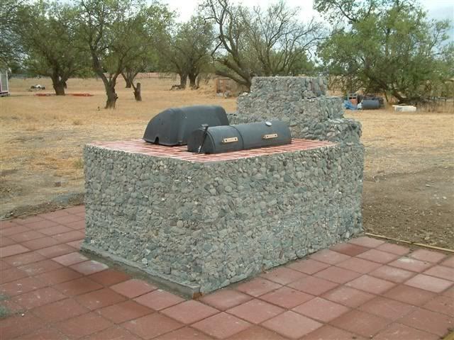

The concrete blocks are faced with drain rock left over from the septic system installation. Used thinset mortar to stick the rock facing to the cinderblocks.
http://i198.photobucket.com/albums/aa85/pma361/Patio-7.jpg
The work surface is covered with countertop tile. The charcoal grill/smoker is in the foreground.

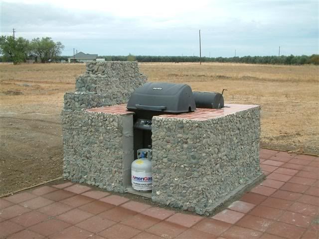

http://i198.photobucket.com/albums/aa85/pma361/Patio-8.jpg
There's a gas grill for fast cooking.

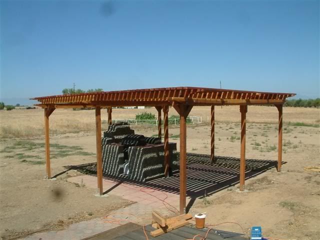

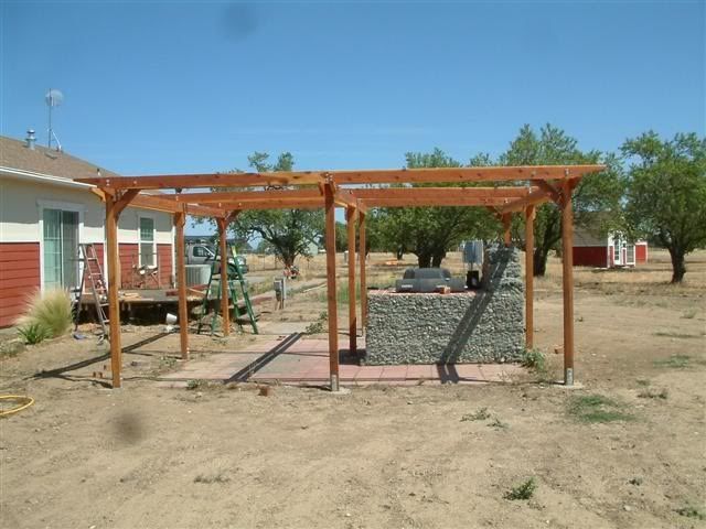

Started the pergola construction last month. The posts are 4x4 redwood and the frame is 2x8 redwood.
http://i198.photobucket.com/albums/aa85/pma361/Pergola-3.jpg

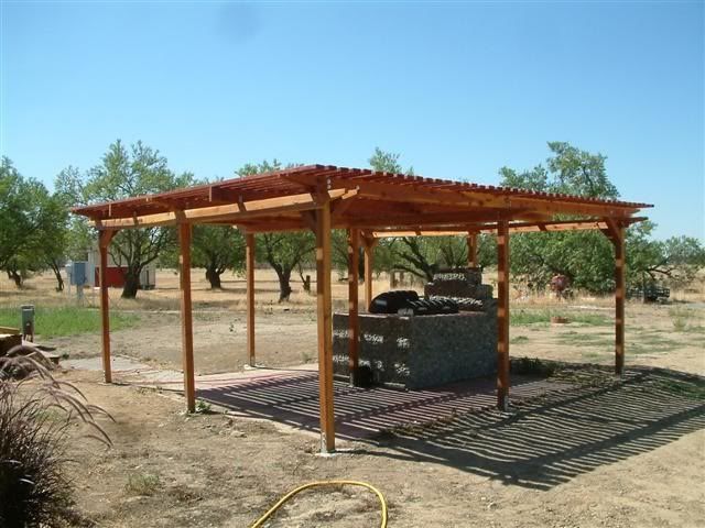

The purlins are 2x4 Douglas fir painted with Behr 502 redwood stain/sealer.
http://i198.photobucket.com/albums/aa85/pma361/Pergola-4.jpg
Got "dappled shade" on the patio now. Don't mind cooking on the patio now when the temp hits triple digits. Will add a misting system to the pergola later.

Looks good! Nice construction... The stone grill looks far more useable than a simple grill top and I like the tile surface. The pergola is very nicely built and stained appropriately for Northern Cal. Are you going to grow a vine or other such plant over it? My wife wants a clematis growing all over ours...

Vines, flowers, etc will attract bees, bugs, drop flower petals, leaves, etc. that might get in your food. Nice looking setup you have there. I have a pergola with wisteria on it, looks nice when its in bloom, bees love it.
