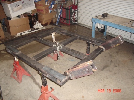

I built this disk with the aid (drawings) of another TBN member MOEMOE, I did have to improvise and added my own custom touch.
Here is the metal laid out.
   / Finally finished Disk Harrow
#2
Chop saw in action.
Chop saw in action.
Frame partially welded up.
More added.
More added.
#9
I think I did good on the alignment with the captured pins.
