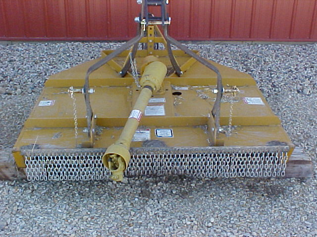

I finally got my chain guard pics taken of the chain guard I welded up for my 5' KK brush cutter. Any questions feel free to email
Check out my website for my new load of Iseki tractors and equipment
Nick

Another view. Made with an angle iron scrap, 50' of 3/16 chain, and wire feed welder. Didn't feel like drilling all of those holes or buying bolts like I saw others do.
My kids loved cutting chain with a big bolt cutter.
Nick

Thanks, Nick... Looks real nice.

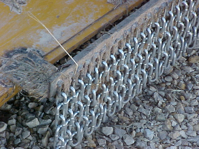

Thats a funny story! I was reading past posts and saw that center chains were shorter. I also read that someone made them the same length as I did and forgot about shorter in the center. Mine took care of themselves after about 5 minutes!
HA HA. Another lesson learned, these little projects are full of them.
Nick
   / Finally chain guard pics #6
<font color=blue>same length as I did and forgot about shorter in the center. Mine took care of themselves after about 5 minutes</font color=blue>
Copied my method on the first one I made, huh?/w3tcompact/icons/wink.gif/w3tcompact/icons/laugh.gif

<font color=blue>Another lesson learned, these little projects are full of them</font color=blue>
Wouldn't be near as much fun and we wouldn't have as much to talk about if everything was perfect the first time. /w3tcompact/icons/smile.gif

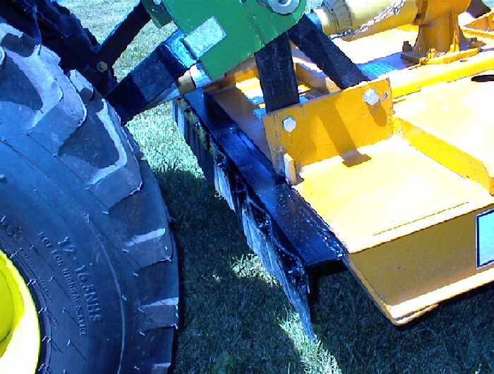

Here is a picture of my setup for a chain/rubber guard on my 4' KK. Works real good and helps keep the dust down also. I used an old piece rubber truck bed mat.
