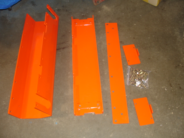

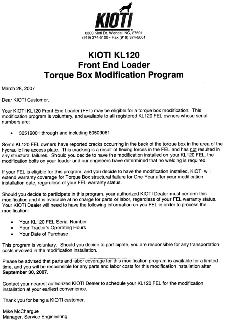

Kind of crude in my opinion but at least it's an effort to rectify the issue/problem . I haven't done anything yet myself (haven't even checked if mine has cracked), but thought I would pass along the info I received.
