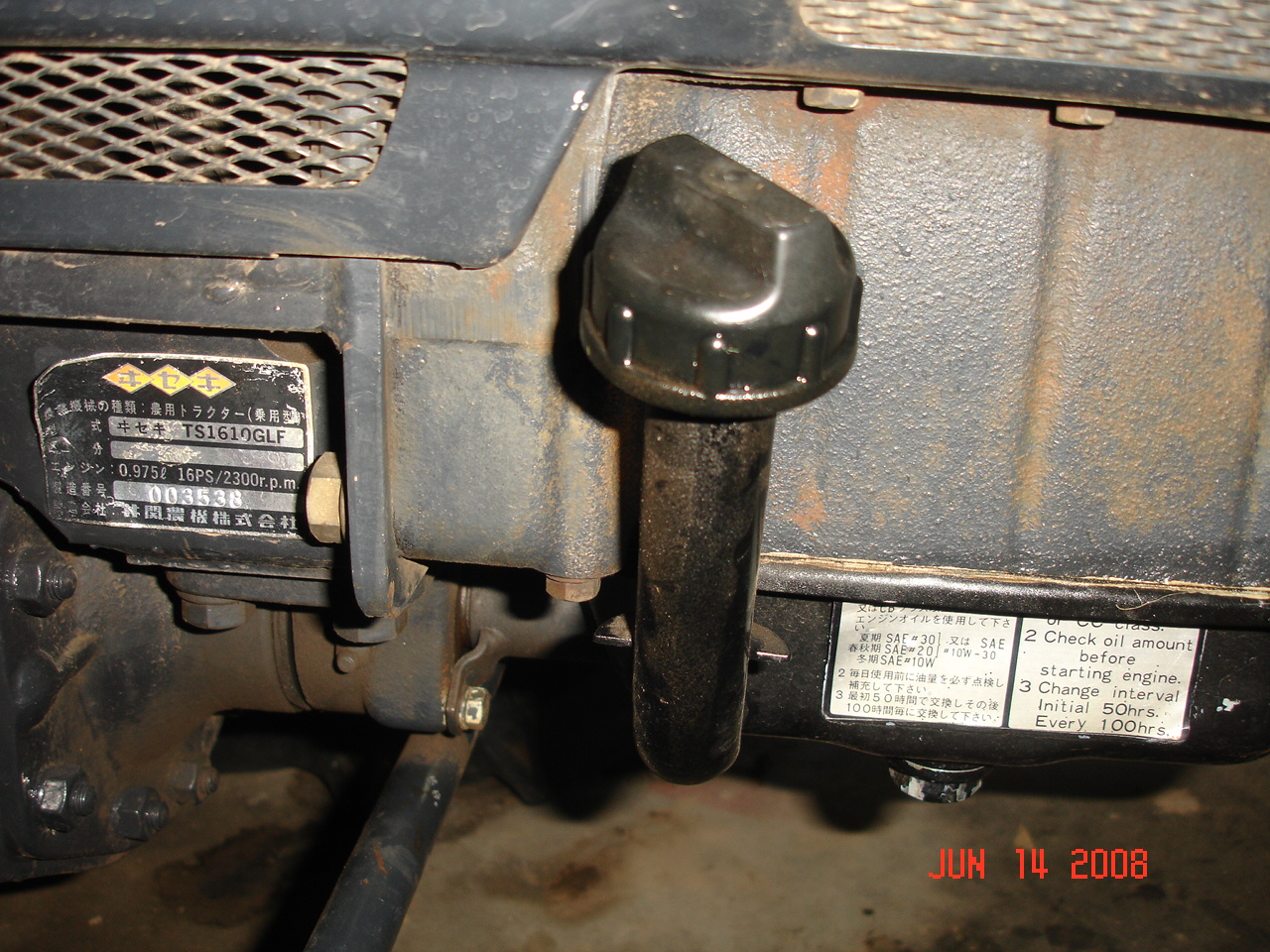

Model: Iseki TU2100F. I want to change all the fluids and filters. Problem is I have yet to get an operators manual. I have a service manual which gives me the vicosities and volumes.However, it does not give me the fuel, oil, & hydraulic filter parts numbers. I know it cross to a Bolens 212/214 and the filters should also be the same as a TU1700/1900. Anyone have these filter crossed over to Napa parts? Also the service manual suggest 90w gear oil for the trans/hydrualic oil (common resovior)....thoughts or suggestions?
OK, now for the dumb qustion. I have been all over the engine and have yet to find a dipstick?.... :confused:

Check out this thread. One (or maybe all?) of the filters mentioned must fit:
http://www.tractorbynet.com/forums/iseki/45739-need-tl2100-filter-cross-references.html
Not sure about fluids for the common reservoir. The dip stick should be on the side of the engine, into the oil pan. My model has a cap that screws onto a fill neck and the cap has the dipstick built into it. Actually, my 4x4 model Iseki has a dip stick/cap on both sides of the motor due to the fact that the front drive shaft passes up into the oil pan and kind of splits it.

BTW, the dipstick is on the drivers side lower back of the engine (semi-hidden).
