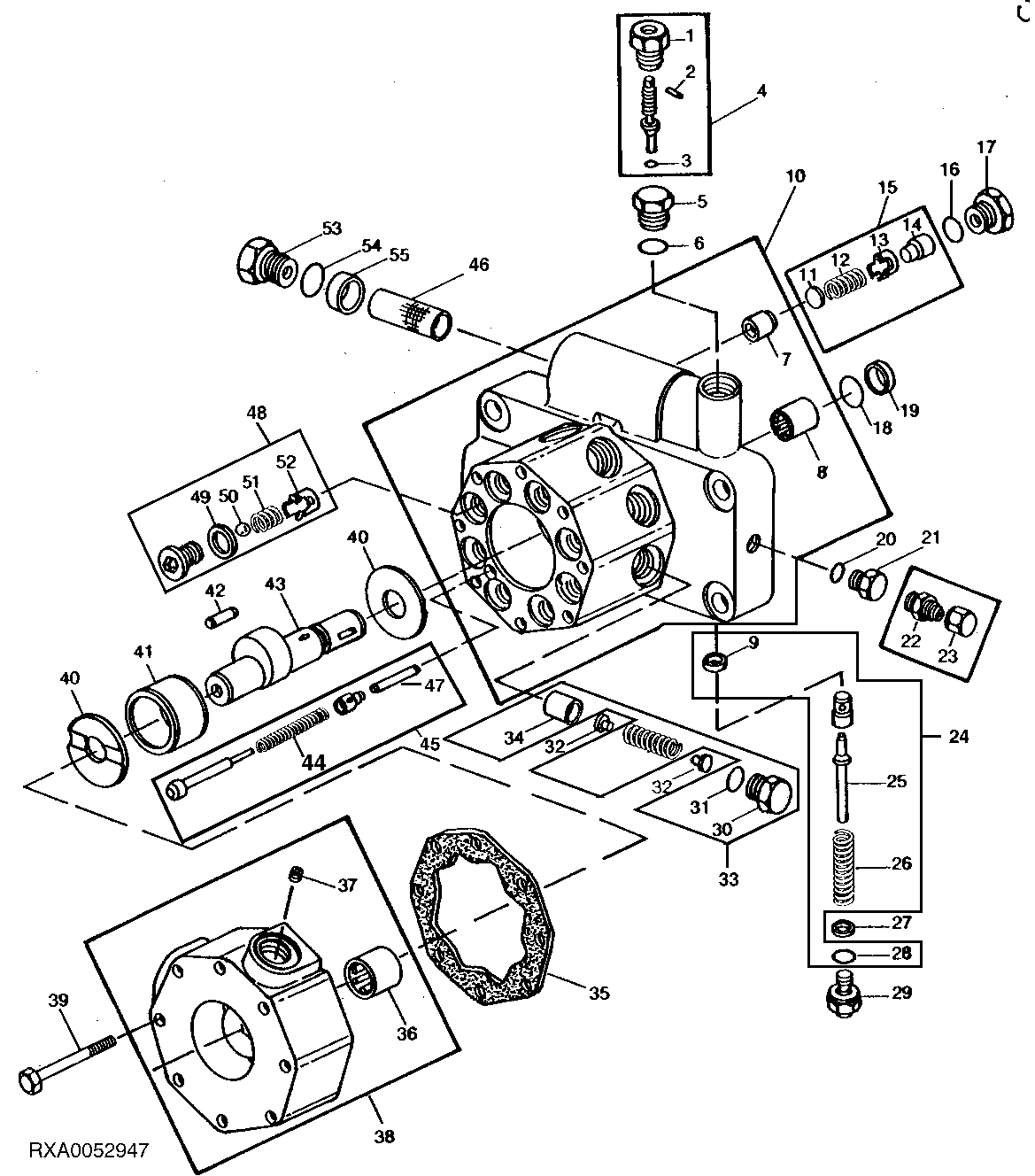

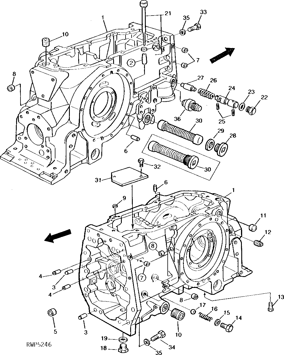

I have a 1969 Deere 1020 with gas engine. My Wix filter book shows both a transmission filter and a hydraulic filter. Which one is located on the bottom under the seat platform? Does it have the other filter too? Where is it located?
Thanks, Tony

I'll bet you that the JD filter is as cheap or cheaper than the Wix. There only one AR75603 trans filter on a 1020. There's a filter(parts key #46)in frt hyd pump and a trans sump screen(parts key#30) that needs to be checked/cleaned.
AR75603 Filter Element ADD 7.96 USD
R27173 Filter Element ADD 10.52 USD
