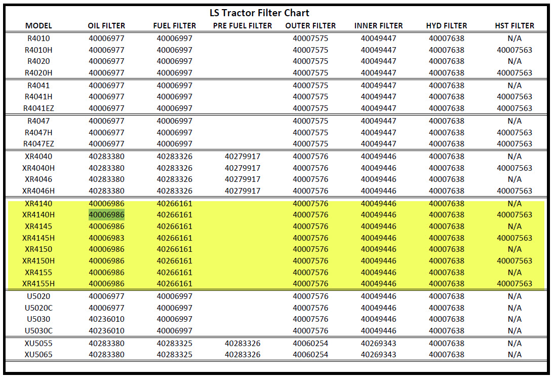

I am coming up on 50 hrs on my tractor and am about to need to do the first service. I have read through the filter sticky and I found a filter list for the XR4150HC. I wanted to make sure that they were the correct filters for the XR4140HC. They are:
Hydraulic filter: Wix 51551MP
HST Filter: Wix 51715
Oil filter: Wix 51516 or 51516XP
The lookup on Wix's site only shows the 51715 HST filter for the XR4140H. It shows the 57000 for the oil filter for an XR4040H (not sure if they use the same filter).
Can anyone verify that those numbers are correct for the XR4140HC?
Thanks.
   / Filters for an XR4140HC #2
The XR4040 and XR4140 have different engines so the oil filters are different.
They do use the same HST, Hyd, and air filters.

Did you ever find a replacement oil filter that will work with the XR4100 series engines?
   / Filters for an XR4140HC #4
Thanks.

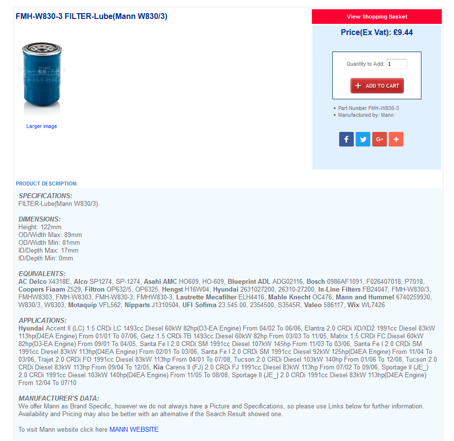

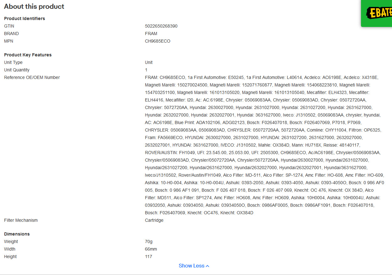

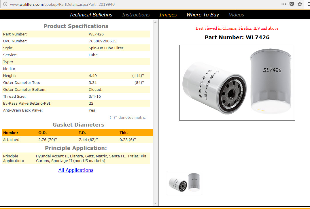

Ok..... So for us that have the newer XR4100 series engines, I've done a ton for searching and cross referencing online. The LS part number for the newer 3cyl turbo engines is 40006986. That cross references to a Case # of MT40006986 which we can get at Messick's for $17 which is for the Boomer 40 (2017 version with the same engine as our XR4100 series)
That same number cross references to a bunch of other part numbers mostly for Kia's and Hyundai's with a MANN Filter part Number W830/3 Olejovy filtr MANN-FILTER W 83�/3 Autodily PEMA
That number in turn cross references to a NAPA Gold part number of 107426 Oil Filter (Gold) FIL 1�7426 | Buy Online - NAPA Auto Parts
which in turn goes to a Wix part number of WL7426
which I was able to find at Rockauto for $6.40 WIX WL7426 Oil Filter | RockAuto
