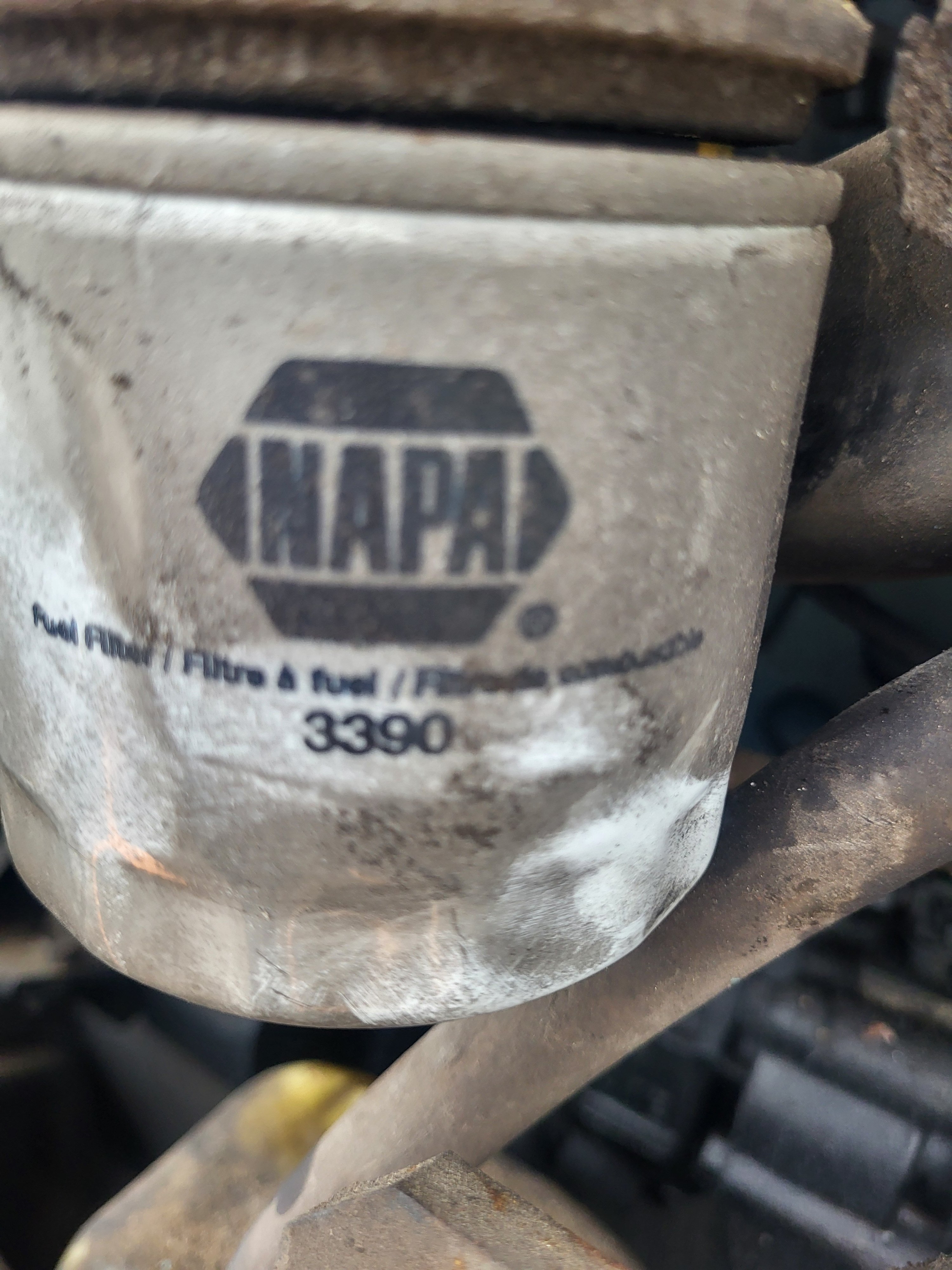

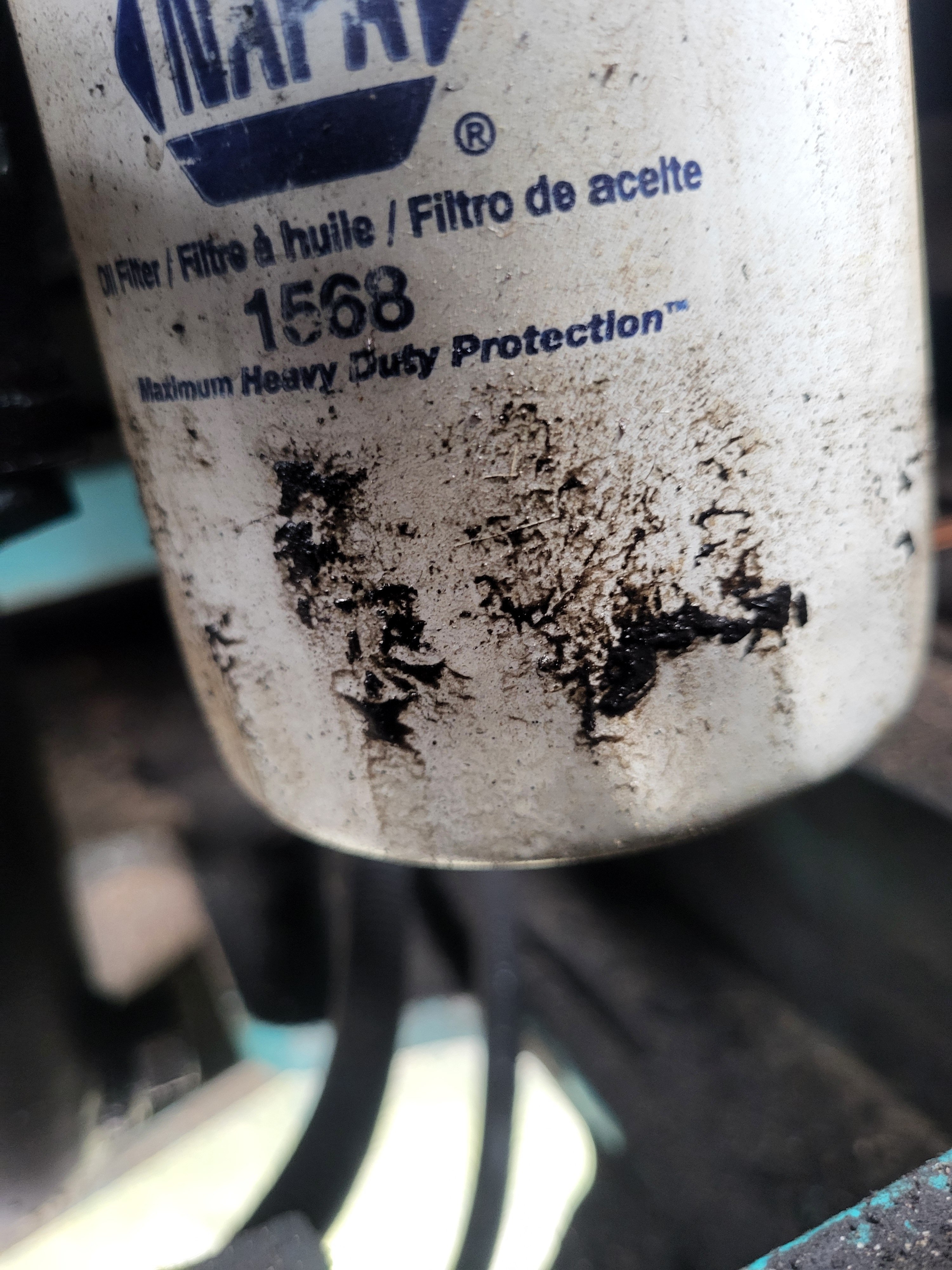

Hi hope you got your filters. That's what's on mine have the v1505 engine.
   / filters and future parts for kubota RX301 excavator #3
For your Kubota RX301 excavator with a V1505 engine, you'll likely need Kubota oil filter **HH150-32430 / HH1J0-32430** and fuel filter **1J301-43172 / HH1J1-43172** (always verify with a dealer using your serial numbers). You can find parts from **authorized Kubota dealers**, specialized **online mcdvoice heavy equipment suppliers** like TVH, or local farm/construction stores. **Manuals** (owner's, service, parts) are available from dealers or online retailers, and the Kubota RX301 itself is generally known as a reliable, maneuverable mini excavator, great for tight spaces.
