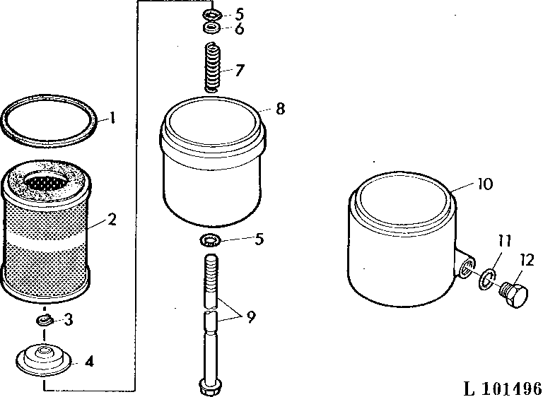

I have a John Deere 2555 and i can not seem to locate the hydro filter. Any help would be great!
   / Filter location #2
Look for a vertical cylinder on the under side of tractor. Anterior to rear axle. Single bolt running through center vertically as well. This the housing. Filter is inside. If this matches what u have let me know. I can provide u with w neat trick that will decrease fluid loss when changing.
Good luck
   / Filter location #3
This is what the hyd filter resembles. It's located on RH side under the footrest. Tractor could also have an additional screw on filter.
