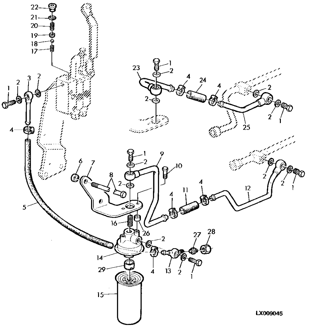

Oct 11, 2015 / filter location 2555 #1 F fire5104 New member Joined Oct 11, 2015 Messages 2 Location southern indiana Tractor john deere 2555 I did a search and couldnt find anything. Could you guys tell me where the hydro. filter is located on my John Deere 2555? thanks.

Oct 11, 2015 / filter location 2555 #2 J jd110 Veteran Member Joined Dec 31, 2001 Messages 1,587 Location Maryland Under the right side step area if open station. The filter is cartridge type in an aluminum cup. One bolt up through the center takes a 3/4" wrench. You may have an oil line to remove from the cup also, depending on how it is equipped.

Oct 12, 2015 / filter location 2555 #3 Tx Jim New Member Joined Jan 26, 2007 Messages 10,295 Location Coyote Flats,Tx Tractor JD 4255/Kubota M7040 HDC Beside filter jd110 described there is also a screw-on filter. Parts shows there could be one of 3 different length filters. Attachments LX009045_______UN27APR95.gif 31.4 KB · Views: 1,260
