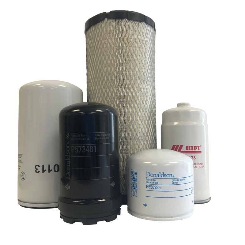

Bought the tractor last fall and am at 44 hours. Have any of you used the filter kits from Cross Filters?
Seem like all good reputable brands in the heavy equipment industry and much cheaper than OEM.
   / Filter kit for 50 hour service for DK4210
#2
Sorry, forgot to mention it is a HST model. I also have a Bobcat dealer close by. Are any of you getting parts there rather than from Kioti?
   / Filter kit for 50 hour service for DK4210 #3
HST/Transmission filters are very specialized and not common and so I'd recommend that you use OEM filters for those. To save a few dollars is not worth the risk of inferior aftermarket ones. Since you have a Bobcat dealer close by why not buy your essentials there. They will be handy to call on if you ever have a question or an issue with your tractor due to prior dealings. My 2 cents, Priceless....
Thanks all - will call Bobcat 1st since they are so close. Anybody know off hand what the Bobcat version of the Kioti DK4210 is. I think there's a thread here about the subject.
Edit - doesn't look like this tractor is in Bobcat's line up. CT4045 is the smallest they make.
UPDATE. I bought Kioti brand filters from my local Bobcat dealer that sells Kioti and Bobcat tractors. Parts guy said Bobcat uses their own filters for their tractors and that the price is similar. It's hard to believe they are anything other than rebranded Kioti filters.
E6201-32443 oil filter $16
T5710-38031 hydraulic filter $50
T4125-38021 hydrostatic filter $155!!!!!!!!!!!!!!!!!!!!!!
Also, check the front diff fluid. Mine did not register on the dipstick. Mine had UTF in it so I topped it off. Manual said 80-90W gear oil can also be used.
