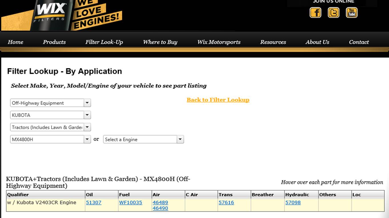

From the link provided by horse2, use the "Advance Search" option under "Search Filter". This will bring up another screen. Use the "Vehicle" option and select "Off-Highway Equipment". In the new screen select "Kubota", "Tractors", Enter your model MX4800? where the ? is DT, F or H. If everything is entered correctly you should end up with a screen shown in the attachment.
The link below will take you to the screen where "Kubota", "Tractors", etc... need to be entered. I was hoping it would take you to what was shown in the attachment.
WIX Filters - Products Catalog by Application
If you know the Kubota PN (can find on Kubota MX4800H Parts) they can be enter on WIX's website and found this way also.
Hope this helps.

   / Filter for MX4800
Yep learn something new everyday I always knew you could look them up by cross refrence but didn't know you could do it that way.
