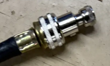

Next is the pump/transfer setup. I started with one of the readily available adapters to connect a garden hose to a tire valve. But after that I did things a bit differently. I didn't want to use the little push button valve on the adapter to bleed out air because some amount of liquid would also come out and make a mess. I also wanted to be able to monitor the pressure in the tire so I'd know when to stop pumping and let some air out. The result was this assembly of hose fittings. The branch and hose that goes to the tire adapter is also connected to the pressure gauge to monitor tire pressure. Then there are two hose connections with valves. One is liquid coming from the pump, and the other is a drain back to the drum. To fill, you close the drain valve and open the pump valve. Then after 10-15 minutes, close the pump valve and open the drain valve. That lets the air our of the tire, and any fluid pushed out just goes right back into the drum.
This also allowed the connection to the tire to just be a single hose so there isn't a lot of weight hanging off the valve. It also moves all the controls for filling and bleeding to a comfortable location rather than crammed between the wheel and rear end of the tractor.
