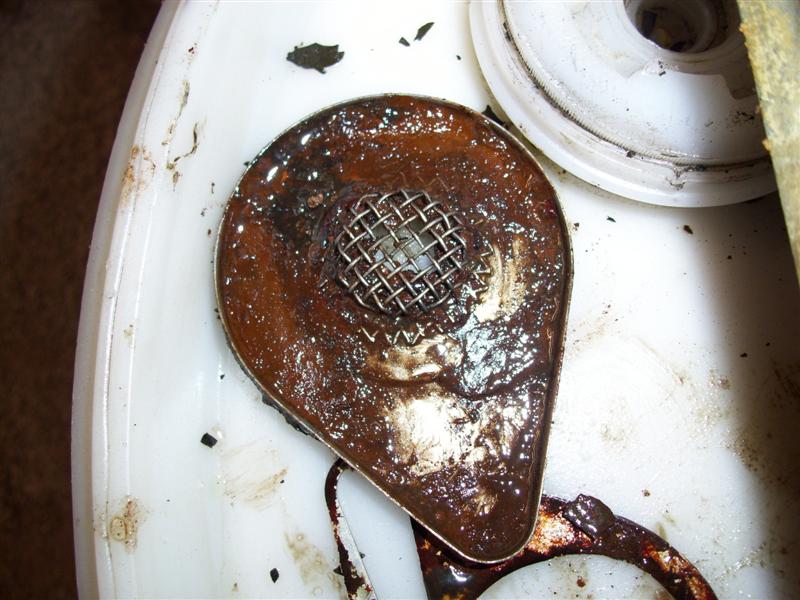

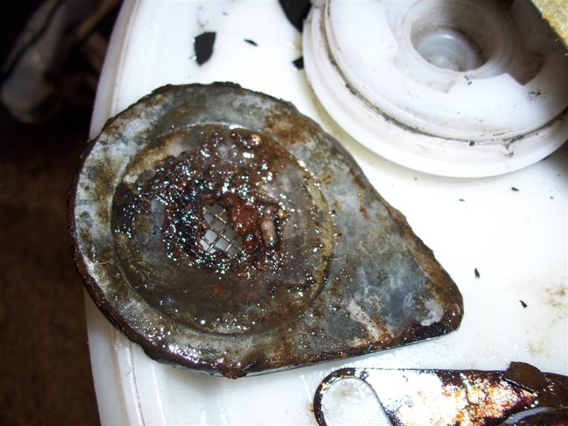

Here are some pictures of pump intake taken from a fuel tank of a surplus military truck I bought a few years ago. It'll give you an idea of the stuff that grows in diesel when condensation/water accumulates.
I plan to drain/flush all of my diesel tanks every couple of years after seeing this stuff.
