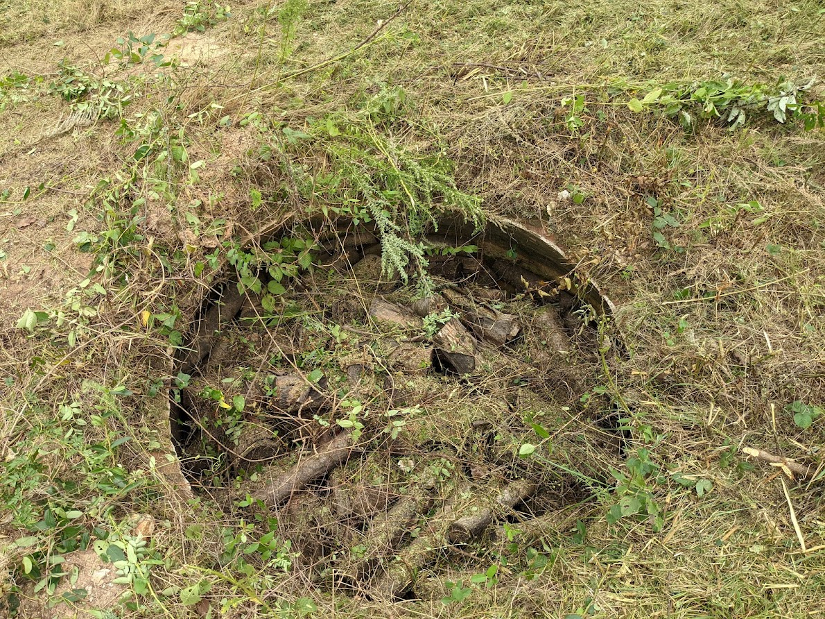

Found what I think is a cistern while mowing the other day. Luckily I saw it as I think it could have been disastrous if a tractor wheel found it first.
it's around 5ish feet in diameter and lined with some kind of mortar or clay and concrete. PO seems to have tried to fill it with tree parts but I am thinking that is not the best solution.
Right now it looks like an awesome burn pit. I will however need to fill this, it is to big of a liability. Should I remove/burn the wood that is in there? I am thinking as it rots it will settle. When filling should I use all dirt? I was thinking perhaps fill it with some kind of rock and topping it with dirt. Or should I go full bore and call the concrete truck :) I have no idea how deep it is at this point.

Got a gravel pit close..?? Concrete, or fill sand would probably be better to work it's way down around those chunks of wood. Make a slight mound as mentioned, and every time it rains, it will wash the sand down around those pieces of wood. You could pull out what you can to get a good start. Burning may be an option for the very top, but doubt it wil burn very deep, because of lack of oxygen, unless you provide an air source. I'd imagine the wood that's down a few feet is water logged anyway.
   / Filling a cistern #4
I’d pull the wood out or burn in place if it will burn and then fill with dirt.

pull Most of the wood out. I doubt it will burn in place, it would be hard for combustion air to get in.
knock a couple of feet off the top so it is below ground level. Then back fill with reject concrete sand. It tends to be self consolidating. The other option, but more expensive, would be a Controlled Low Strength Material. Essentially a 3/8-inch minus Portland Cement, with only 1/2 to 3/4 sacks per yard, a high water to cement ratio, and plasticizer added. It should have a 10 or 11-inch slump so it is self leveling.
