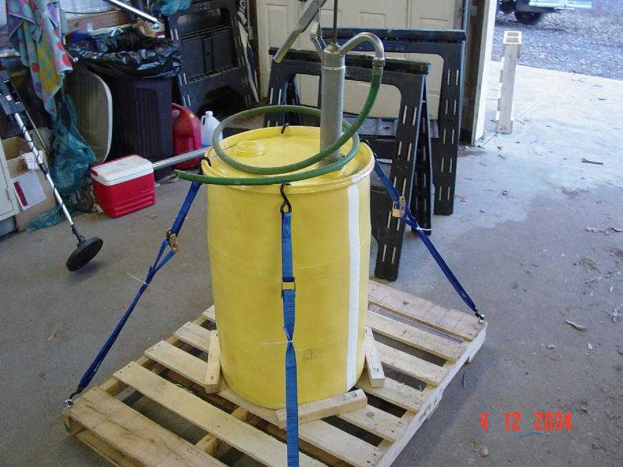

I just hate to pay Diesel prices at the pump /forums/images/graemlins/mad.gif so this is what I did to save myself a little of my hard earned money!

Here it is ready to go! I changed to a bigger Pallet, the first one was too small and wanted to tip over.

Exactly the same barrel, and similar pump as mine. You must use a FEL to get it off your pickup or trailer. Since I don't have a FEL, I just screw in both bungs pretty tight, and strap it in the PU. When I get it home I can lay the barrel down on it's side and roll it to the tailgate then turn it just enough to tip it off to the ground. Then twist it around into place. My pump has a metal spout that has a piece of garden hose slipped up on it. I use a 5 gallon bucket sitting on top of the barrell for a catch can.

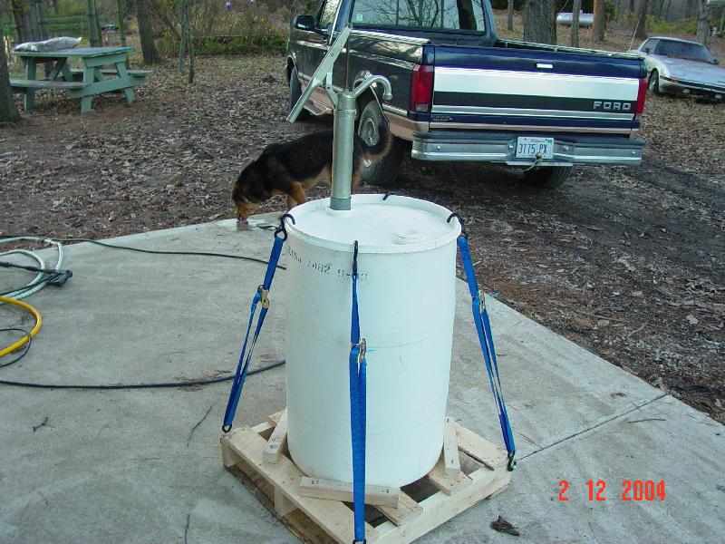

That looks like my pump and hose, but my barrel was blue and I didn't have the straps to hold it down; just gravity. /forums/images/graemlins/wink.gif I stayed with the smaller pallet and loaded and unloaded it into the back of the truck with the forks on the FEL bucket.

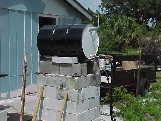

That's pretty slick. I'm still going at it the hard way. Start with strapping the empty drum upright in the back of the pickup and take it to get filled. I leave the hose fittings in place with shut-off valves, remove them at the fuel dealer, and replace them to seal it. Lay it over in the pickup bed when I get home. Roll it into the bucket of the FEL and strap it in. Carry it to my 5' high fuel stand and lift it to the platform. Roll it off the bucket and chock it in place. Then, reattach the hose and fill nozzle to the shut-off valve. Then, my gravity rig is ready for business again. To make it flow, there is a vent attached to one bung and the hose fitings to the other; both have ball valves to shut them off. No pictures for now; the temporary platform is a section of an old porch deck, several different colors and ugly as sin, I'm a little ashamed of showing it in public. One of these days, Real Soon Now, I'll get a round tuit and build a nice platform with a roof.
Even as bad as it looks now, it's till better than our pre-temporary, really brief temporary stack of blocks we used for the first few days. Since that dangerous concoction is long agao history, I don't feel so bad showing a picture.
