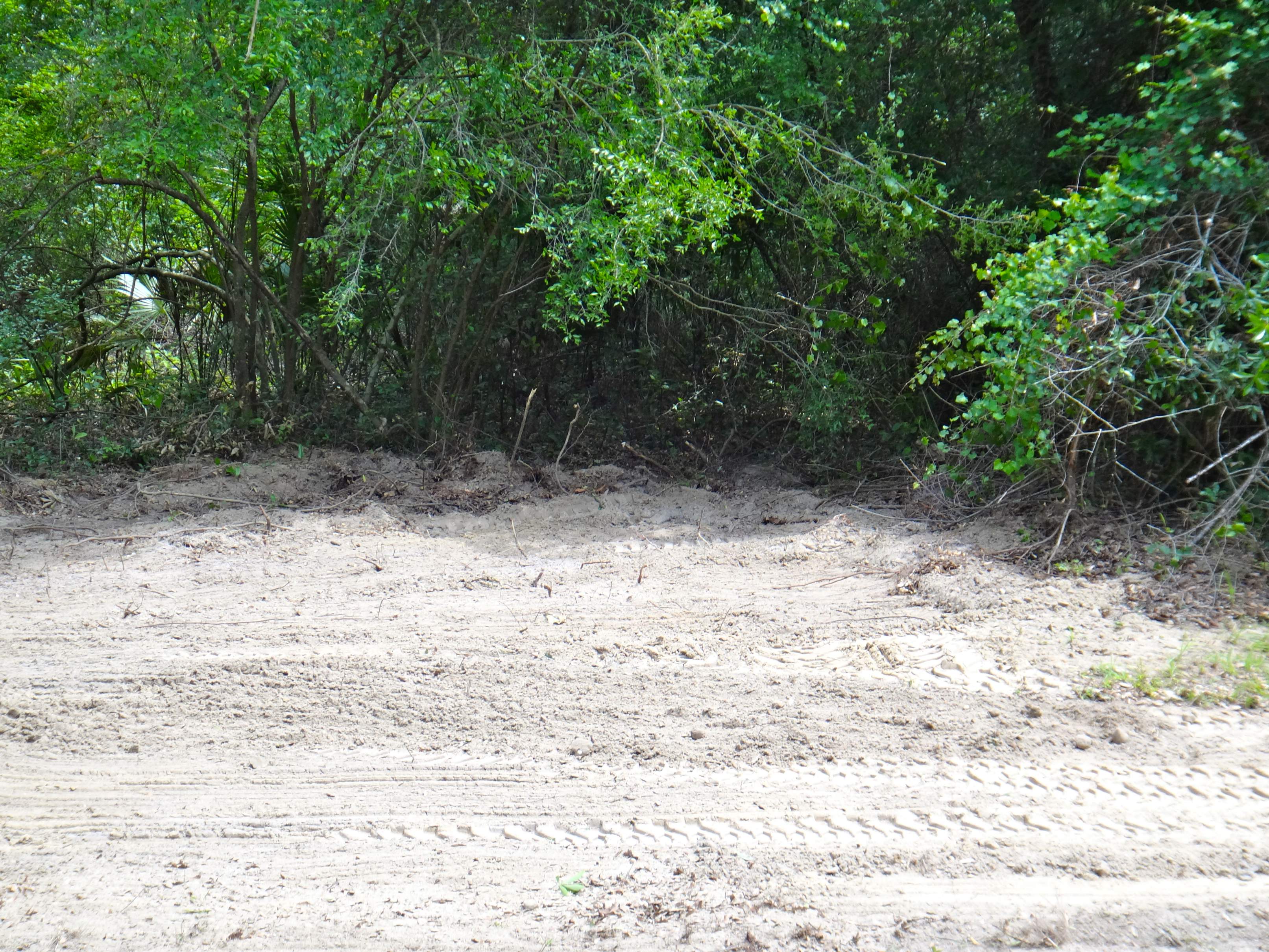

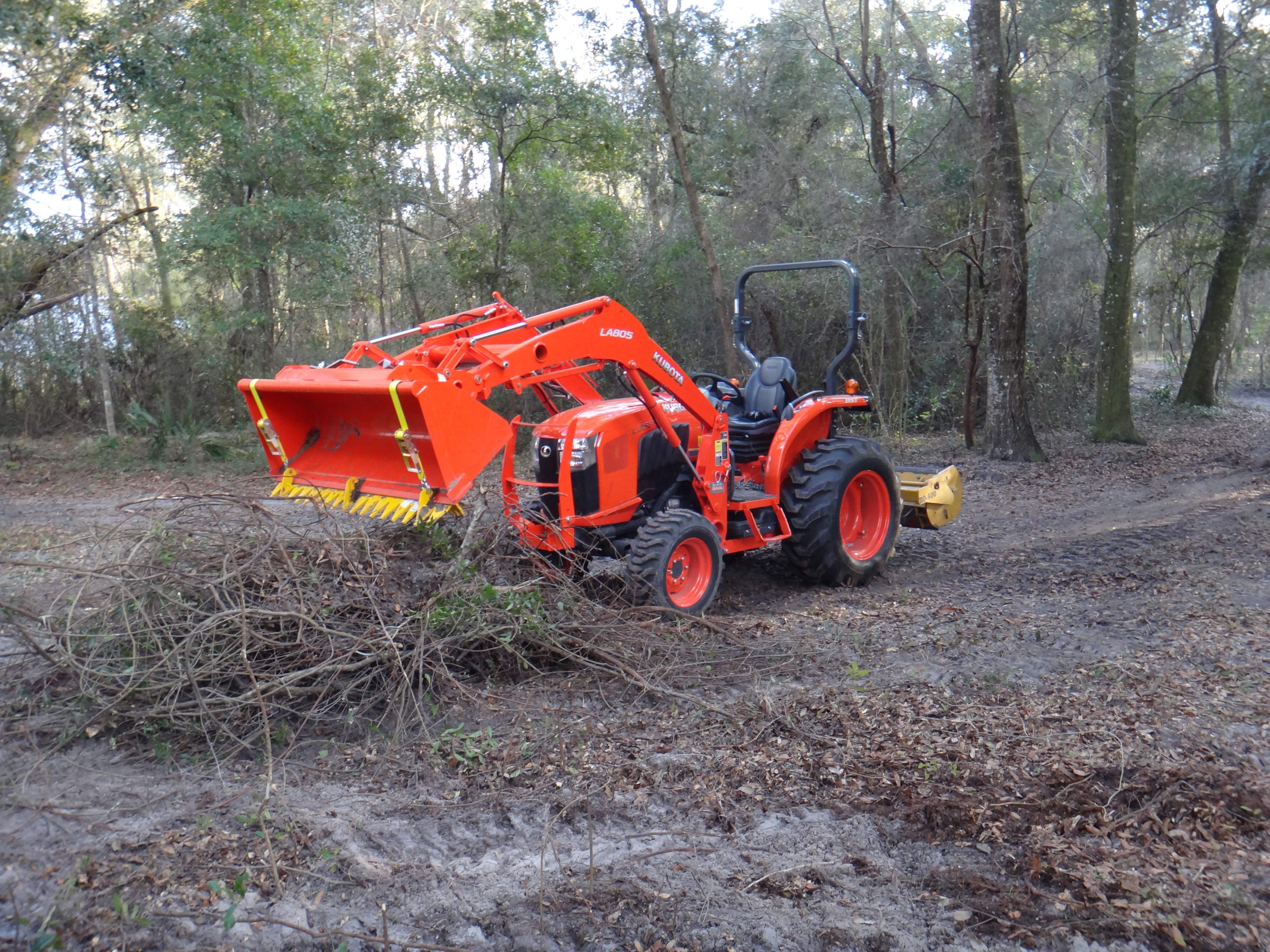

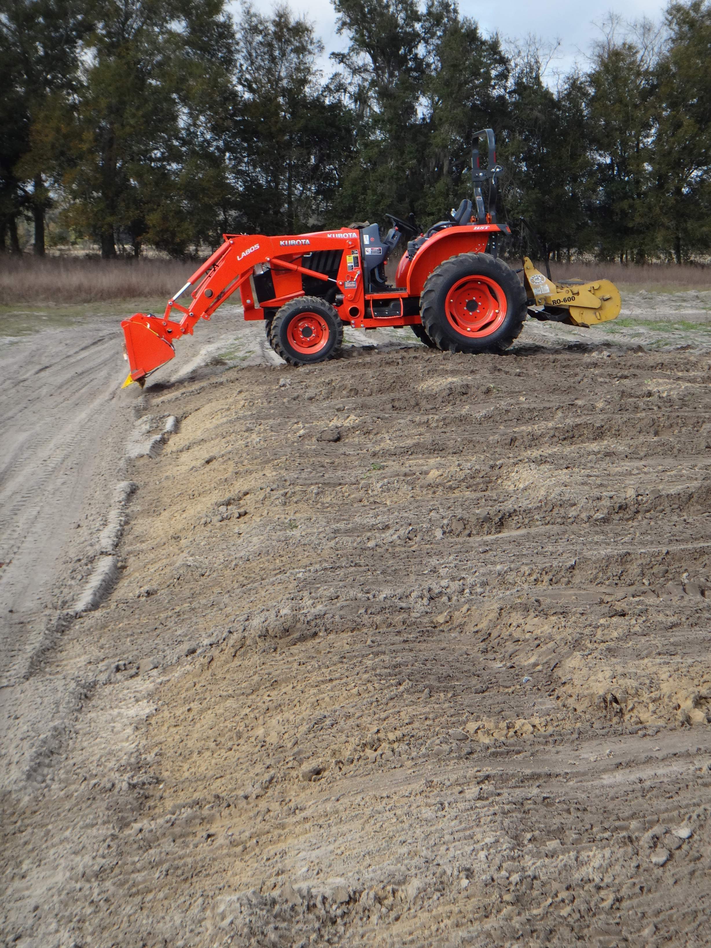

I just had 2 fields cleared out of my woods, one about 7 acres for my deer hunting field, and another a bit over 1/2 acre for my shooting range. It was all a pine "plantation". Had the timber company come in and take the trees, then a guy with a dozer and a track hoe to get the stumps out and clean up "most" of the mess.
So now I'm left with a fairly rough field, very undulating with dozer tracks, and LOTS of roots everywhere I need to clean up and make level to plant. I do have the benifit of having a little money left over from the timber harvest to buy a couple attachments..so my question is what to get.
Here is what I have to deal with.. looks worse in person than these pics.
Right now I have a 7' landscape rake, which does kinda ok, but after going 100 feet its all tangled up with roots so I have to clean it out by one of the burn piles.
I'm thinking about a disc, box blade, and then a seeder for when I'm done cleaning up. Its mostly soft sandy soil(more sand than soil), will the disc cut these roots up you think or no? And smooth discs or the ones with cuts in them? Or is there a better tool for the job? disc first , or box blade first to smooth things out first?
Thoughts and advice are appreciated!

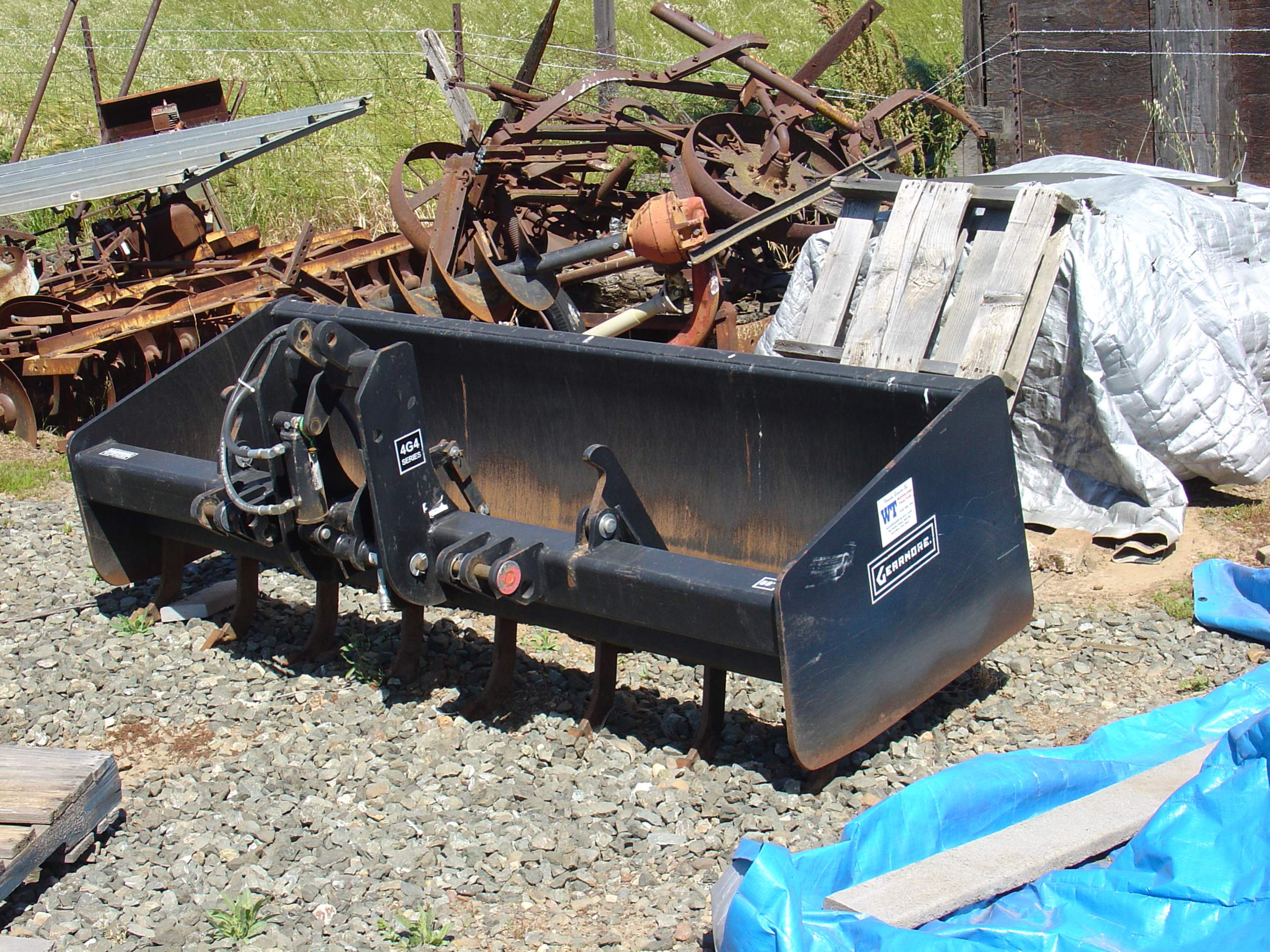

A box blade with scarifiers will do an amazing job of working the soil. It will load up a lot less than a landscape rake and will almost "disc" the land similar to a chisel plow.
If you set the scaifiers right and the tilt is right then the box blade will do a fair job of leveling, also. With the box blade tilted way back so it won't dig (or barely dig) is best for smoothing. It can be done at a reasonable speed since the box won't load up.
A hydraulic top link is very handy for the job you want to do as well. After the shaping is done, disking will be very effective.

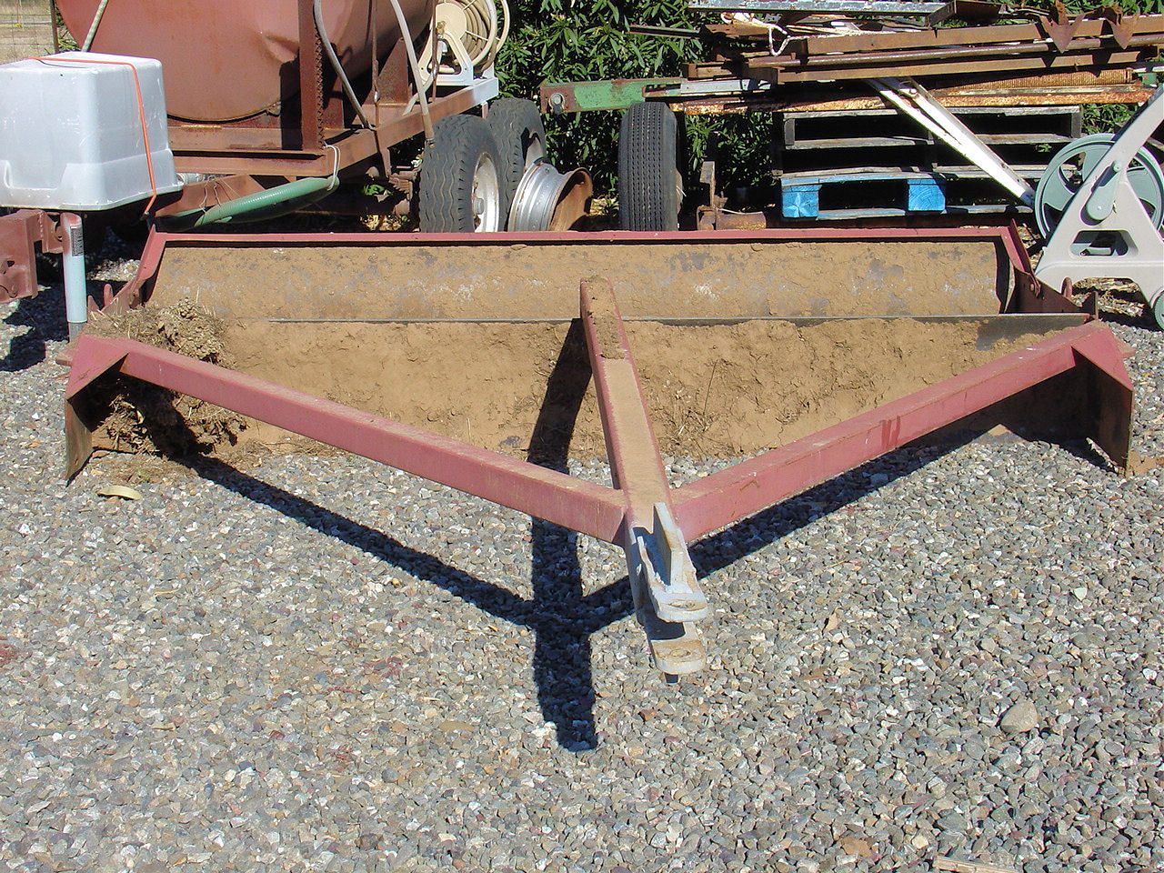

If you can find a dedicated land leveller like this it would help.

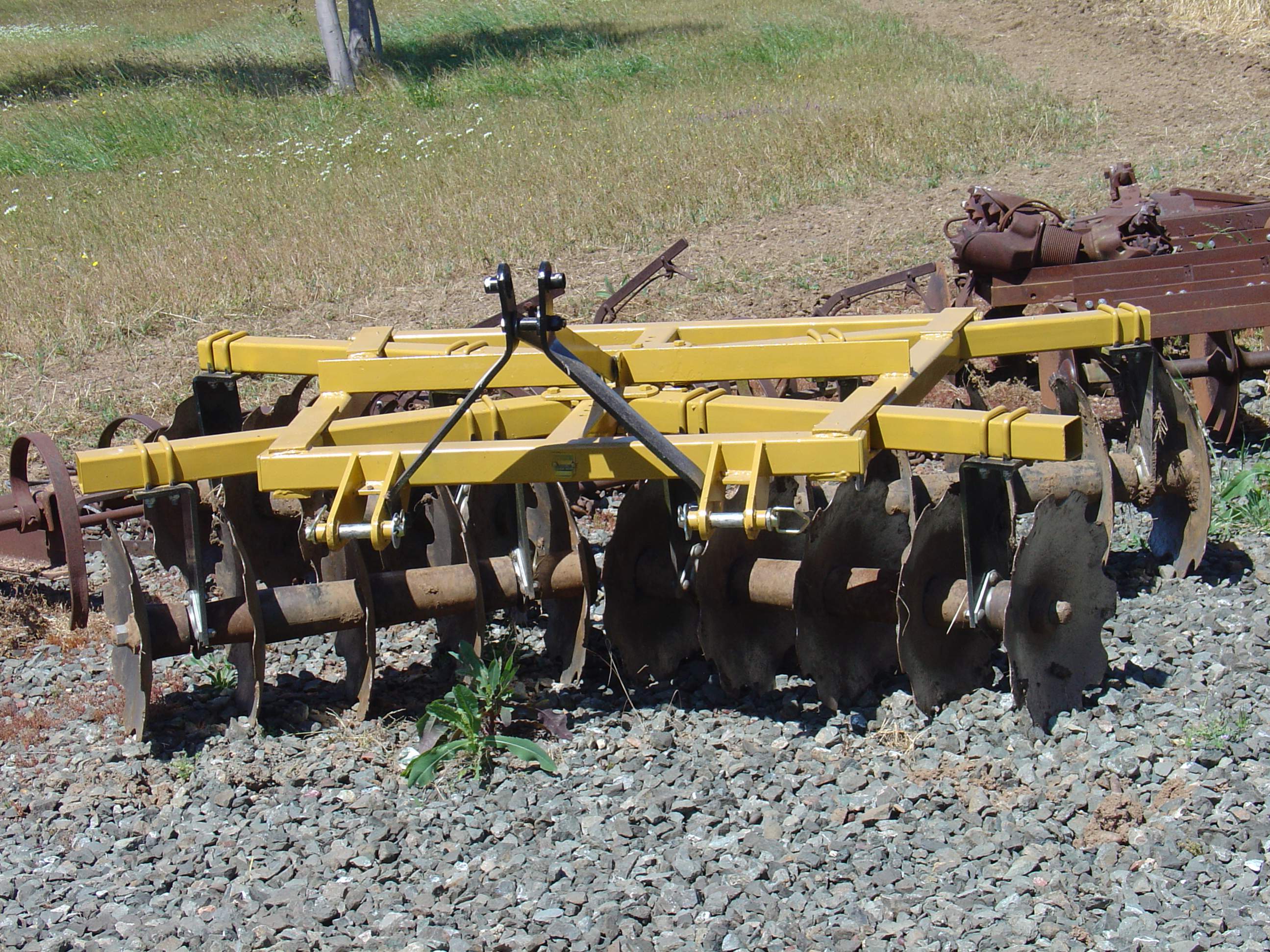

A simple 3 PT disc should do the job at the end.

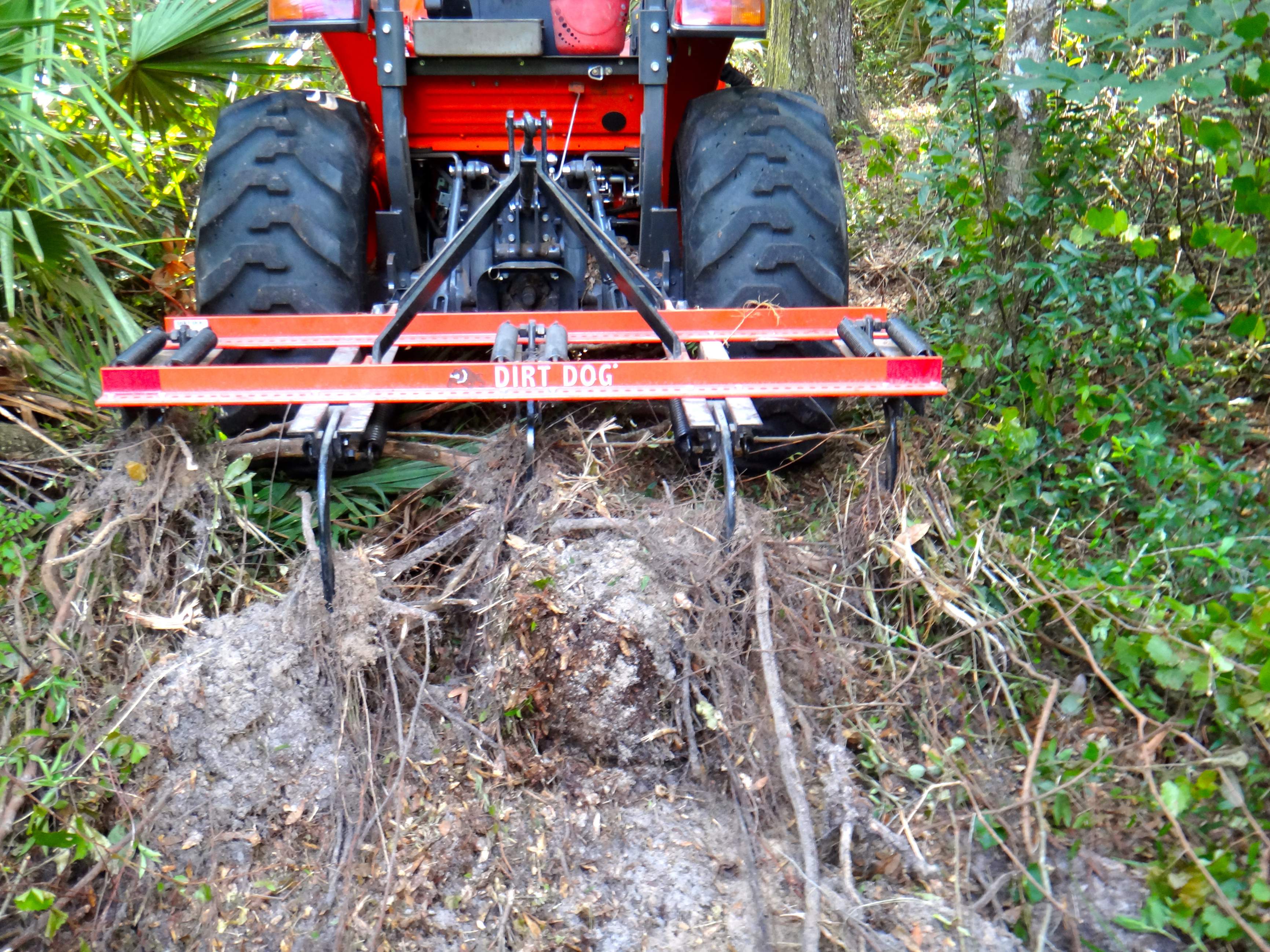

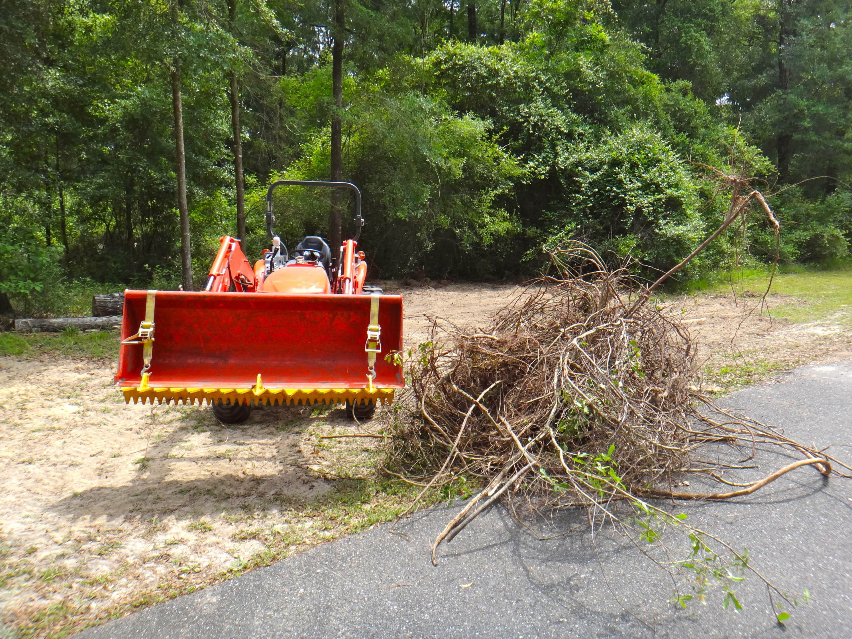

I recommend:
1. FEL grapple/root rake. Most expensive option. "All in One" tool(s) for your task.
2. Field Cultivator. <$900. Will penetrate 6" to 12" depending on conditions.
We use the same tractor model. Five shank Field Cultivator is a good match to tractor.

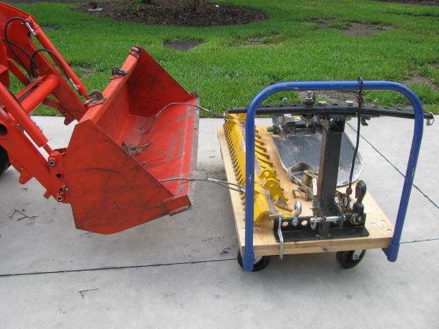

3. Ratchet Rake attachment for your FEL bucket. $400.
Ratchet Rake is more effective at collecting and piling tree debris than a Landscape Rake but only penetrates
into soil to extract roots 2" or so. Ratchet Rake does not "load up" with debris. Pretty good at grading.
You can buy a Ratchet Rake with FedEx delivery from the T-B-N store.
FIELD CULTIVATOR LINKS (2):
http://www.tractorbynet.com/forums/attachments/339095-dirt-dog-all-purpose-plow.html?highlight=
http://www.tractorbynet.com/forums/...ement-vine-root-removal-woods.html?highlight=
A Disc Harrow is one form of soil tiller. You can pull a Disc Harrow with 20" diameter pans with your tractor, max, but that is not heavy enough to yield results you seek. (Fine after roots extracted.) $2,400 new.
(You would want a Disc Harrow with notched pans, front and rear, spaced 9" apart, not 7". Smooth pans would roll over debris in your photos.)

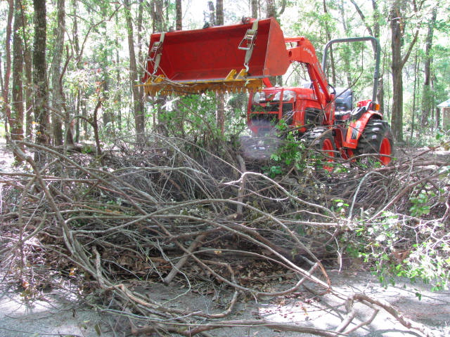

I have a FEL root grapple already, which is good for picking up the big stuff, (all those stumps in the pics are already piled up so I dont need to do that)
Also , the ground is already pretty loose from all the activity, dont need to penetrate, just smooth things up and collect or bury /chop the roots left over.

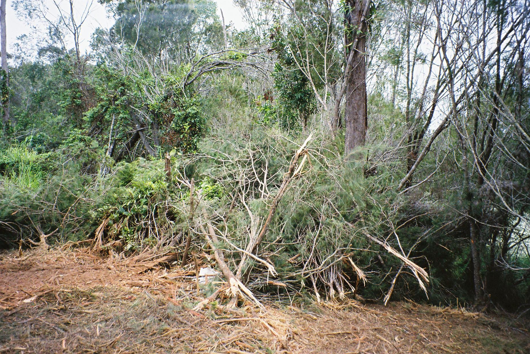

When I see a mess like you had in the first photos I also see topsoil that is going to be lost forever unless it's mulched. As you stated "you have sandy soil with more sand than soil" and no doubt very little organic matter. Mulching your site would put some orgainic matter into what soil you have for the betterment of your land.Now for your own reasons you have elected to clear this land using the methods you which is fair enough but I don't belive it's the best method.
Yes I am a contractor and you look a bit further at my advitar you will notice my location, about 20,000 miles from you so I have nothing to gain financialy from my comment

Interesting ,and not something I really knew existed, and maybe its not here. Upon talking to local timber guys and clearing guys, this type of thing was never mentioned.
Well I did find these... what do you think about them? Also tracked down a 66" roll over box blade I'm thinking about.

Those look nice. Very similar to road graders so they should work fine. It would need to be properly adjusted to work well. But once it is used to level your land it will likely just sit. Or you might choose to sell it. If you could rent one for your project, that would seem the best solution
The only comment I'd make is that a box blade with scarifiers is similar and would be of more use in the future for other projects. Wide trenching for drainage, moving large amount of soil, pushing burn piles while burning (backwards!) come immediately to mind.

Yes but thanks for replying. And yes, everything I am looking at has the scarifiers. And yes, you hit the nail on the head as far as the usage of the land leveler after I'm done.
/ Field cleaning thoughts... #16

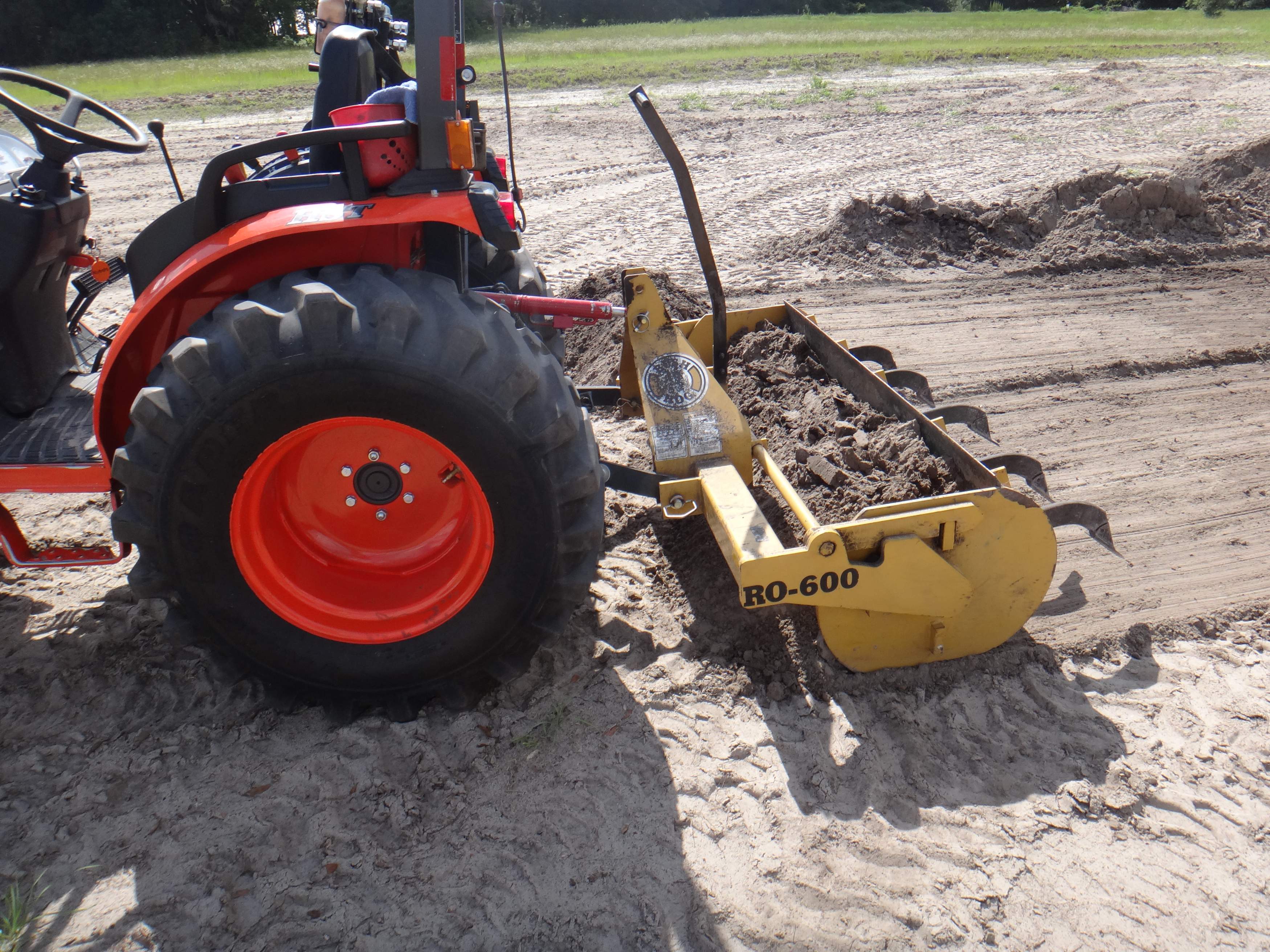

Rollover Box Blades work well WITHOUT hydraulic support. They are less finicky about adjustment. They are an ingenious design.
Generally speaking ROBBs are heavily built and somewhat more complex than standard Box Blades so they cost more.
I have never encountered, nor seen pictures, nor read of a ROBB without scarifiers.

Here is a before and after of how I work. This job was in soils very similar to your land. What we do is go through and rough cut it then the client seeds the site, then I do a finish cut which covers the seed, nothing more to but watch the grass grow Burbank before 2.jpgBurbank job after (Small).jpg
