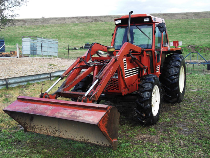

IMO the Fiat "80" series (780, 880, 980, 1180 ..etc) , "50" series ( 450, 550, 650, 750...etc) & "40" series (540, 640..etc). are some of the most robust, reliable, low cost maintenance & easy to work on tractors every made in this HP range (although the panel work/cabs can suffer rust easily) - stay away from the later "66" series (566, 766..etc) which generally leave a lot to be desired....
Whilst Massey's continue to be popular second hand for lighter hobby farming, a Fiat is generally pound for pound a heavier duty machine which stand up to lot more heavy (ab)use in hotter climates & are also much stronger in the front end for loader work - the 4x4 Fiats particularly are engineered from the ground up as a 4x4 machine from the outset than the equivalent "bolt on" afterthought 4x4 system Massey's
As with any second hand tractor it all utimately comes down to the condition of the individual units for sale in your area - Pictured is our 780DT which has now c.6500hrs & I reckon will keep going for another 6000hrs easily (we also have a 180/90 with 8000hrs & for sentimental reasons a 1300 & a 411R, +a few Fiat dozers)
