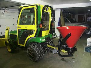

I have a WorkSaver 3ph spreader. It holds 6bu's and has the optional agitator that has wings on it & sticks up about 10". I've only used it for sanding so far and works very well. I think the cost was around $375. The agitator will probably solve any clumping issues.

I just added "wings" along side the broadcast spinner. For anyone needing to sand these are a must. Otherwise the sand gets spread in a 180 degree pattern which covers the lawn, etc. Now it spreads at a shallow angle straight out the back.
