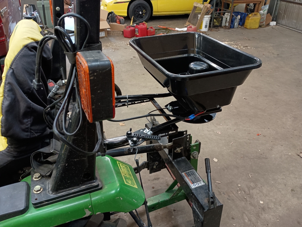

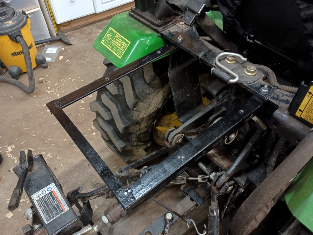

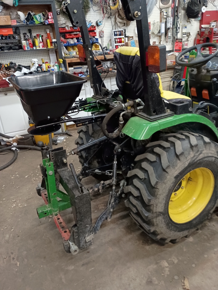

I took Runner's advice and got the Amazon spreader. I didn't get the one with the receiver hitch because I didn't think I could reach the handle from the seat. The one I got was $179 but there was some kind of rebate so it ended up about $160. I cobbled up a mounting bracket from some scrap and mounted it to the base plate of my ROPS which had a couple of holes in a convenient location. I have a 12 volt connector under the seat that I use for work lights when I have my soft cab on in the winter. It only took an hour or two to install. I suppose it will spread a pretty wide pattern because of how high it is. I will probably cut up an old tarp to cover the hitch and rear of the tractor when I use it to keep fertilizer off the tractor.
It's not very large but I just need it to fertilize about 2 acres twice a year. We'll see how it works next week.
