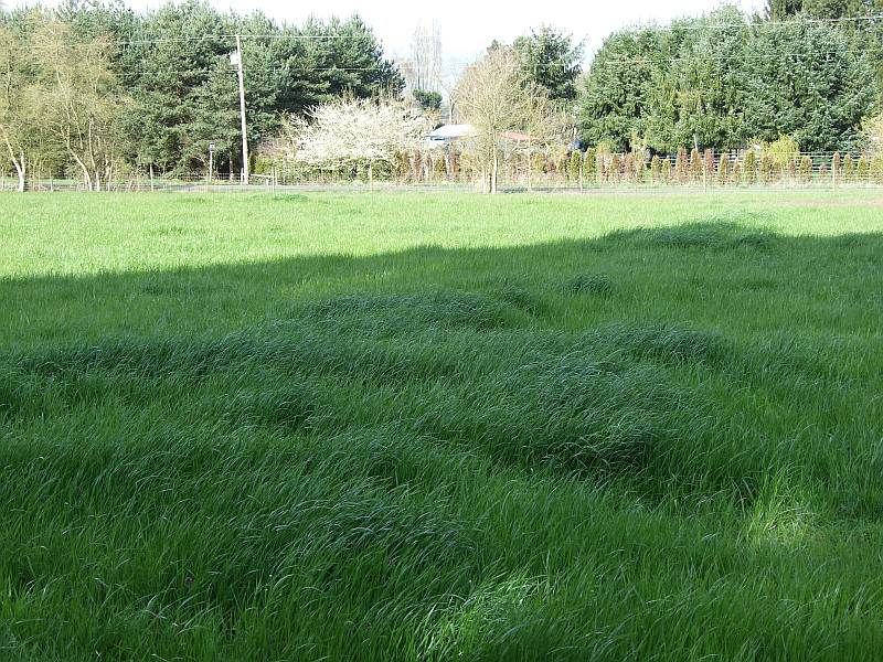

I think a lot depends upon where you live and soil condition. For around here, I'd go with after giving the grass a chance to get established.
Around here it's hard to keep grass from growing in bare spots. Here is a pic of the pasture I replanted last Oct. No fertlizer used since last spring.
