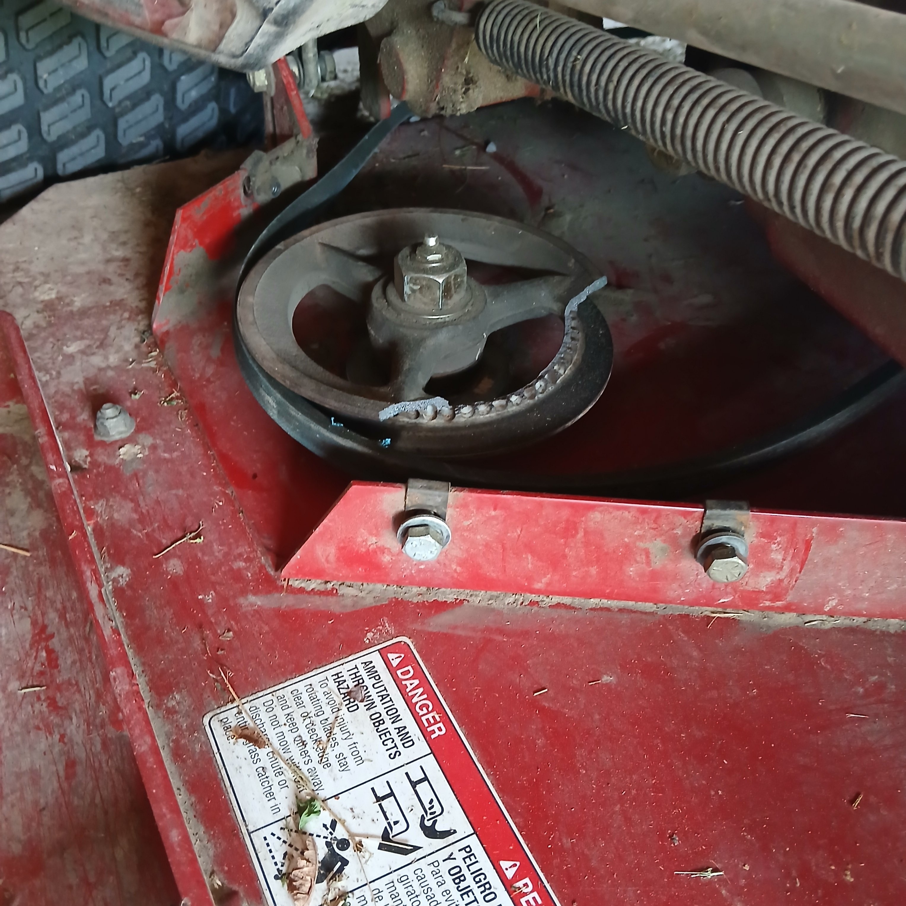

Why would the top of this spindle break off?

Looks like just the pulley, but a Rock (or other hard item) getting sucked between belt and pulley can do that on a cast pulley. I've busted one or 2 using a puller to remove.
   / Ferris is2000s spindle broke #3
Did the spindle actually fail, causing the pulley damage, or is that just a broken pulley? As Eagle noted, could've been a rock or stick, if just the pulley.
If spindle failed, then most often that's due to insufficient lubrication, or hitting a protruding root or rock. Having said that, I've hit roots hard enough to jar tooth fillings loose, and never damaged a spindle, so... have you been lubing those spindles every 50 hours, as prescribed?

The spindles are lubricated with red grease every 10 hours or so. The spindle does turn freely, so that may mean just the pulley has been compromised. I will call the shop tomorrow.

Get the belt off and see if it spins freely. If no wobble, vertical play, or grinding noises, it’s probably fine.
But greasing every 10 hours sounds excessive, unless your manual actually prescribes that. Normal would be 1-2 pumps every 50-100 hours.
