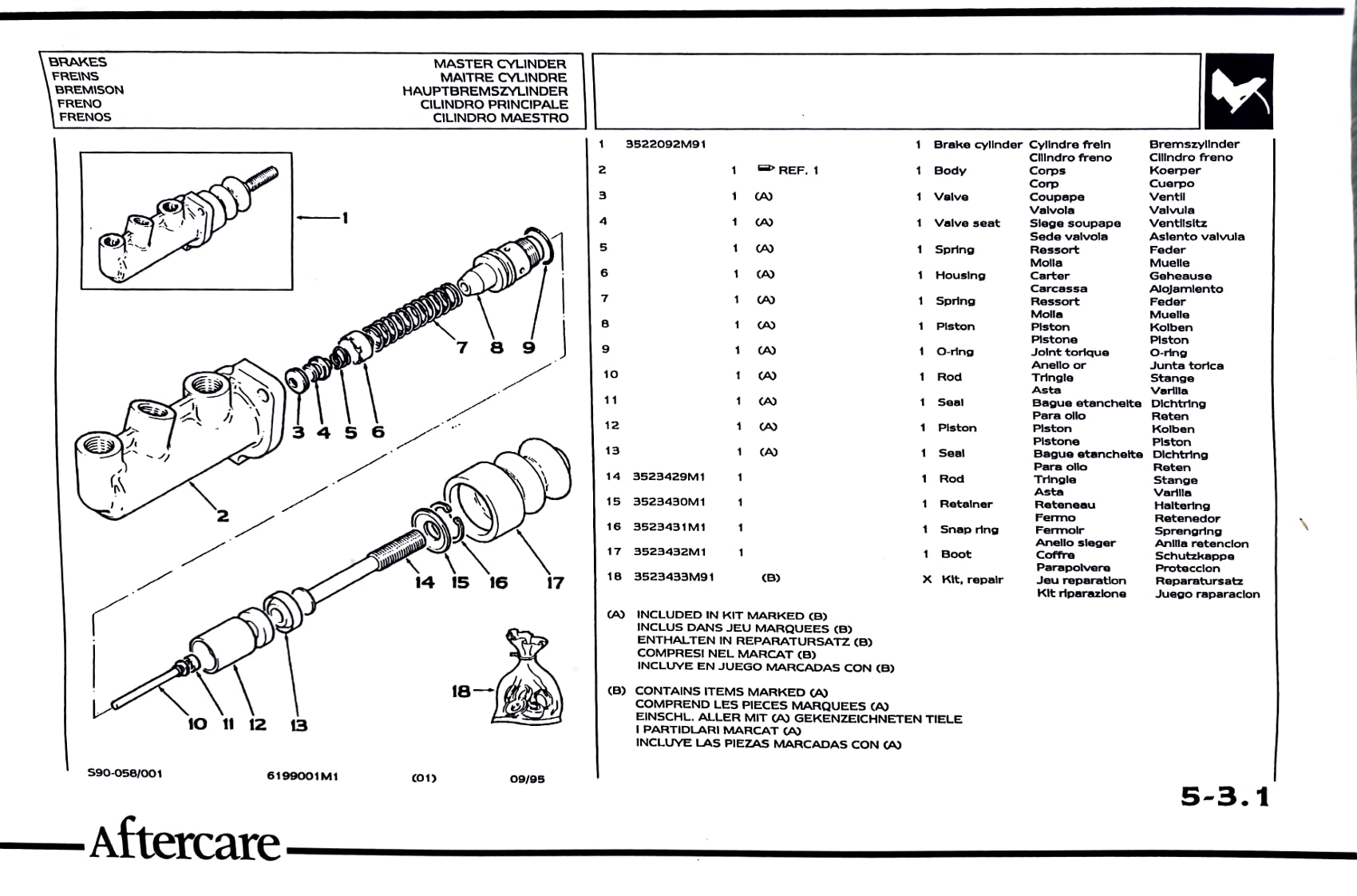

Hi everyone,
I am new to the group. My question is does anyone have the correct part number for the master cylinders on a 1999 Fermec 640B skip loader?
Thanks,
Justin
   / Fermec 640B master cylinder question #2
Welcome to TBN!
I have a Fermec 600 book, but I believe this is the part #:3522092m1
That is exactly what I needed....THANK YOU!!!
