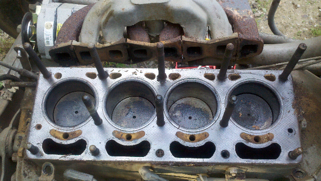

I think I actually need to replace the head gasket on my TO30. It constanty overheats, blows out the overflow on the radiator. I talked to the fellow that rebuilt it so time ago and he said there was nothing wrong with it. I know better. I just removed the valve cover and have white foam around the top. there are several big drops of water around the top of the head. The water pump pulley housing refered to as the drive shaft support has a rectangular hole in the bottom that spews water as well, this looks like a factory hole. The impeller blades look good. I checked the thermostat and it is in good working condition. I am at a loss. The tractor runs good until it gets hot, I'm afraid I will crack the head or the block if I haven't already. I could use some good advice.
   / Ferguson TO30 Head Gasket #9
Usually a water pump that's leaking coolant needs a rebuild, or more likely replacement nowadays. I assume since you inspected the impeller you've had the pump off. I'd just replace it - under $50 I think.
White foam could be from an underused or run-cool engine - have you worked it hard recently? Changed the oil recently?
You could have a crack head or block, or bad head gasket, but start with the simple stuff. Radiator clean inside and out? All hoses in good shape (not collapsed)? T-stat checked with a hot-water test (or replaced)?
If you can't run it hard because it overheats, and you've tried all the above (which would not hurt anyway assuming you'll be fixing this old girl up), then it's time for a bigger tear-down.
Jim
   / Ferguson TO30 Head Gasket #10
Thanks Jim
I checked the thermostat in boiling water with a working thermometer, it is good. All hoses are good. I have a few small leaks in the radiator. I am going to take it to a shop and have it repaired properly, previous flushing shows it has good flow. I have the valve cover, and intake and exhaust manifolds off. The next step is the head, Can I remove it with the rocker arm and all valve components in tact or do I have to remove them first. I have mechanical background, but this is new to me.
