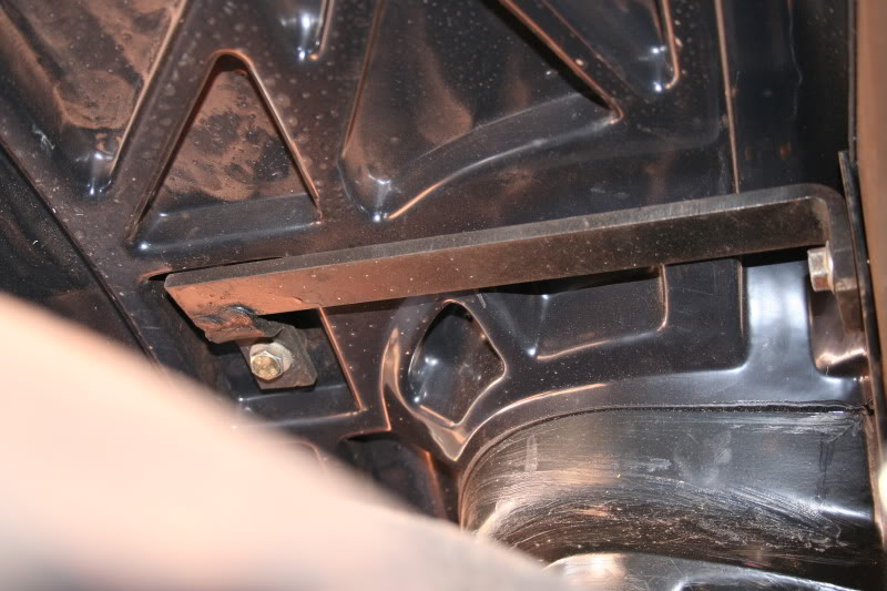

My remedy was to use Fusor 117 metal to plastic adhesive. This is the same stuff auto companies are using to glue together the new cars. GM for instance uses this to glue roof panels and quarters on their new cars as well as Chrysler and Ford. Using the same principle as a very large washer for extra backing and support, I made a large 1/8" x 1' x 1' steel patch fitted and formed to the inside of the fender (closest to tire) right over the roll bar mounting area, and then Fusor glued it in place with a homemade clamp( I just put 2 bolts and large washers through the factory holes and my patch and tightened them down sandwiching the metal patch to the fender while the glue dried). After one year it is holding up great. The thin steel NH bracket inside of the fender go over this. Cracks have not spread and the fender is more solid and less flimsly.
Here is a brace another poster had made. I will probably make this brace in the spring for extra rigidity or make one that attaches to the roll bar like the earlier models.

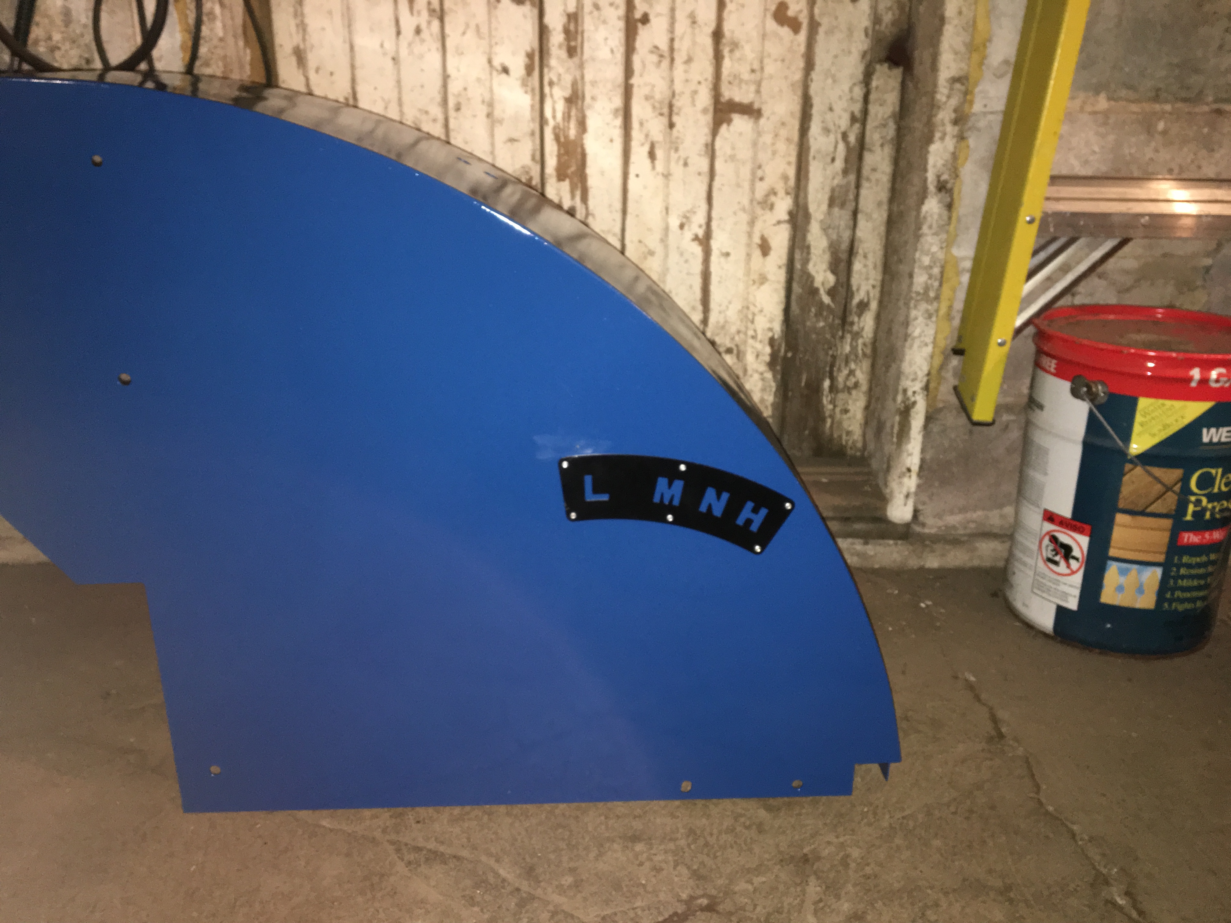

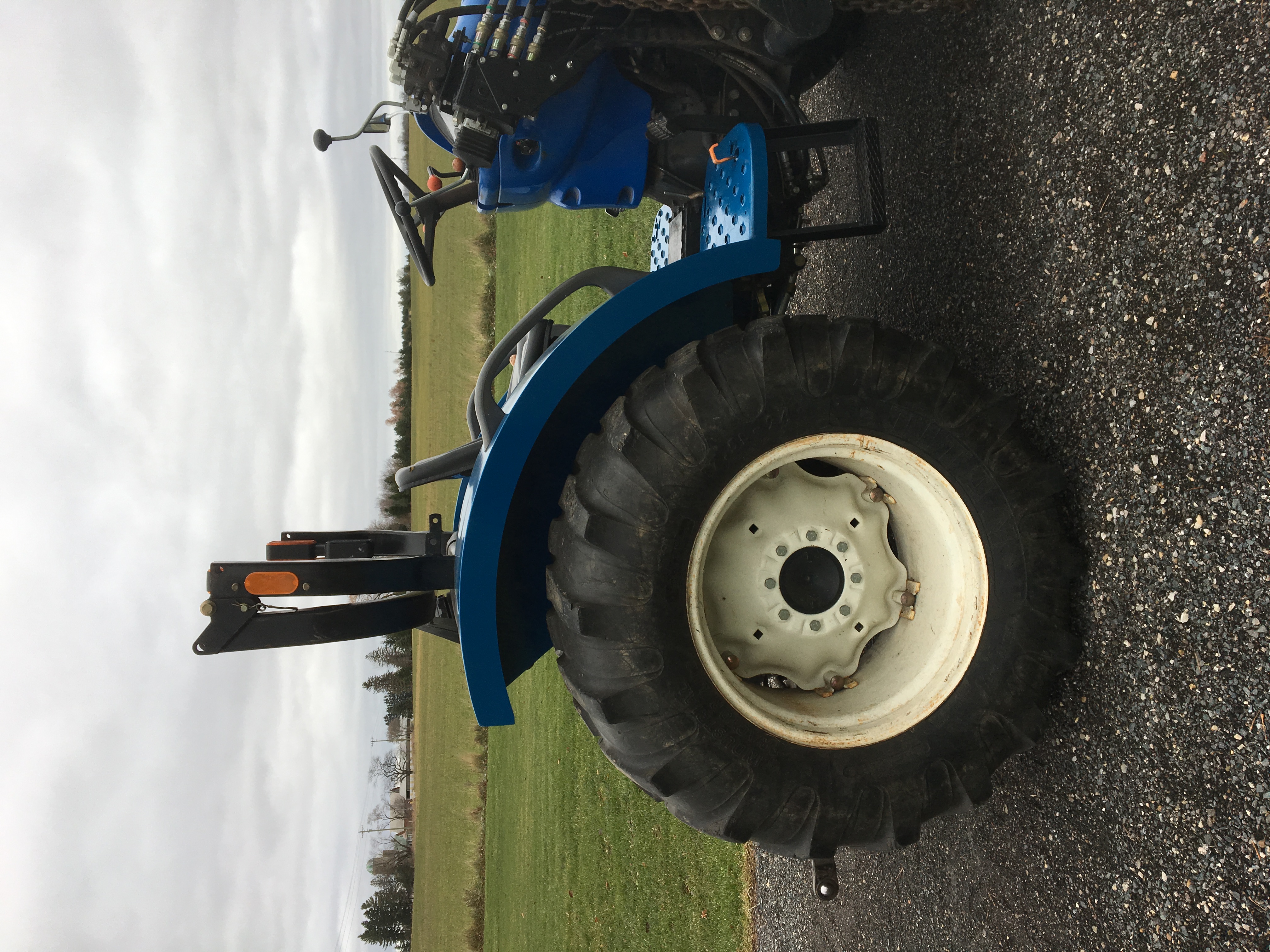

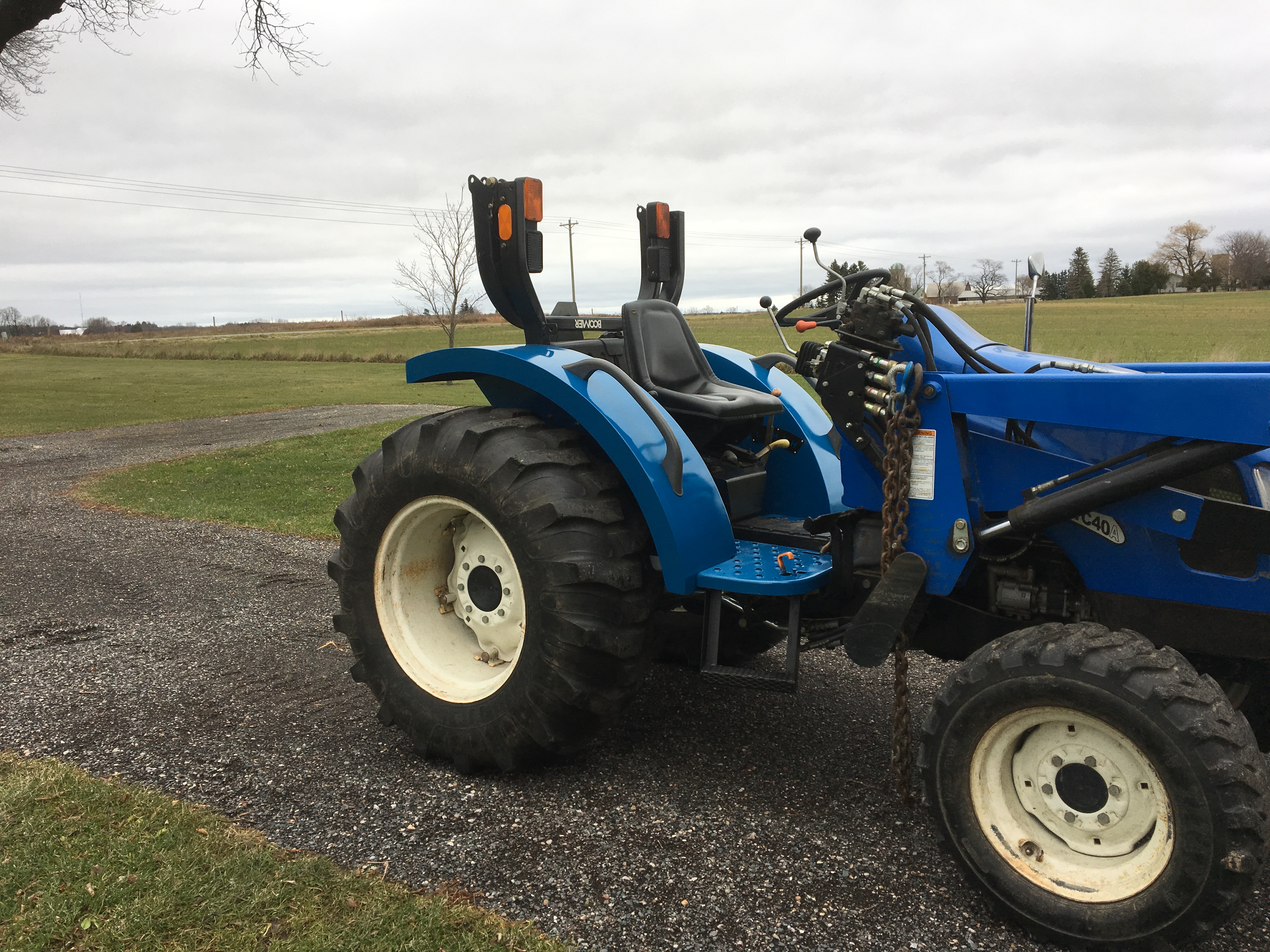

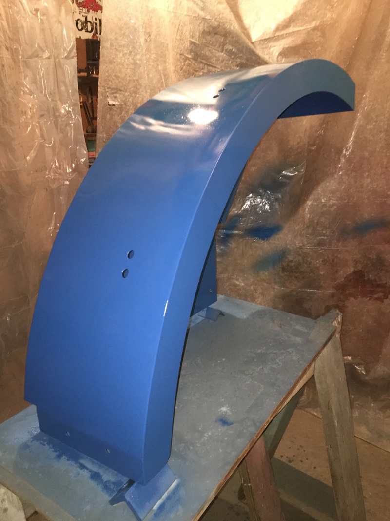

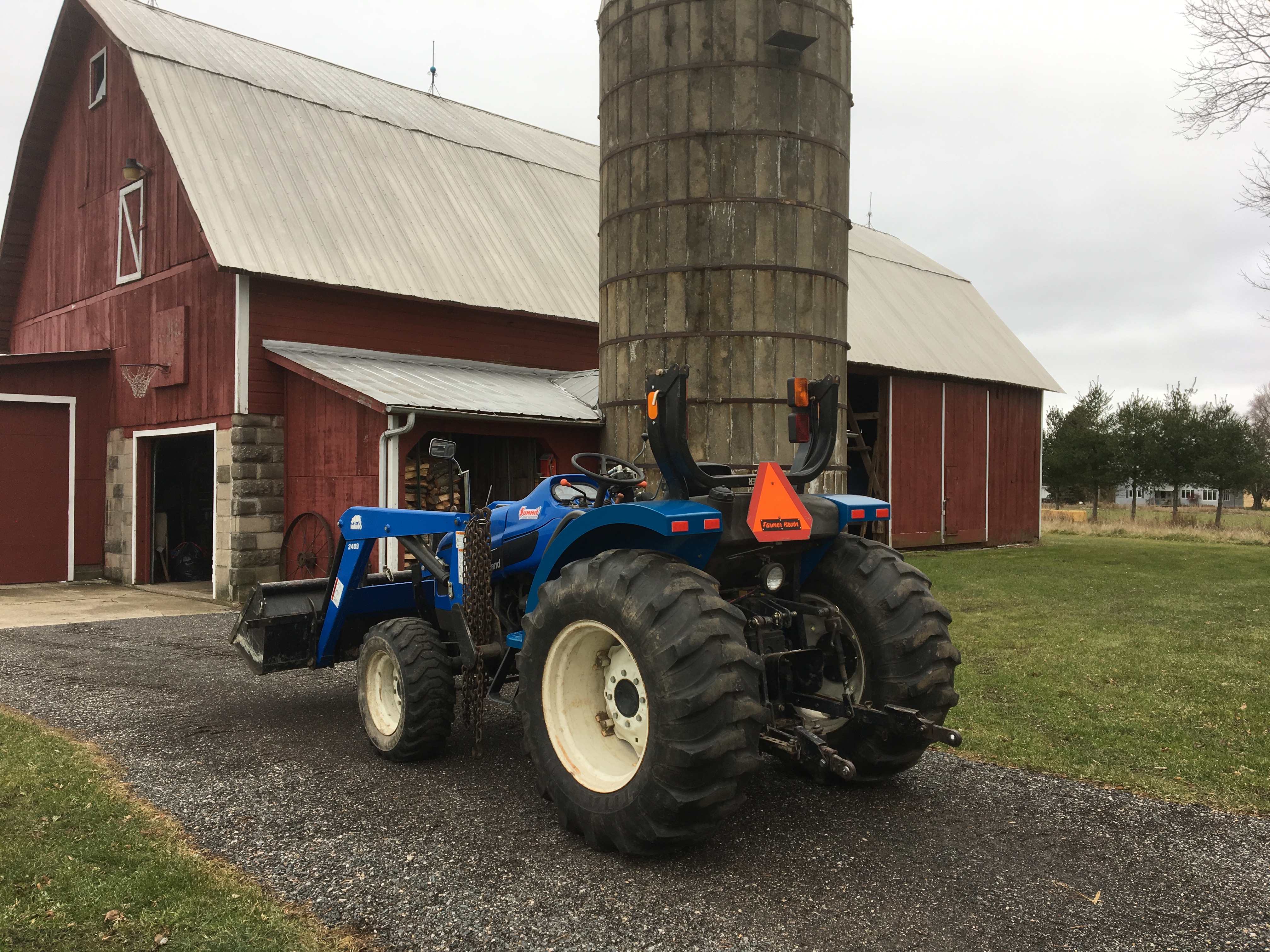

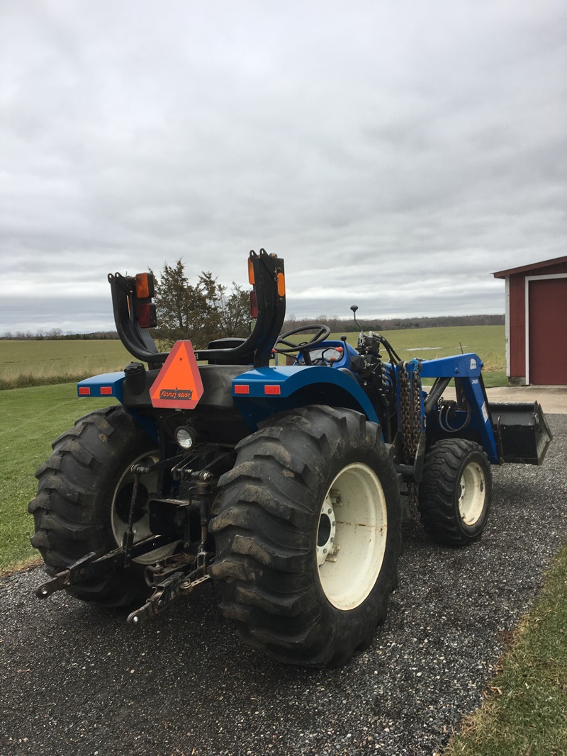

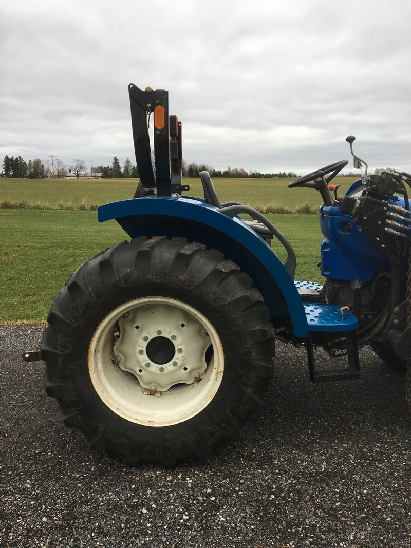

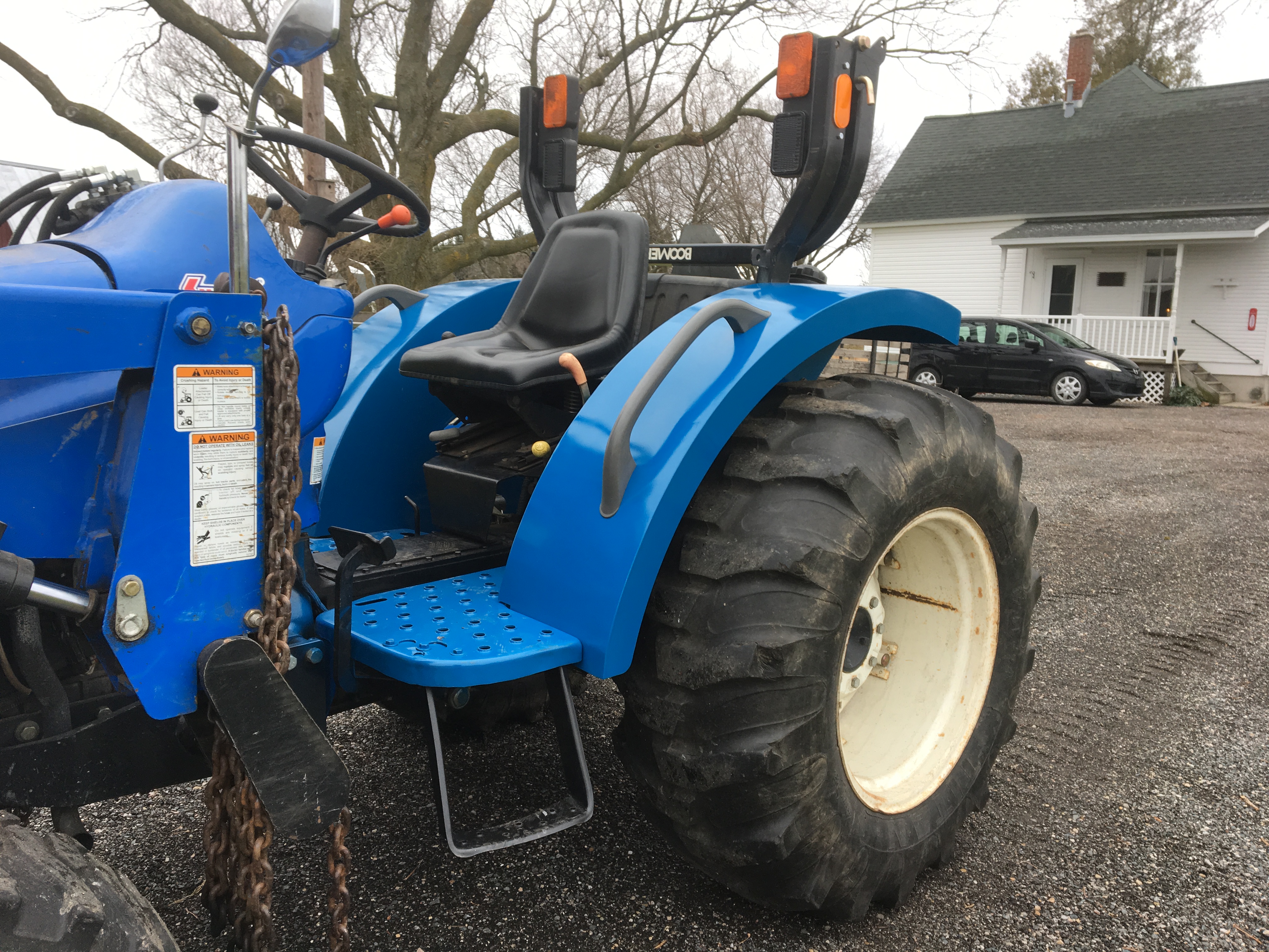

I have a 2005 TC40A, that I bought a few years back. Researching before I bought the tractor I was aware of the cracking issue (and expensive replacements). Mine had very badly cracked fenders when I bought it. I have used and perhaps abused this tractor, especially digging a few stands of Autumn Olive. This took further toll on the fenders. Decided to tackle my idea of metal fenders, so this fall I got together with a friend who has a plasma table, and he is a good designer and welder. We put our heads together and made new fenders out of 12 and 14 gauge steel. When you grab the hand rail to get on, there is no movement of the fender or deck. Turned out very nice I think. You will also notice in the pics that I moved the tail lights to inside the ROPS because I was tired of knocking off the lights when plowing through the autumn olive. IMG_4555.JPGIMG_4550.JPGIMG_4548.JPGIMG_4547.JPGIMG_4542.JPGIMG_4537.JPGIMG_4557.JPG

   / Fenders on TC 40 Cracked... #7
That is very nice replacement. Looks terrific!
You and your friend may have found a business opportunity if you can fab them for a reasonable cost.
   / Fenders on TC 40 Cracked... #8
NICE JOB! Those look waaayyy better than stock!
   / Fenders on TC 40 Cracked... #9
those metal fenders look really good! nice work. my 07 tc40da also has cracked fenders. my plan is to rivet some patch panels under the braces over the cracks and try and fab some additional supports to help make them survive. I am not easy on mine either clearing brush so I know at some point I am going to knock them around.
   / Fenders on TC 40 Cracked... #10
Those new fenders are one very nice, clean job. Way to go........ BTW - welcome to TBN and the forum Kevin. Nice offering for your first posting.
