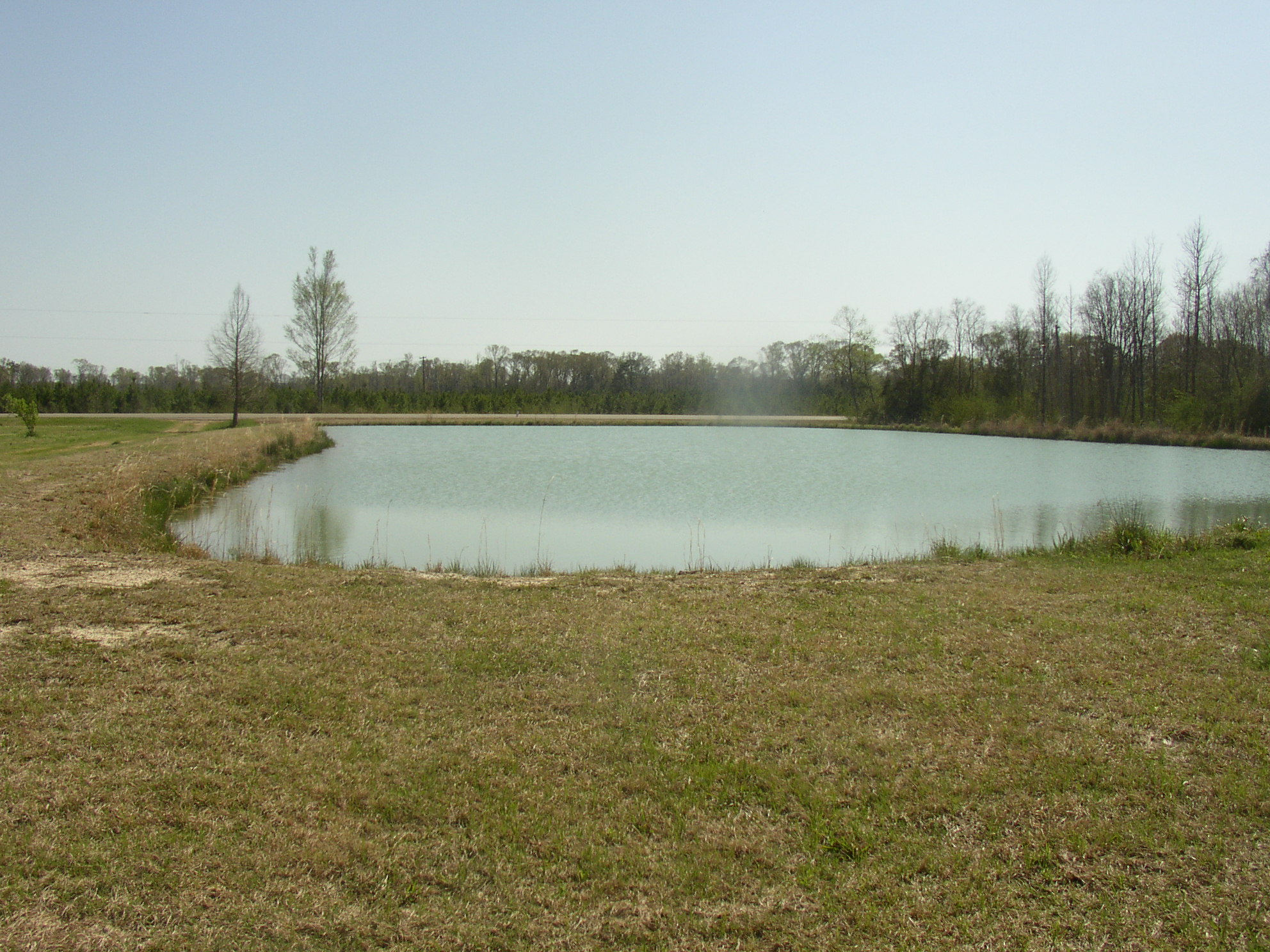

I have tried to restock my pond with catfish a couple of times but not much luck. I bought the property about 3 years ago and it had been stocked with catfish, bass and hybrid bream ( by the time I took possession of the property the bream were gone - fished out by anyone that wanted to stop by)
I have started feeding my catfish and taken out some real big ones. I have tried to restock the catfish a couple of times but out of 200 I only got about 20 that are still alive and feeding.
I am pretty sure the bass ate most of them. I am trying to provide more habitat for forage fish and have introduced fat head minnows for the bass. I have read where you should just kill off everything and start over but I really don't want to do that.
The last 100 fingerling I put in were 6-8 inches (about as large as I could get locally for a decent price)
I think if I could give them enough time to grow to get between 10-12 inches they would be fine.
My pond is gently sloped and I have included some pictures to show the overview and the bank.
So my real question is what kind of wire or fencing could I use to make like 20 X 30 pen to hold them and keep the bass away for about 6 months. My pond is artesian well fed and about 1 acre in size so really no oxygenation issues are involved. The depth of the area would probably not be over 36 or 48 inches

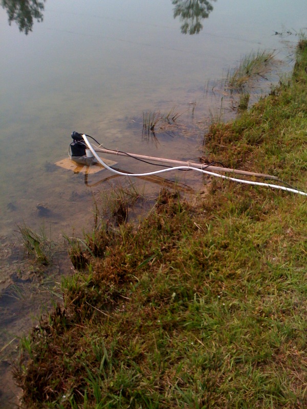

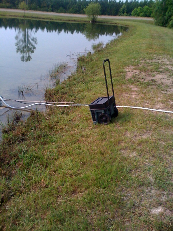

By the way the picture of the hose and sump pump is just something I use to water the top of my levee during the summer to keep the grass growing.

Check with your Agriculture Extension for aquaculture services and advice - they will be able to help. You might find that they use "baskets" made from hardware cloth for that purpose, but I don't know for sure.
   / fencing in a pond to protect fingerling catfish ? #3
Bdavis...build some boxes using 2x4's and hardware cloth...maybe 4x4x4 with a hinged top with a latch...set these in your pond ...off a dock if possible and start your fingerlings in there and feed them there until they are 6 to 8 inches long to survive and then let them go in the pond....We have a 2 Ac. pond that was stocked with bass, bream and catfish...way back on our farm not even visible from the road..but I caught many poacher back there with buckets full of my fish....We finally gave up...they sneak in through the woods....I can't sit out there 24/7 so the poachers won...I lost....Better luck to you

I would say to not be so quick to blame the bass or poachers. From my experience, great blue herons do a tremendous amount of fishing in shallow areas of my ponds. I have several catfish with divots taken out of their backs from being semi-speared by the herons. These catfish were over 12" long and I'm constantly finding big catfish bones/skeletons on my shoreline. Have you seen gray or white herons around your pond?
BTW: That's a sweet lookin' pond. An artesian spring fed pond is awesome. It also has a clear shoreline mostly free of trees.
   / fencing in a pond to protect fingerling catfish ? #9
Jim makes a good point, most of the fish I have lost have been to Great Blue Herons and have no love for them.
