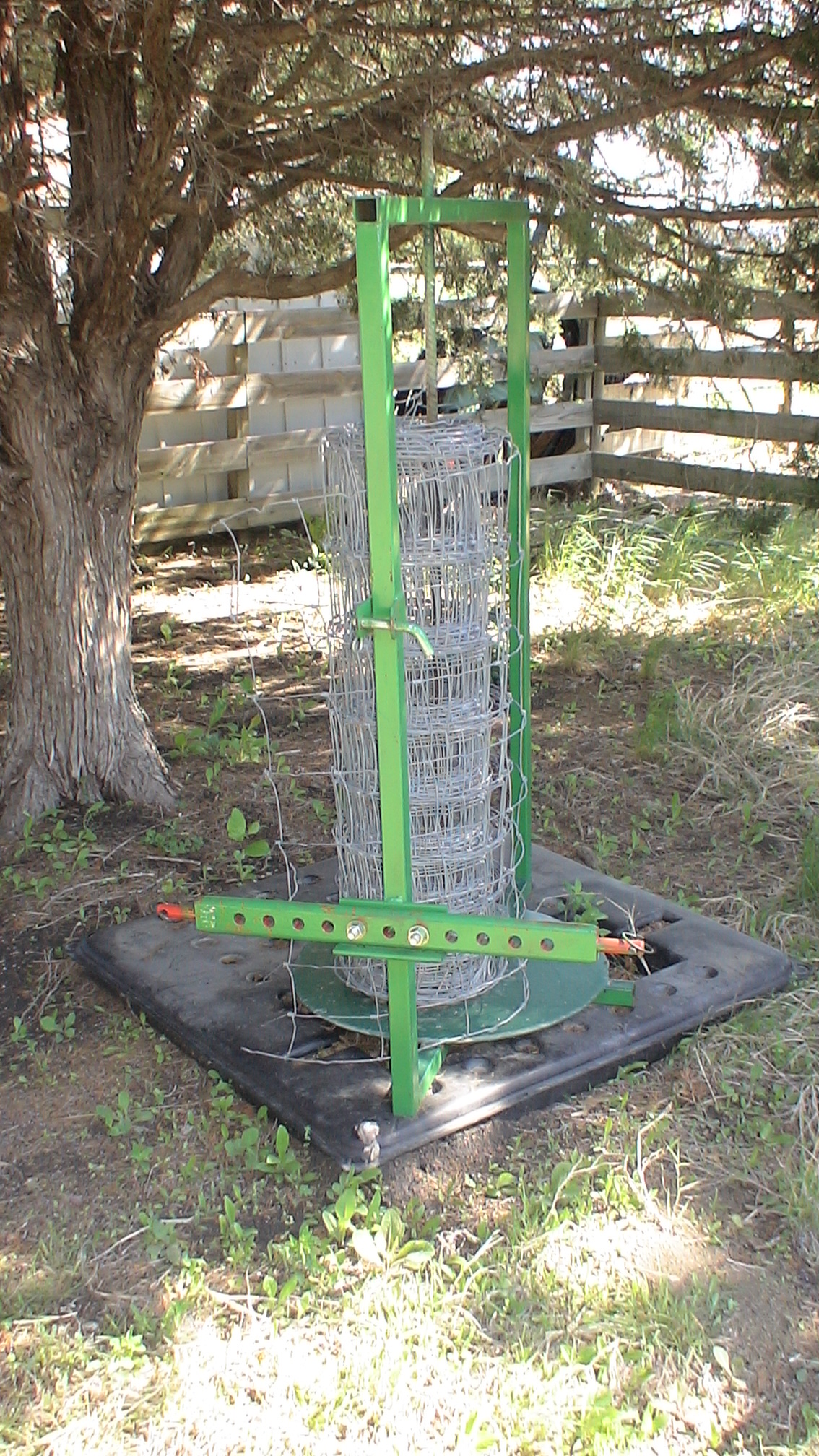

I build this one to help hang 1000 ft. of wire ,copy one at tractor supply makes life a little easer
   / Fence Unroller Idea #4
Copying a design is the sincerest form of flattery at least as long as the patent holder is unaware. Maybe even make a couple of small improvements just to be on the safe side.
   / Fence Unroller Idea #5
I was looking into the instructions to see how it was built and found some units use a clamp unit so that the tractor can clamp off the wire and stretch the wire. I was just not sure how the 2 pieces of angle iron would clamp together with the inside of the iron having a small radius and outside being square?
