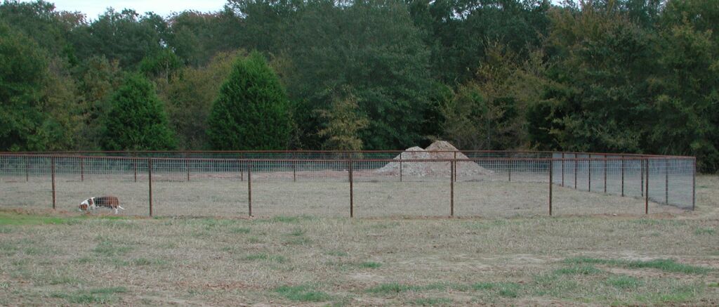

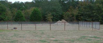

Well, it has been several months of working, and I am making a little progress on my fences. I have been unable to devote much time to it, but little by little I have been able to put in an hour or two here, etc. First is a picture of the fence I built for the dogs. It is an area about 100' by 160' and is fenced with 2 3/8" pipe posts and top rail, and then with 2" X 4" mesh wire horse panels. The panels are 5' high and are buried 6" into the ground to keep the dogs from digging out. This leaves the fence at around 4' 6". All in all, I am pretty happy with the way it turned out. Now all that remains on this fence is to paint it./w3tcompact/icons/sad.gif

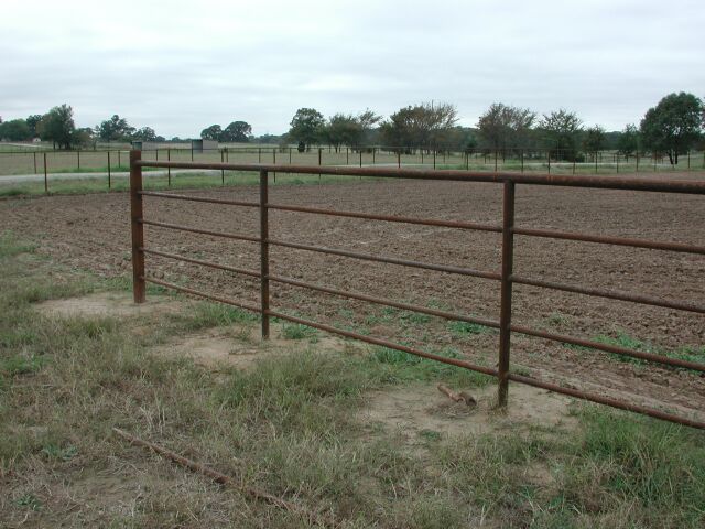

And here is a picture of the start of the arena fence. This one has the same posts and top rail as the dog fence, but instead of panels, this one has four 1 3/8" pipe rails which keep the horses in (I hope). The arena is about 120' by 300'. I am also working on the first pasture for the horses, and area about 350' by 400'. Plenty to keep me busy for quite a while. I really want to thank w_harv for all the insight and tips he gave me to make this project come together. p.s. w_harv, my welding with 5P+ is getting better every day.../w3tcompact/icons/smile.gif

Don't dawdle on the paint. Remember what I showed you about how the rust will come off the post and attack whatever's attached to the post.

Thanks w_harv. I have one more question for you though. A few of my posts have water in them, and I was wondering if you think I need to drill holes in them and heat them to drive the water out? I suppose that if they are sealed, they should not rust just because of the water (no oxygen getting in), but I wanted your opinion. Your help is greatly appreciated.
   / Fence Projects coming along #6
Evening Ron,
If the posts are open at the top I wouldn't worry about it. Freezing will water will always take the path of least resistance. Surely straight up is easier than going through a quarter inch plus wall of steel like in your posts.
If the posts are closed, they filled up with water before you welded in the top pipe, the same principle holds. The space taken up by the expanding water while freezing is only going to create pressure in the air filled portion.
I wouldn't worry about it. More importantly I sure wouldn't drill holes in my posts. They're going to have a dull enough life without being intentionally bored./w3tcompact/icons/laugh.gif

Actually Harv I was more concerned with the water causing additional rusting than I was with freezing (I actually had not even thought about that problem/w3tcompact/icons/sad.gif). Sorry to hear about how busy you have been, but I guess in the current economic conditions, being busy with work is not an entirely bad thing. I hope you can find the time to get away and come over for the December Trades Day.

Hmmmmmmmm, rusting, again I wouldn't worry about it. By the time your tubing, new high carbon drill stem, decides it's time to give in and rust the water will be gone./w3tcompact/icons/laugh.gif
I would paint the outside asap though. That is important not only rust will attack the pipe but also everything you attach to it. The pipe will hold out for thirty years or more. The other stuff not so long.
I hope you're not like me. Painting is one of those chores I've found the perfect tool for, check book.
Seriously, for your pipe there are many options. One of course is the mitt. Another is the foam rollers. And another is the pipe rollers that consist of three little rollers in an arc top and bottom. If you have to paint the pipe and there's nothing welded to it like you have around the dog pen, the little roller is the ticket in my book. Mostly because you can clean it and reuse it. The mitt and the foam rollers are one shot items.
Even better is a HVLP sprayer. They lay down plenty of paint (you'll never find rust under a run). You aren't killing the environment like you can do with regular spray gun and compressor technology. And they are a lot easier than a brush when you're doing something like the dog pen.
