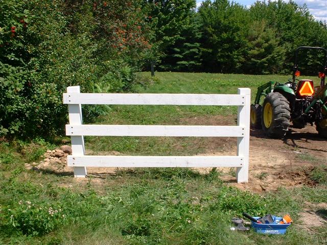

Paint them. My wife and I have been putting up fencing and we are painting the post & rails with "WOODSCAPES" 100% Acrylic water based Stain.
The first pic. is our first section. Second pic is of my son setting on the last section we put up. Have 16 section up and hundreds to go:(
