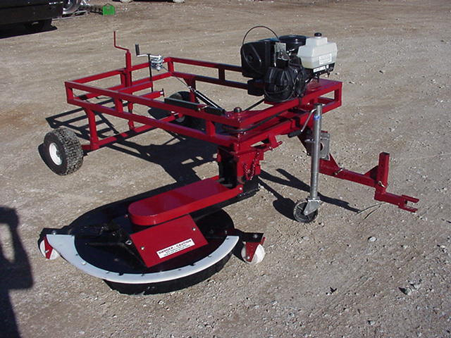

I've never seen one of these before. . . .

Trailer this baby behind your GT or ATV and ride the fence line. When you encounter a post, the mower deck swivels in and around the post. Once you've passed the post, it swings out and under the fence. Somebody was thinking. . . . .

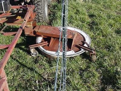

Another view - in operation. . .

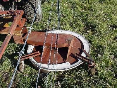

And another. . .

I bet that would be better than useing a big trimmer.Does it have a clutch of some type if a stone etc.. got caught?
/ Fence Line Trimmer #7
That looks like an upside down version of what I think is called a flail mower.
/ Fence Line Trimmer #8
Check out Knight9's post in <A target="_blank" HREF=http://www.tractorbynet.com/cgi-bin/compact/showflat.pl?Cat=&Board=off&Number=56107&page=&view=&sb=&o=&vc=1>this thread</A>. He posted a link to a picture that shows something similar.
/ Fence Line Trimmer #9
Looks like a real handy implement! What brand is it and who sells it? What's the price? I've been contemplating trying to fabricate a 3pt hitch trimmer that runs off the PTO, but haven't gotten anywhere with it yet.
/ Fence Line Trimmer #10
If you're into making your own, check out <A target="_blank" HREF=http://www.thestgeorgeco.com/catalogue/Farm_Forestry/Orchard/body_orchard.html>this web page</A>. About midway through the page they sell an optional swing arm side cutter mowing head similiar to the one on the above attachment.
/ Fence Line Trimmer #11
My neighbor bought one that started with a V maybe valcom?
Anyway he hated it and tried to sell it to me. I used it a few hours and decided not to buy it. It worked OK on wood post but not on T post. I still have several T post that are "not straight" in the ground and the wire is stretched. You have to go real slow and if you don't have HST like me your clutch foot gets really tired. It works better it you make a pass down both sides of the fence row instead of getting close so it cuts both sides. It seemed to work OK around trees as long as you kept the height above the roots and went real slow.
