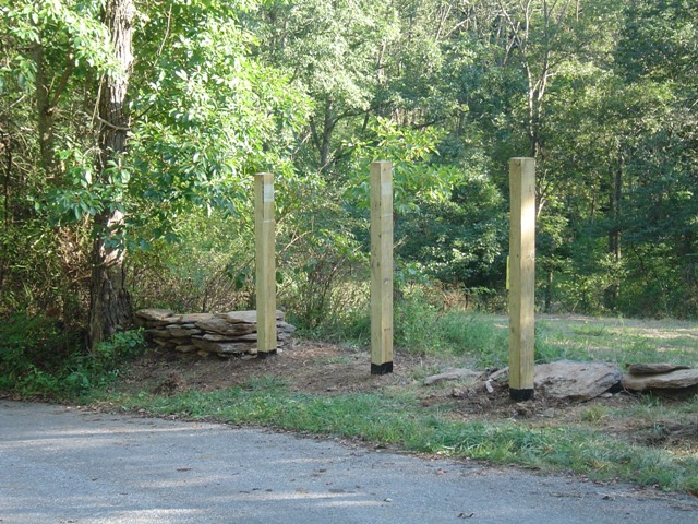

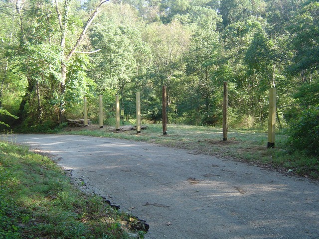

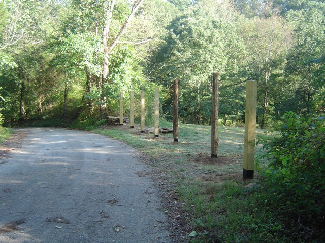

I rented a 12" auger for the 3 point on my 7800 for this. The 2 posts that frame where the 14' bar gate will go are black locust. They were cut from my neighbors property. I still need to skin the left one with a hatchet. The rest are 6 x 6 .40 PT. All are at least 24" in with a 60lb bag of concrete. I wanted 36 inches, but with the rock around here - it's more like mining than digging! I'm adding a small field stone wall to each side for fun. The rails will be 6" wide oak from an old cattle barn on the property. Once the rails are in place, I'll cut the posts @ 5' for the 6x6 and 6' for the locust. Any ideas on what to use to get that stained black look? I've heard that used oil and diesel fuel work, but maybe something more..... in a can???
I feel your pain. I used to live in newberry township, down by the river. They have what they call ironstone in your area, along with the ever lovely limestone. Good luck with the digging. In my current neck of the woods, we have shale, sandstone, limestone, and mountain stone - oh yeah, and coal. The easiest to go through is the coal, then the shale - unless it is the harder shale, what some people call bluenose shale.
Did you have hydraulic downpressure on that rig? If not you may spin your bits to the nub. The skidsteer guys up here all have hydraulic downpressure, but it won't go through the hard stuff. You need much bigger equipment, and sometimes you need diamondbits and water.
Just my .02 in case you don't already know, if your drysetting that stone, make sure you stagger the joints and get some big base rocks. If you backset the stone and put in a little filler behind it it should last 100 years or so. Most of the other ones I have seen down there have been around at least that long.
