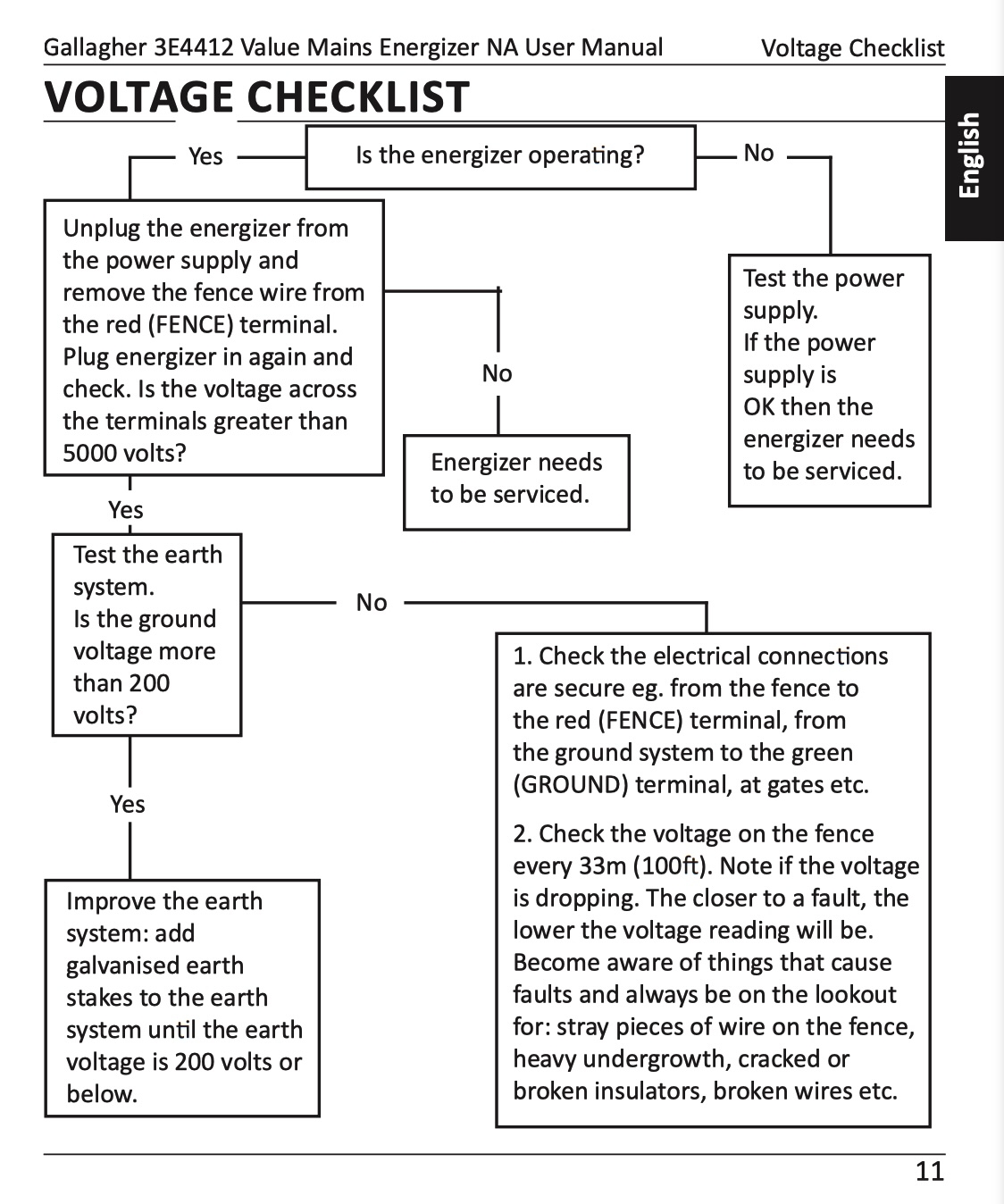

Hello all, hope everyone who is in the way of this hurricane is doing well and staying safe. Ok, here is my deal. I have been working on cleaning up and redoing some of my fence. I currently have a power wizard low impedance pm600 I believe. It says max output is 6 joules. The charger is 10 years old. I purchased a new Gallagher m800 with a max output of 8 joules. So, my fence checker does not read in joules it reads in Kv. So with old charger I am getting 2.4 Kv at charger and 1.5 Kv at the end of the line. With new more powerful charger I am only getting 1.4 Kv at charger and 0.2 Kv at the end of the line. I know I need to clean more off and plan on when storms are over this weekend. But why am I getting more power out of my old charger when the new more powerful one is putting out way less? I have three six feet grounding rods 6 feet apart. Thanks for your help.

  • Finally, what is the voltage reading at the charger when the chargers are connected to ground, and not the fence?
Off the cuff, 2.4kV at the charger sounds way low, and I would like to understand why.

Should be >5000V.

What does the tester say when just the earth ground is connected, not the red or hot leg?

I think that somewhere you must have some pretty good shorts to ground. That could be either vegetation or cracked insulators, but whatever they are, they aren't small. Have you walked your fences checking the voltage as you go, looking and listening for arcs (sparking)?
I put in some switches about a third of the way along my fence system that help me quickly find shorts. That way, I can open the switches, turn on the fence, check for good voltage, and then add the remaining pieces to find which stretch of fence has a problem, and sometimes, especially after a storm, the answer is all of them.
