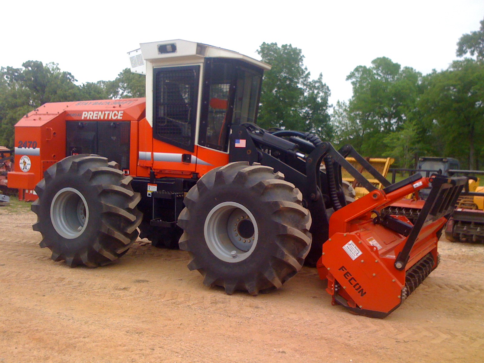

If you go to the Prentice wesite the 2470 is a feller buncher not a site prep machine. Lynn Hendrix uses a 2470 because he has found that it is cheaper to buy this one and then make his improvements. The Tigercat track mulcher is just a feller buncher with a grinding head. The only thing that I can think of will be the increased heat build up created by the nearly 100% cycle that mulching has.
