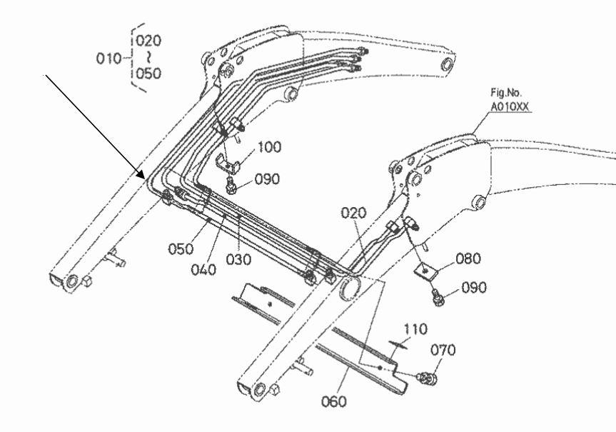

I posted a thread about this in another part of the forums. My dealer will be picking up the Kubota at the end of the month, but I want to try one more time to fix it myself. Here is a quick rundown of the issue.
I had my forks on the tractor. I was facing downhill with the bucket fully curled forward and the forks were partially in the ground. The tractor lurched forward and one of the metal lines that are located inside the FEL frame burst. I went to order a new line and they are backordered at Kubota, so I went to a hydraulic shop and had one made. They did a very good job of replicating the bends of the line. I replaced the line, but now the bucket curls back really slow. Everything else works fine. I disconnected and reconnected the quick disconnects and also disconnected and reconnected the rear hydraulic hose for the BH.I also crack open the lines that go to the piston for the curl and let some fluid leak out although this system doesn't need to be bled of what Kubota told me. I topped off the SUDT and have been operating the curl quite a few times to see if it would works it way out. Is it possibly that the seals in the curl pistons failed when this happened? There is only 179 hours on the machine.
The one thing I did notice, if I curl the bucket fully forward and put the edge on the ground and curl back, it will raise push the tractor back, so it still has the strength, it is just VERY slow curling back.
I'm out of ideas. I don't want to send it in for service if it is something I can fix. Any ideas? Thanks.

I found a dealer that has the line in stock. I ordered it. The part is $52 and shipping is $85. It's in a large box. I am going to try to replace the line that the hydraulic shop made with the OEM from Kubota and see what happens. I'm out of idea's at this point. That is the only difference.
   / FELL Bucket curls back very slow #5
The “only” difference is you over pressured the system so severely you split a steel hydraulic line.
I’d test the cylinders........
I'm going to test them. I'm wondering if Kubota would cover this under warranty if I do let the dealer look at it? It is still under warranty until August 2019. Those steel lines are so thin walled. When I had the new line made, even the guy at the hydraulic shop said that they were very thin walled. I still want to get the OEM line on it so the dealer doesn't blame the manufactured line.
On the testing procedure, what would be a good way to cap off the line going to the cylinder I would be testing?

Call your hydraulic guy who made the hose. He will have caps. But by the time you fiddle around with isolating one cylinder it may be faster to just pull them both and have them bench tested. Or use your machine to “bench test” them once they are removed.
   / FELL Bucket curls back very slow #8
Not sure if its covered under warranty. But it sounds to me that you had the fork tips in the ground, with the forks vertical. Any forward or reverse movement puts incredible stress on the loader and cylinders. Likely if the tractor lurched the other way, you might be replacing two bent cylinders.
If there was enough pressure to pop a metal line, there could be internal damage to the cylinders (likely) but also to your loader valve.
Best of luck.

In a nutshell, that is exactly what happened.
Could I switch the hydraulic lines so that the raise and lower lines could operate the bucket curl just to test the cylinders? I swapped the the top 2 lines which go to the curl cylinders with the 2 lower lines that go to the raise cylinders, but didn't get the results I was looking for. Is that even possible? That may be a good test to see if the curl cylinders seals were damaged.

Probably not. Most machines have regen or fast dump on the curl circuit. It applies full pressure to both sides of the cylinder. As the rod end is smaller than the cylinder end (the rod takes up space) the cylinder end overpowers the rod end & it extends. The extra fluid from the rod end makes the cylinder operate faster than it could otherwise. As you really dont need much power to dump thanks to gravity the power loss doesnt matter. It also keeps both ends of the cylinder pressurized so it doesnt suck in air. There are plenty of posts on TBN about floppy bucket syndrome, which is caused by sucking in air.
My old Kubota L3200 only had regen dump. My new L4060 has regen dump & then a power dump if you move the joystick all the way over. Surprisingly I rarely use or need power dump.
Because of regen you cant swap hoses. You can put a diverter on the curl circuit, but it wont run a hydraulic motor or single action cylinders, such as the 2 opposed ones on most snow plows. As the cylinders are the same size regen cant overpower one over the other. The plow will only sngle 1 way & you cant get it to ever move back the other way.
If your loader valve has power dump you could use that to test with, but you need to find out if its regen only or not.
