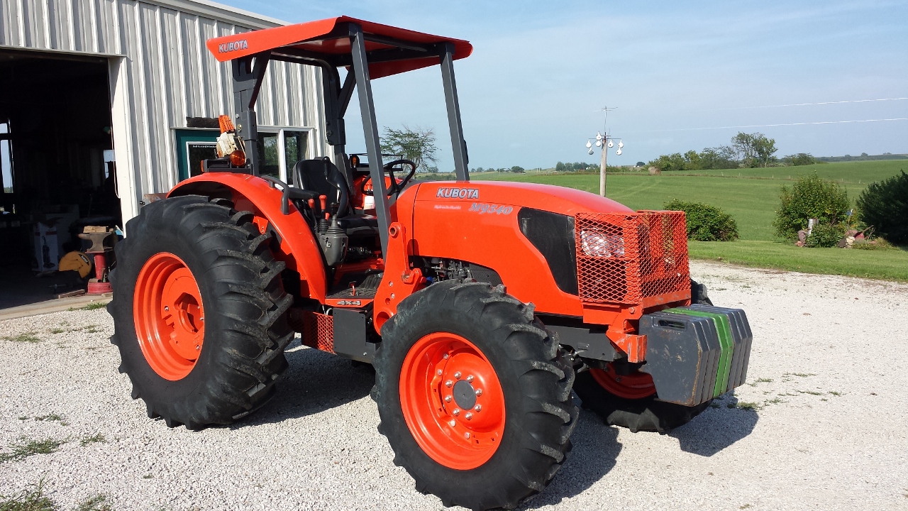

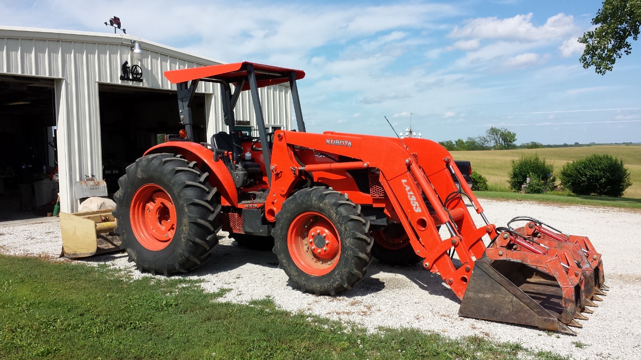

Mowing is the only task I remove the FEL for. "Mowing" as in Brush Cutting with a 10ft cutter. If just quick use of the BB or other attachment, I leave it on.
I hate Brush Cutting with the FEL on. Really gets in the way. Changes the dynamics/balance of the tractor. As Terry explained, I too use suitcase weights on the front of the tractor for weight.
Here's a couple comparable pics. Notice how much more compact the tractor is without the FEL.
