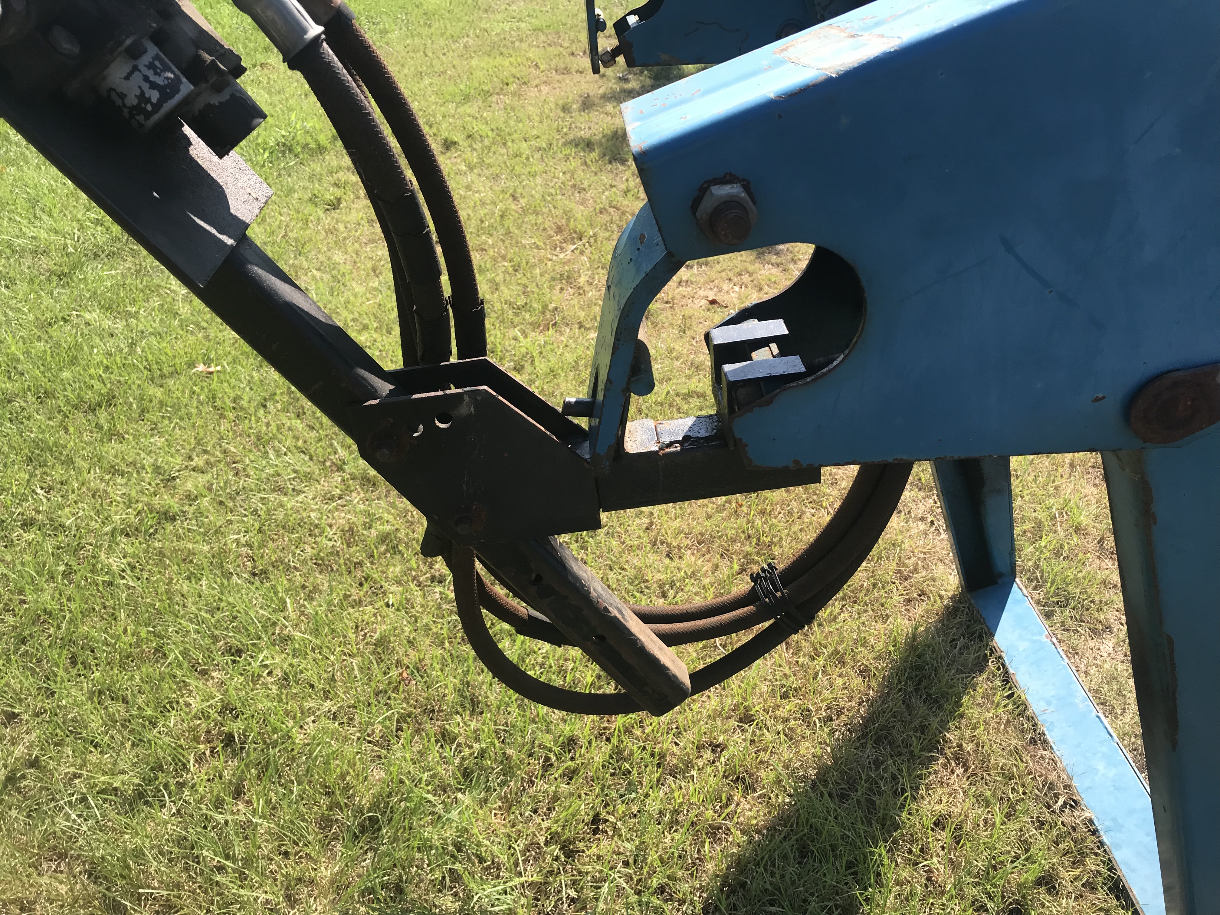

For many years since I have owned this tractor, I have had to manhandle the FEL valve. Removing the FEL I had to climb on the tractor, lift the heavy valve and slide a square tube into a square hole on the FEL frame. Then reverse to install the FEL. I designed this holder in my head but never made it. Until one day I said I am too old for this.
So I made this valve holder. Now I just slide the valve off the tractor and slide it into the holder. All while standing on the ground. I should have done this years ago. Thought I would post a picture.
