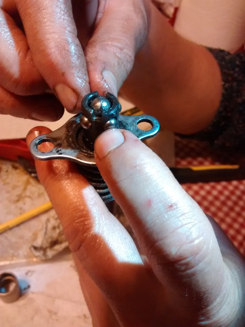

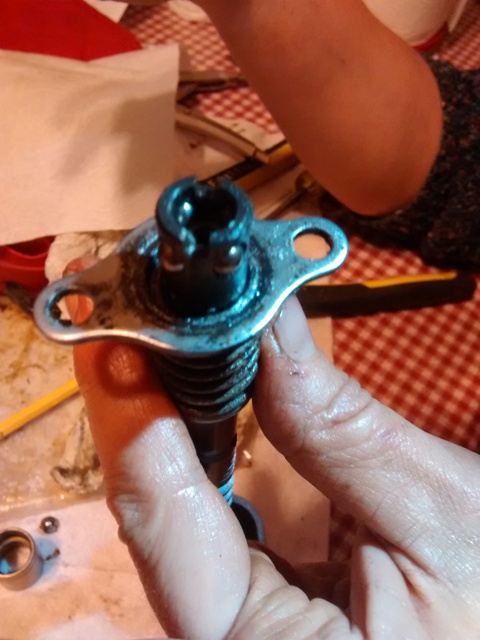

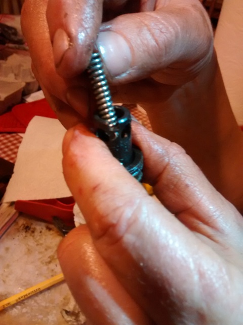

OK, I went out and took the valve apart in the field. Disconnected hydraulics, took off outer lower cap, and disconnected the pin at the top, slid out the entire shaft, and took that into the house.

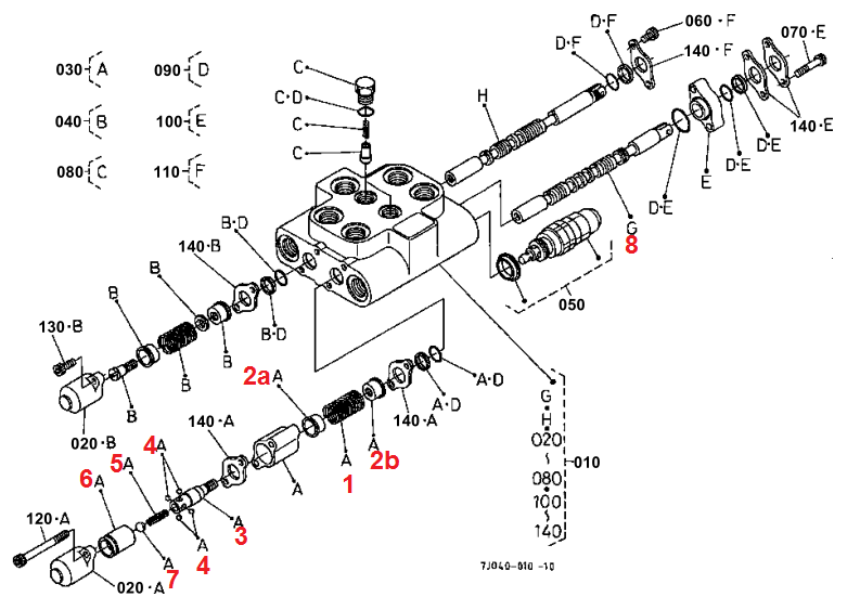

I can't see that the detent balls could be the problem, as it seems there's only one way to reinstall, according to the parts diagram (below). I took off the inner cup (red 6), and bearings (red 7 and 4) came out. Pulled out the tiny spring too (red 5). All seemed in working order.

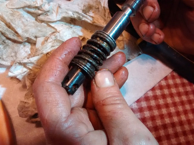

I wondered if possibly the problem could be the big spring on the shaft, seen in photo 'Valve1' (or as red 1 in diagram). It seems a bit crunchy, although both ends (red 2a & 2b) move on the shaft. I don't remember if I took that apart last time, but I don't think so. The main shaft (red 8 in diagram) is a bright metal, which the detent holder (red 4) is a darker metal and appears to be a separate part, so they must come apart, but I didn't want to force them. Could 2a & 2b be jamming on the shaft?

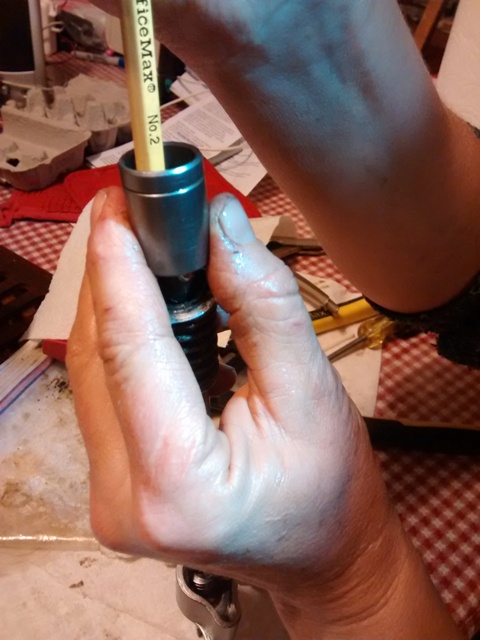

To put back together the bearings, my understanding is that the cup holds in the 4 bearings, which holds in the big bearing, which holds down the spring. The photos show this process.
valve2 -- Replace the spring
valve3 -- Put back the 4 small ball bearings, using grease to keep them in place
valve4 -- Set large ball bearing on top
valve5 -- Put cup just over bearings so bottom edge rests on the 4, take a pencil eraser, and push the ball bearing down with one hand while pulling the cup down quickly to capture the 4 bearings just as the big bearing passes them.

Spool valve should operate without balls & springs installed BUT valve will no longer be self centering to neutral position. One will need to manually move control handle to neutral position.
