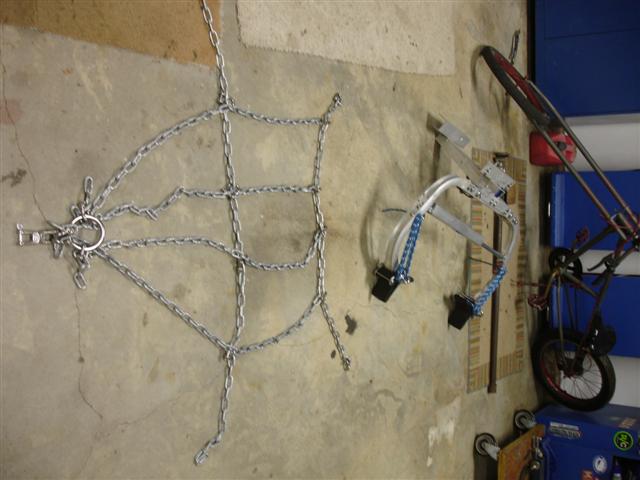

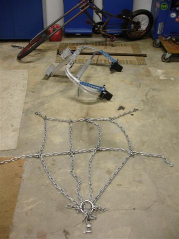

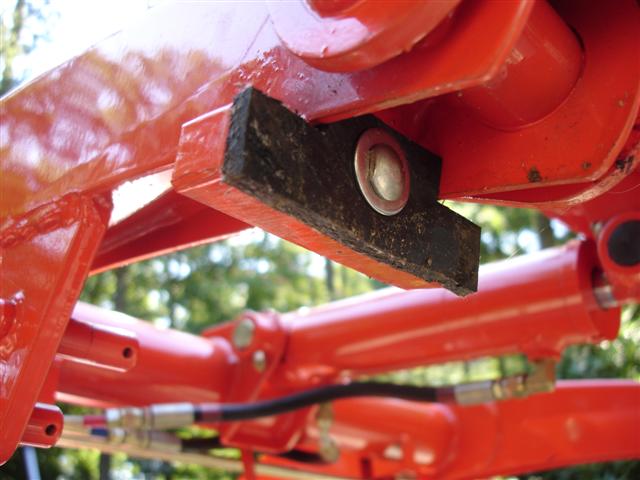

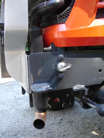

The bumper for the FEL stop eliminates the slam when you dump the bucket too fast. It is fiber reinforced rubber kind of like a tire. Also made a rock sling out of #43 1/4" galvy chain. Can be shaped to the rock and has a slip loop at the top to cinch up tight when you lift.

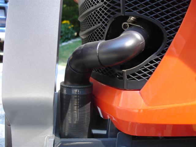

Also a shot of the re routed exhaust pipe which used to blow all over the fel arm and back at me. I used 1 1/2" copper fittings and high temp black silicone tubing which can flex if it hits a rock or stump. Also a shot of the fel eye which I finally got around to painting.

Pretty cool ideas...I especially like the rock sling - can't say as I would have thought of that.
Any idea on what, if any, backpressure issues are created by extending the exhaust with the curves?
   / FEL stop bumper
5030,
The diameter of the new elbows is 1/4" bigger than the factory outlet, and the flex pipe 1/4" on top of that - gut feeling is that unless the engine is pegged, the flow should be ok.

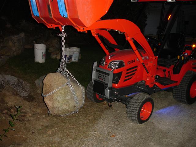

Nice Work:)
Really curious about the rock sling -- trying to figure outhow it is put together and functions on the three point -- I have seen a metal frame one on another forum but would love to see more detail on yours. Cannot quite figure it out:eek:
   / FEL stop bumper
Studor,
Rock is rolled onto the chains, furthest two loose ends are linked tight around near the "bottom" of the rock, next two around the middle, the two inboard chains running front to back are linked always to the ring, and the two outboard lifting chains slip throught the ring cinching the rock tight as you lift - they are both attached to a swivel. The chains are attached at all intersections and ends with shackles making the assembly very adjustable and easy to trap any shaped rock up to two + feet in diameter - as big as any I have and also at the limit of the tractors capacity. I lift with the bucket or BH, not the 3ph. Am looking into getting a small trailer, something like the Polar black poly one in the Northern tool catalog. Does anyone out there own one? - hard to tell how sturdy the plastic is from just a picture.

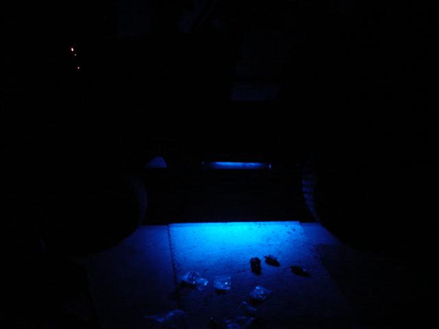

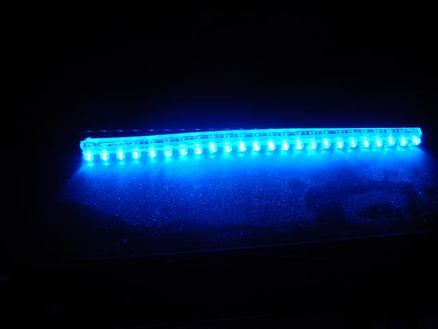

Couple pics for W.A.T.T. - will take some better shots in better lighting later - 2 banks of 14 blue leds on each rail and the red is my avatar

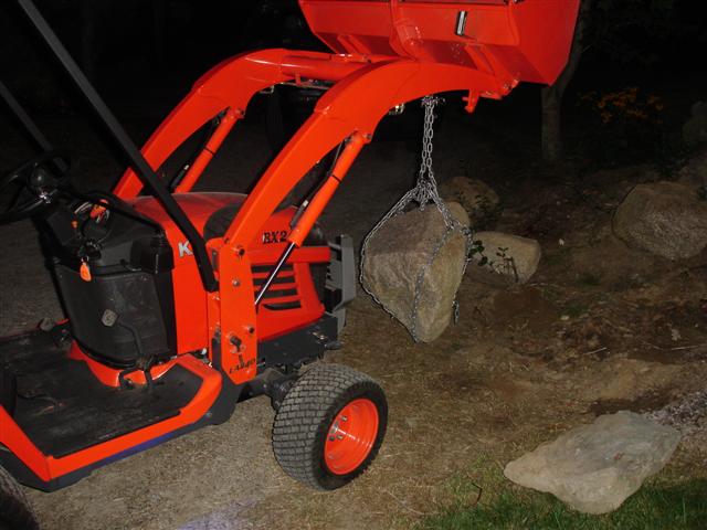

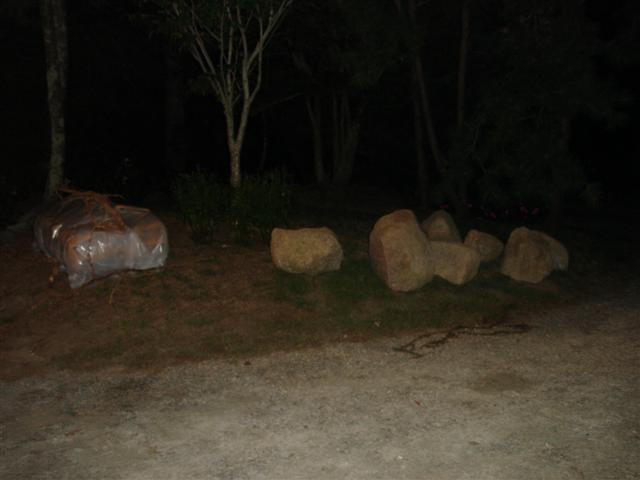

Some pics of the rock sling in action. Am finishing the stone wall on the side of the driveway. These were pulled out of the bank the wall holds back by the back hoe.
