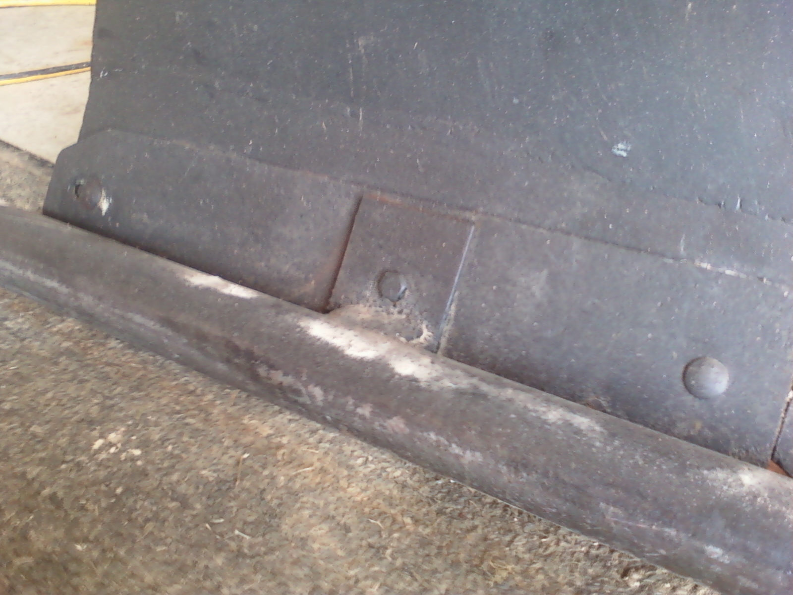

You don't have to slit a steel pipe. Just weld tabs on it, and bolt it on.
