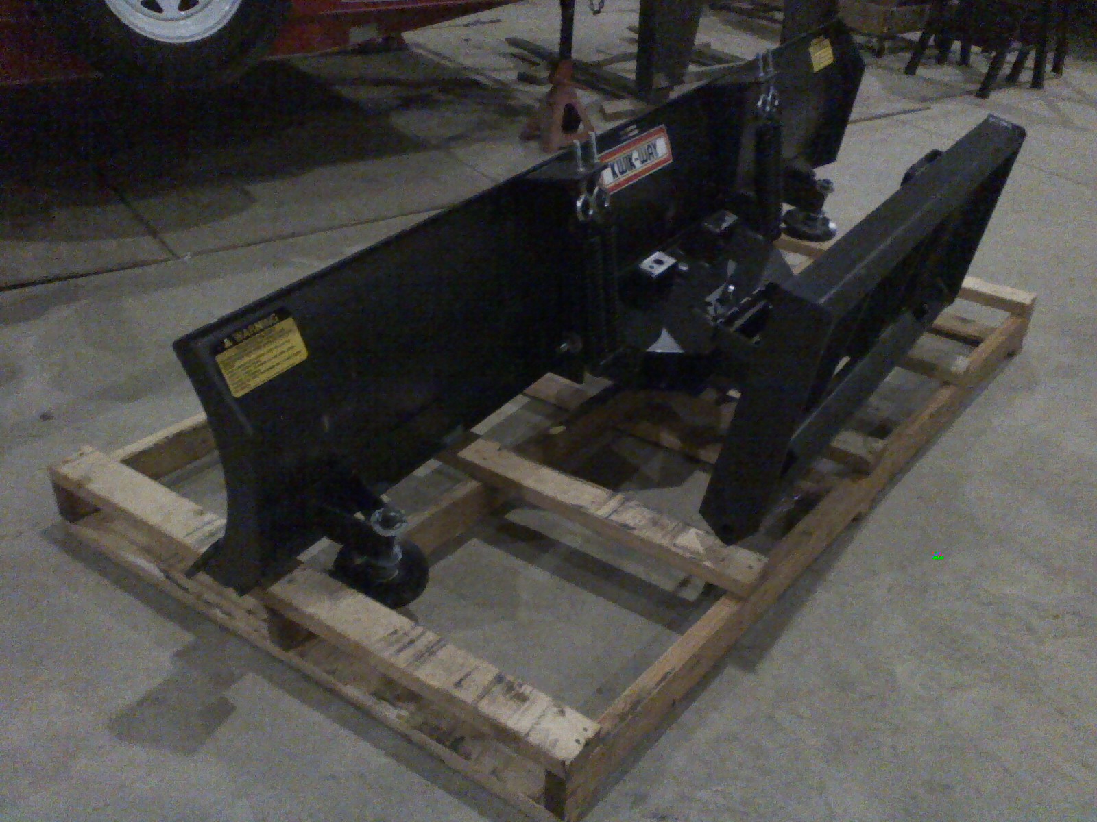

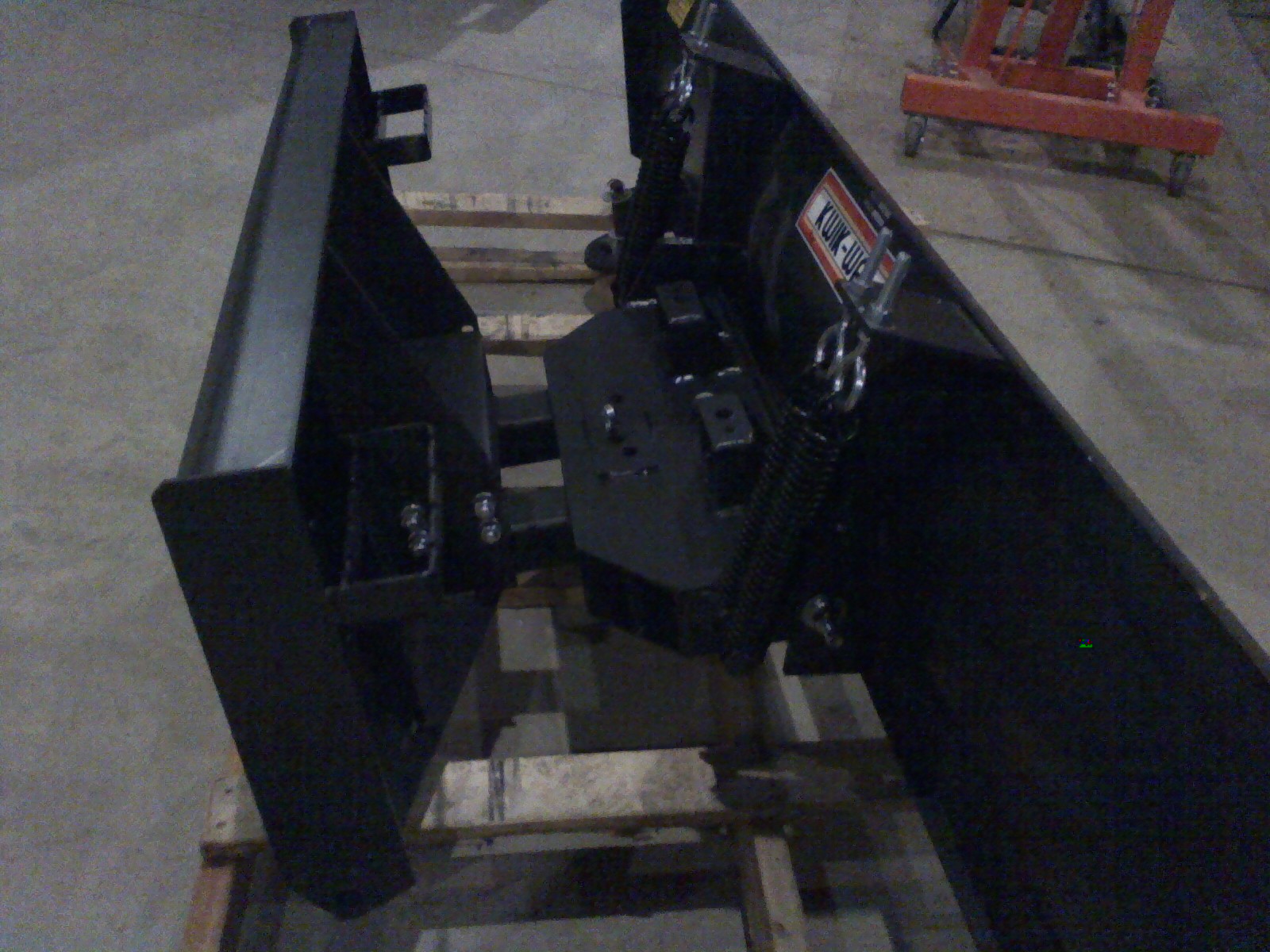

Once again I am turning to you guys for help
After guidance from this forum I have decided that I will want to put a remote on my tractor so I can hydro angle the blade I buy. But I am not in a position to put out all that money yet so I decided to get a manual angle blade that can have the hydro option added later. I am down to 2 blades. one is 400 lbs and the other is 650 lbs. Pricing similar.
My question is what are the lighter/heavier weight advantages? Does one plow better? Is one less likely to tear up my FEL arms etc?
Tractor NH TC45D QA FEL

650 pound snow plow ? how big is it?
The heavier plow would clean down to the surface better, not sure which one would be less wear for your FEL but am guessing the lighter one, which is not light by my standards either.

My 84" snow blade weighs in at 635#. I think they need to be heavy to stay on the ground and not float over the snow berm.

I am not familiar with the NH nunbers. If it is a compact/sub-compact putting a snow plow on your FEL bucket pins does not sound like a good idea. If the NH is a heavy duty FEL that will lift and push a lot you are probably OK. The smaller tractor manufacturers offer a a snow plow that attaches to a proprietary front quick hitch that puts the load direct to the frame not the FEL arms. You then use the FEL Hydraulics. Just priced one for my Kubota BX 25. The 60" blade is $1200 and the QH is $600 plus shipping. The Kubota blade assembly comes equipped with cylinders to lift and angle. The QH also accomodates their Snow blower and Broom units. I think I will buy the QH first as it will be a correct fit to the tractor and I will not have to adapt. Then I will look for a used blade that I may have to adapt to the QH. The dealer was quick to point out that the capacity of the blade is limited to snow, sand, loose gravel and loose soil and not to used as a bulldozer. Here again that is a function of the frame capacity and the HP available. I have seen some large tractors that bull doze pretty well but not with the FEL unless it is a 4 in one type.
In the interim I have set my BX25 FEL up with clamp on with skid shoes (home made) and will use that if we get 6" or more snow at once. Less than that and I would not plow anyway. Big mistake folks here in Puget Sound make is scrape down to nothing and then wonder why the remaining ice layer is slicker than a pack of snow. After I get the QH I bet I find other ways to hook something to it. Thinking maybe adapt a junked forklift mast to it as that puts the load on the frame not the bucket arms. Some more winter projects.

They are 8' blades. I think the heavier one is also designed for moving dirt which I am not interested in for my FEL arms.
