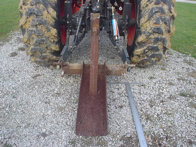

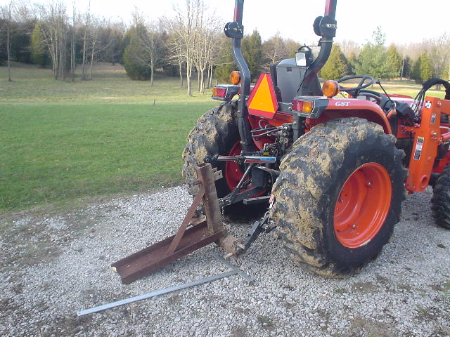

Sorry for the delay in taking these pictures of the 3PH mounted root cutter. Recall this channel started out bolted to the FEL bucket but was difficult to see with the bucket in the way. If you stick it out far enough to see, you lose your lifting force. Otherwise, you have to stand up to see, or tilt the channel down at a steeper than necessary angle and look under the bucket.
This picture shows the attachment in about the position it would be used. The square on the ground is 4 feet long to give an idea of size. The channel was welded to what used to be a home made bale mover. Its reinforced with a small piece of angle iron as a hypotenuse.
I used this to pop out honey locust trees (thorn) up to about 3 inches in diameter in heavy clay. In Indiana, these are dense, tough trees with a tap root. The idea was to get out most of the root ball so the root suckers wouldn't grow. The way it worked out was that the sharpened edge cut a small percent of roots but most of the ball was pulled up with brute force- a combination of 3PH lift and backing up. I think in general, most tractors lift more in back than in front.

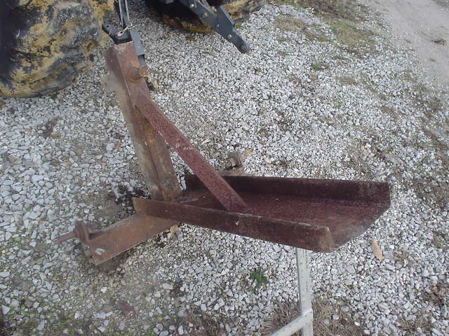

Closer view

This last shot shows a little damage if you look closely. It had been used on a Ford 1920 4WD - only around 30 HP, but still managed to bend the cutting lip and right lower link pin.
I think a nice piece of sharpened angle iron would have been better since once the penetration is done, the roots are broken by lifting rather than cutting.
If you want to use the fel for this, one thing that might be interesting is to weld up a frame to hold your angle iron that REPLACES the bucket. Visibility would improve and since lift force may be important, you could use your curl cylinders to pry the tree out.
Picture the attachment from the side of the tractor. Its "L" shaped with the horizontal leg being the sharpened angle iron. The vertical leg would be part of the frame and longer for leverage. Connect the pins on the fel arms near the L's junction. Connect the curl cylinders to the top of the vertical leg. For really stubborn trees, if the heel of the L was supported by the ground, you would have tremendous leaverage when curling the attachment.
Sorry to get so windy about a rusting piece of metal but it was a lot of fun to use. Hope you get around to it.
John

I used that wide channel because I thought that cutting the roots were important. It turned out, on those thorn trees at least, that to cut ALL the roots you would have to work your way around the tree, backing in 3 or 4 times from different directions. 'Slow and leaves the ground all around pretty much trampled. What worked and was more fun is to slide the channel under the tree, lift until the hydraulics max, then continue to back up. At least half the roots are ripped up or broken rather than being cut. Sharpening the end not only cut the roots but helped penetration.
With that lesson in mind, to make one again, I'd try maybe a 6x6x3/8 angle iron instead of that channel. (V up) It would probably be strong enough in the vertical direction with proper reinforcement, penetrate better, and concentrate lifting force on the tree instead of dirt.
To make it, rather than cutting the angle iron off perpendicular, I'd tilt the cut 45 degrees to form a point where the two "legs" meet. Besides sharpening the end, I'd sharpen the two sides along the length of the angle iron for a foot or so.
Also, if you have a hydraulic top link thats big enough, it would increase you lifting power. I didn't at the time and haven't tried it on this new tractor.
