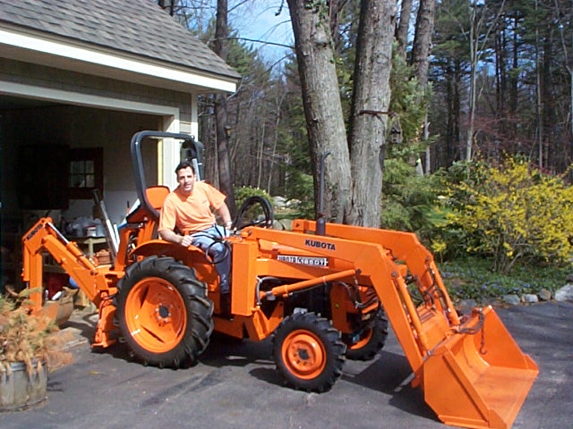

Sounds like you got a fine deal on a barely used tractor. Regarding the filter in the line, since mine had a front Hyd pump and BH it had the screen filter and an in line filter on the return side into the tank mounted on the loader frame.
I attached a photo - the tank is on the loader column. I would not think another filter is necessary since this could cause the pump to cavitate and run hot..
I used hydraulic fluid from a local auto parts store, and had no problems.
Regarding the slopes and run away tractors with the 2WD and turfs this can make for an esp fun ride when the grass is wet. You might want to load the rear tires to if not done already. But before you do that I think to replace the inner tubes since the rims for these tractors are hard to find and pricey. (Mine had the rear rims rotted through so had to patch and weld)..
