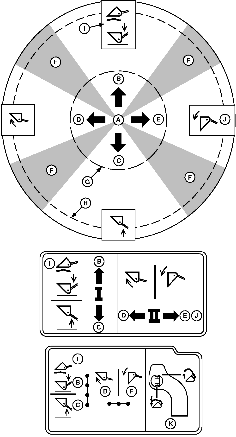

Funny post. It's infinitely variable: see attached pic. The gray areas are the dual function zones. You might want to download and read through the 5X25 Operator's Manual. As you read it, you'll get familiar with the machine, learn what some options allow you do, and more importantly what not having some options prevents you from doing. Here's a link.

Thanks for the link. I'll study up on the tractor today.
I figured the FEL operated in the same manner as the M6800, but it didn't appear that way in the field. Of course, there is a world of difference in the way an open station Kubota and a cab JD mount their respective joysticks. Muscle memory has me using the joystick as if I were on the open station M6800, not a JD. My seating position respective to the joystick probably had me doing the + pattern as opposed to the X pattern.
Things felt 'different.' I also didn't experiment too much with Roland's tractor. Even though he trusted me to look at his tractor while he wasn't home, I didn't trust myself to not do something stupid. :D I kept the test drive very, very minimal. It covered a total of about 50 ft. :)
Thanks for all the help guys. Ya'll just confirmed I'm idiot... something my wife has been telling me for years.
