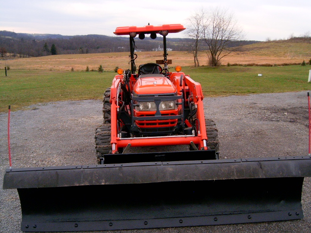

So I have a DK45HST Cab with the loader and backhoe, this will be my first winter with the tractor.
Of course I would like to have all the implements, but that's going to have to happen a little at a time.
Should I get a FEL Mounted Plow or Back Blade? I am plumbed on the loader cross member with the third function valve.
The only drawback I can see with the FEL plow is having to switch back to the bucket for scooping/moving piles.
And what about when the plow comes through and leaves a 3 foot deep 8 feet wide mess in front of my driveways that I might not be able to get to the same day, and it freezes, is the FEL plow going to move it or trip the springs? Will I be switching back to the bucket often?
As far as a FEL plow I was looking at these W.R. Long Front Blade Hydraulic Angle For Tractors and Subcompact Tractors up to 50HP I can't spend 3 or four grand on one.
So what do you think, Back blade (cheaper) or FEL Plow?
Thanks

That's What I did.
Found an old truck plow. (a 9' Western truck plow).
Welded on a skid steer QA. Total cost was a little over $500.
Works great and has power angle.
