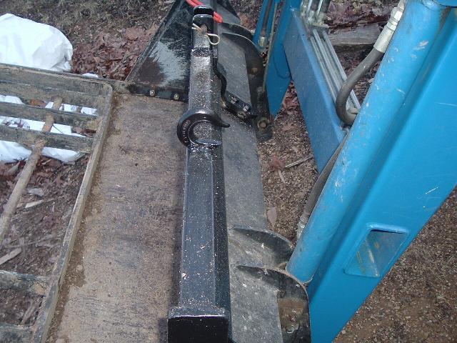

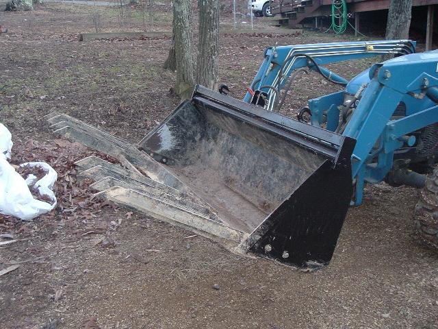

Made this up yesterday from an old forklift back frame. I needed to make something to raise logs up so I don't have to bend down to buck them and wanted more support than the set of clamp on forks I made. May need some more work, after I test it.

Blueone -- Thanks -- I like the idea but my chainsaw always seems to find any metal or rocks within a half mile of the blade:eek::eek: You now have me thinking about a wood version that would fasten onto the bucket and act as a sawbuck:confused:
   / FEL Log bucking attachment #5
So, do you have the spacing right that you will saw down between the spikes on the bucket? I don't like the risk of hitting steel with my chain saw. :(
I find that picking up a log to buck (only have forks), that it becomes imbalanced and I have to run back and forth sawing ends off to keep it balanced. One thought I had to correct this, was add a hold-down finger in the center to hold the log tight to the bucket.

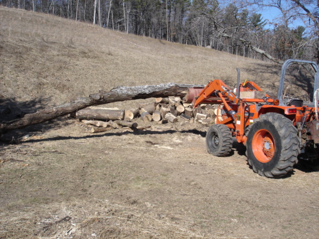

I've got a set of stone forks and sometimes use them in a similar way. Another trick I use is to hook a set of skidding tongs to the bucket with a chain and pick the logs up with that. With a little practice you can drive up to the log and pick it up without getting off the tractor.

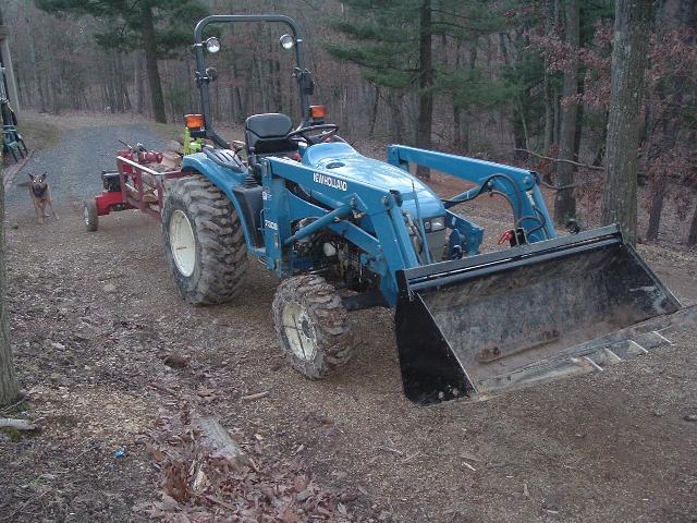

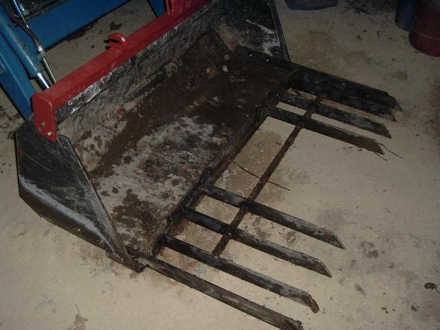

I tested this out and it works better than I expected as I can buck up a log 10-20' long and not keep running back and forth, it stays put. As for the spacing it works fine for me as long as your not so picky to give or take an inch or 2-3. As the metal goes you just have to keep your mind with what your doing. I cut up 3/4 of a cord and had no saw trouble.

Great. I hear you saying you can pick up a 20' log, buck one end at a time, and not run back and forth. Hmmm? A pic of that would be good. :D This is where a top finger (or thumb) or two dropped down on the log would be real handy.
I would like to see some pics of logs on the FEL. :)

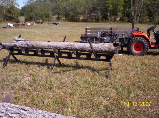

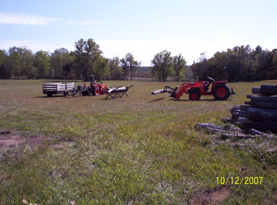

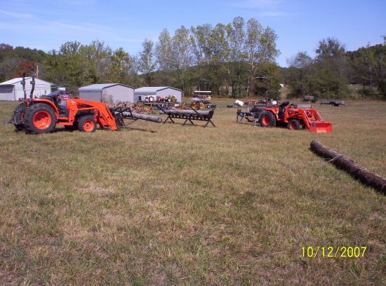

This my log bucker and the set up, when I have someone running the splitter.
